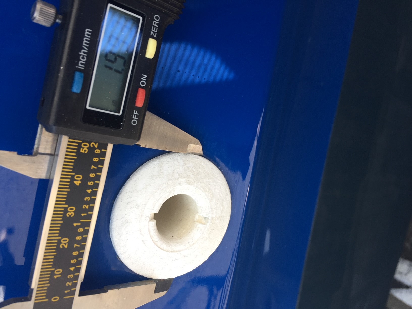

Image attached. The UV damage is obvious. The question is whether it's just surface or structural. The Forespar rep confirmed it's theirs and said the damage is superficial and recommended I lightly sand and paint it with 2-part to make it look nicer.
I have thru hulls that look like that. Nothing I can see shows that they are Marelon. If they did I would feel more comfortable that they were more UV resistant than regular "plastic/nylon" fittings .
I don’t see any markings on the thru hull. How do you know it is Forespar Marelon? I too have similar thru hulls on my 1988 O’Day 322. I am also considering replacing mine as they are 30 years old (unless a PO has changed them).
Greg
I sent pictures to Forespar and they said it’s theirs. If you send your pictures, make sure you also show one looking inside. The rep wrote to me that the shot I sent showing the internal bore helped him confirm.
