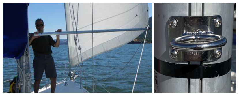

Could someone send me a picture of how they have their whisker pole set up. My pole is a forspar with a spike on one end. Thx much. Willem

Attach it to a pad eye mounted on the font of the mast (see photo on right) at jib clew height to attach whisker pole and the outboard end to rhe jib sheet (with the sheet allowed to run freely through the outboard end). To see photos on how it is mounted do an internet search on "mounted whisker pole images" and you find plenty of examples like this the one on the left. Post a photo of your whisker pole mounting on the mast and jibsheet.

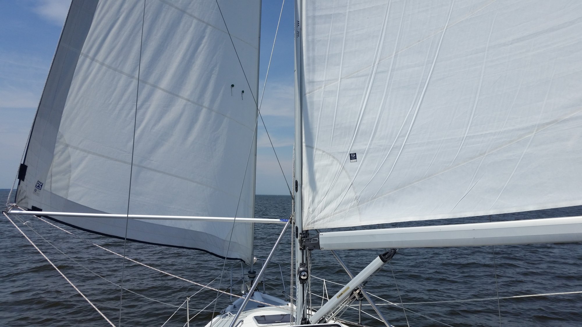

Have a forespar whisker pole that inner jaw is on a mast ring, hangs from Spinnaker halyard, run the jib sheet through the outer jaw and have a fore guy line set up to control aft movement. Can furl the jib if wind comes up to much or if you want to stop polling out.
