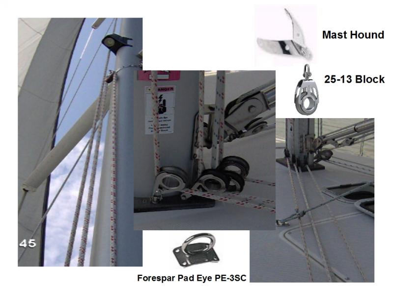

Late in reading my email. A pole to be the most efficient should have both a topping lift and downhaul. If it is on a genoa clew, then you can control the leach. also I have used it on reaching conditions with then pole and boom on the same side. You would need to have an outside sheet as well as an inside sheet. The inside sheet pulls the pole back, the outside sheet and the windward sheet an then move the clew along the pole until the slot is perfect. you'll have extra pole sticking out but the slot will be more efficient. I have used this configuration on many of my boats and have won quite a few races with it.

For many boats it is recommended you use a topping lift and not a halyard as they are not designed to handle to side load on the sheave. I built my own spinnaker pole when I happened on a clearance one day on pole ends at West Marine and the price was great to pass up. I did get the forespar chocks that mount the pole on the stanchions and they are great as they keep the side deck clear, hold the pole secure, and have no holes in the deck.
Also, most of the boat in my marina with whisker poles have them mounted to the front of the mast. That is a pretty good set up.

The main reason for topping lift and foreguy is to stabilize the pole. That way a puff will not be wasted shaping the genoa but propelling the boat. When hit by a puff or sailing in seas, the genoa will first tend to rise, eventually spilling air of the top as the leach rotates forward up top. That is a loss of power.
