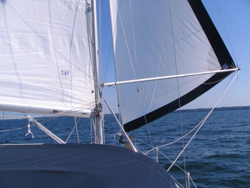

I found a used Forespar line control like the ones in the link for my H340 with working jib. I didn't have a genoa on that boat. I believe it was the 10-18 ft unit. I could furl the headsail with the pole at full extension, though some sail was still exposed. But I could wind it up if needed, with the pole on the sheet. The foot on the working jib is only about 15 ft, by the way, and the J-dimension is 11.5 ft.
I stored it on lifeline stantion mounts, with a small safety line in each jaw to the stantions, in case it tried to get away.
I used the spinnaker halyard to hold it up in light air, as in the pic below.
