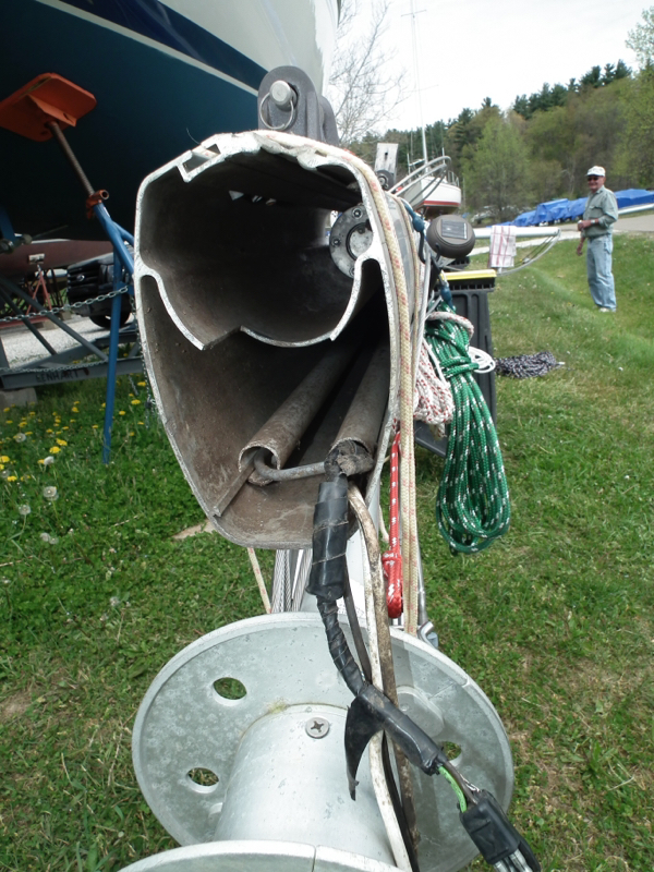

Here is a picture of the inside of my 2001 roller furling mast made by Charleston Spars. You can see the two PVC tubes going up the front of the mast with room to drill between yo add a track. Hope it helps.

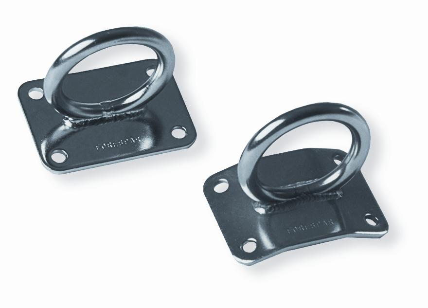

forspar mast padeye
mount it at level of clew so pole is parallel when downwind.

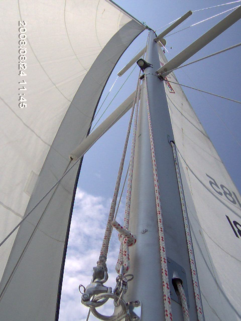

My Set Up
I went with a ring as I could never get a clear answer from Catalina or Charleston Spar about what was behind the mast where the rivets were on the front of the mast.
Here is a picture of my set up. I added a topping lift for the pole (always hook that on first then then take the pole off of the stanchion chocks) above with a mast hound and a garhauer block.
I used the curved forespar ring as it bridged where the rivets in the front of the mast were (I have the traditional sail). Very happy with the set up.

I do have the standard 130% genoa. The ring is about 5'6" off the deck or about eye level so I can see what I am doing. :D

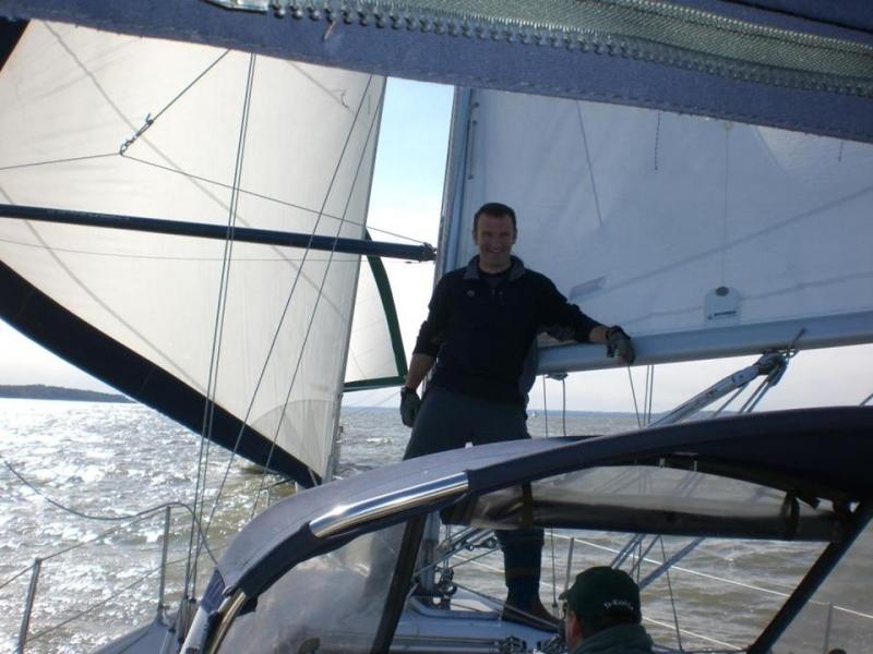

Here is a picture of the pole in action. The guy in the picture is Tony Lancashire, who with another Royal Marine named Kevin sailed a 17' Nordic across the Northwest Passage a couple of years ago.
It is the Forespar ring pictured above that is curved.

justsomeguy you are spot on. We were spanking the fleet in the photo. That was the original Genoa that came with the boat, and when it blew out on the leech the year before last I had Quantum make me a new one pretty much the same.
I got really lucky with the ring height as the best advice I got was to put it about eye level so you had a clear view when putting it on. It has worked very well for both poling the genoa out as well as the spinnaker.
Here is the pole in action with the spinnaker. Please note we were spanking our way through the non-spinnaker fleet and the wife (who made me buy the boat :D) is standing at the mast working the sheet. That was a great day. :dance:
