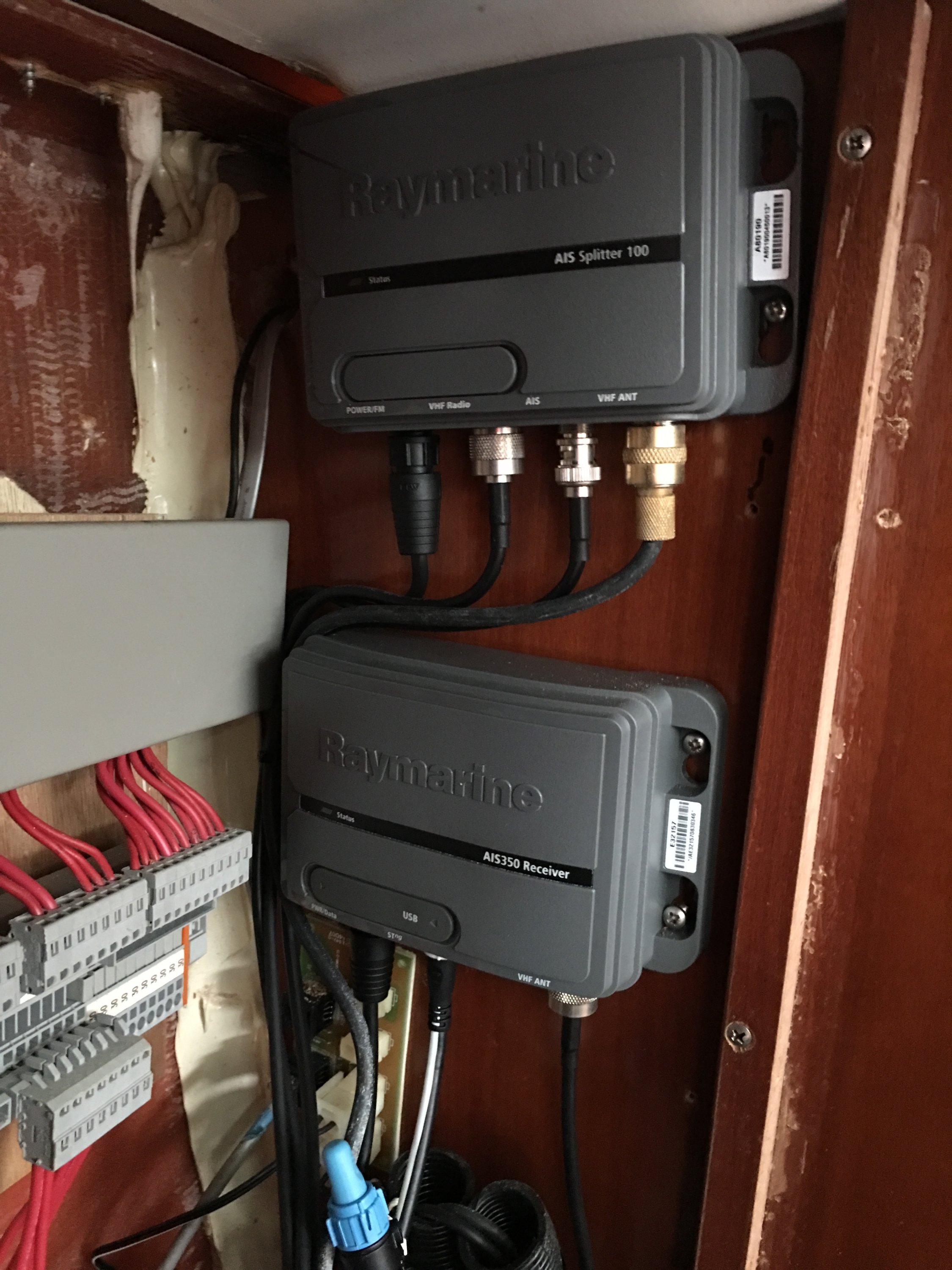

Yesterday while trying to track down an electrical issue, which seems to be a missing prong on a shore power receptacle that will be replaced later this week, I found these things behind the main electrical switches on the nav station.
Is this a good thing?

No no no!!! Those are horrible things!!! Take them out and mail them to me immediately for proper recycling!!! You owe it to your country and the environment.
Sure thing, I'll get right on that.
But what do they do?

Splitter shares your FM radio antenna and the AIS Receiver is the newest ship Identifier on your Raymarine Plotter.

No... no... don't send them to the frog. Send them to me. And the hardware connected that is on the outside of the boat. Wait, just send me the boat. We'll call it even.
By the way, nice windfall!

Thanks Jim. Does this send my location to other boats too?

I don't know that specific model for sure, but the reciever probably is just that. A tranciever would be two-way.
When the devices are turned on if your chartplotter is properly configured you should see icons indicating where other ships are, particularly commercial ships that are required to broadcast AIS. They won't see you in the same way though.

the 350 is receive only - it has NMEA 183 and Seatalkng output. It does not transmit anything.

The splitter shares the AIS data reception with the VHF antenna, not FM.

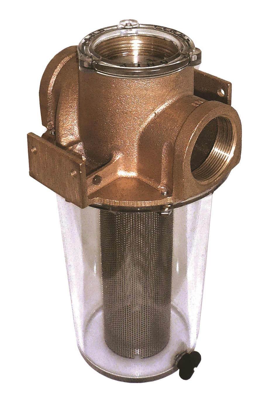

  1. No water flow through the heat exchanger means no water cooling the engine (think car radiator only water instead of air).
    1. The Water Thru Hull not open.
    2. Or something is blocking the water line
      1. Intake strainer blocked
      2. Raw Water strainer is clogged.
        ARG Series Raw Water Strainer
        THE CONCEPT
        For installation on the suction side of engines and pumps, GROCO ARG Series raw water strainers are the ideal filtration solution for cooling water intakes for any marine engine, ac unit, or genset.
      3. Hose blocked by piece of impeller
    3. Impeller damaged not pumping water.
  2. No engine coolant (must be leaking out of system) to take the heat from the engine to the heat exchanger (think antifreeze on the ground not in the car engine).
You should also see an oil pressure gauge. When you start the engine it should sound. When the engine is running it should stop. When the oil pressure drops to danger level it should sound again. STOP engine and check the oil level. Replace as needed.
        THE CONCEPT
You should check the oil level every time before your start the engine each day.
Like Goldilocks your engine wants... Never too much. Never to little. Always just right.
