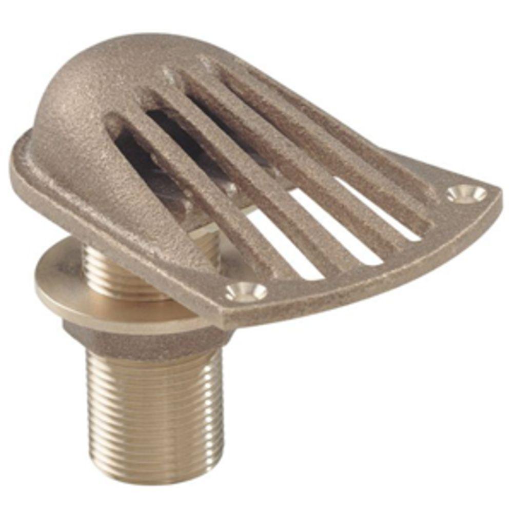

1984 Morgan 323. Yanmar 3GMD 20 HP. OK, the question:
Which intake strainer is best? A 2-piece thru-hull replacing existing thru-hull? A cover-type that simply screws over existing thru-hull? How about the "Glass Reinforced Non-corrosive Marelon" that can be glassed in place on the outside of the hull? See pics. Let the opinions fly!

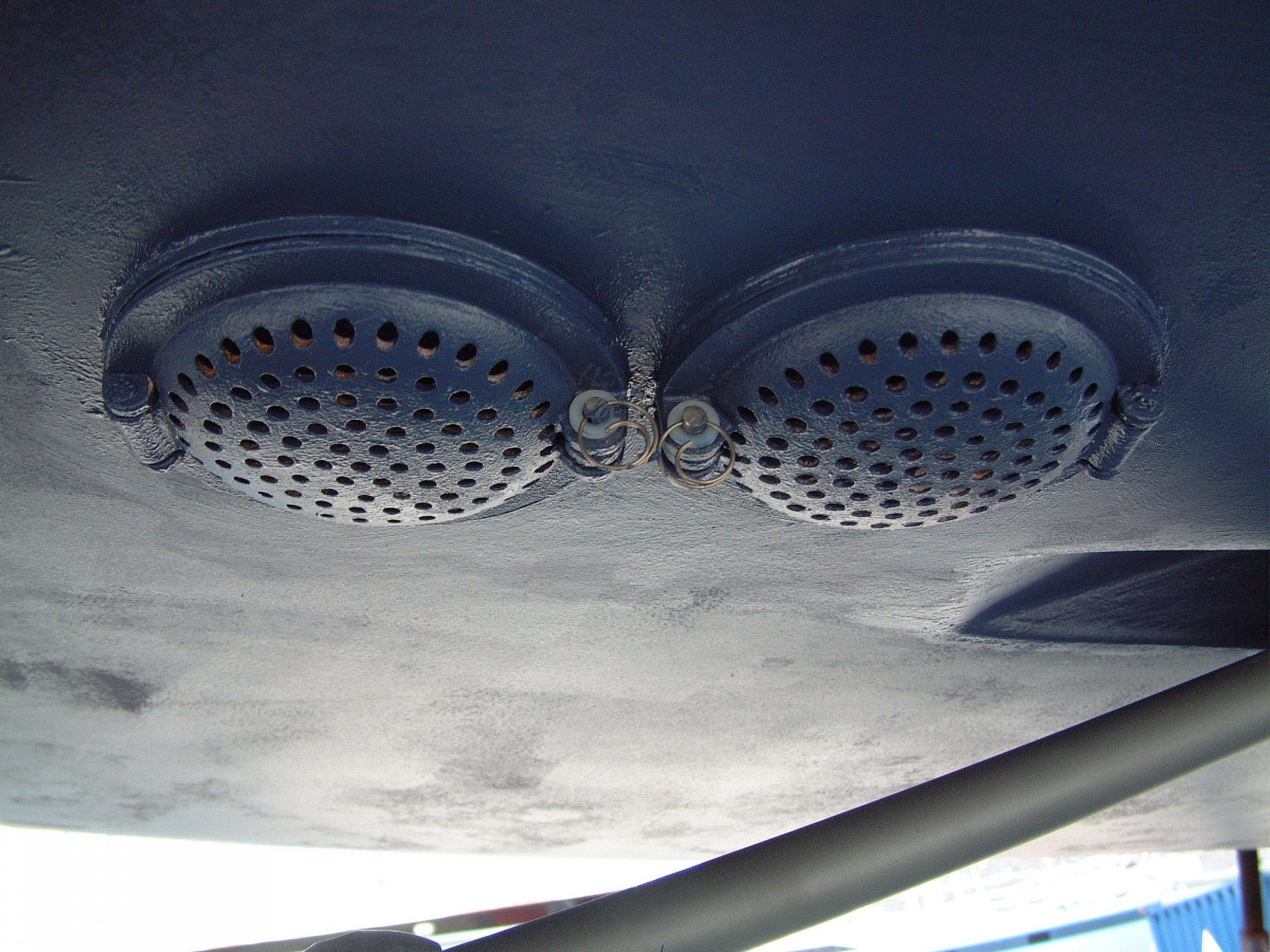

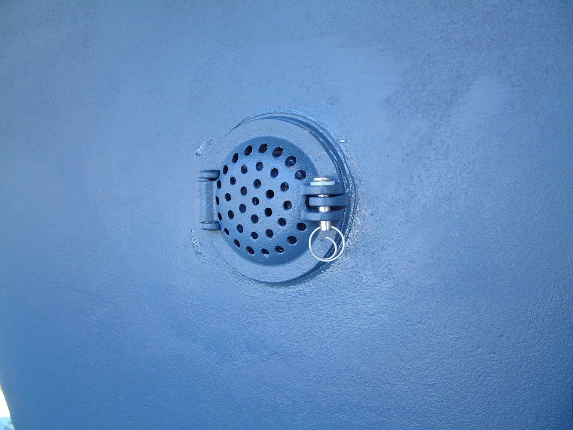

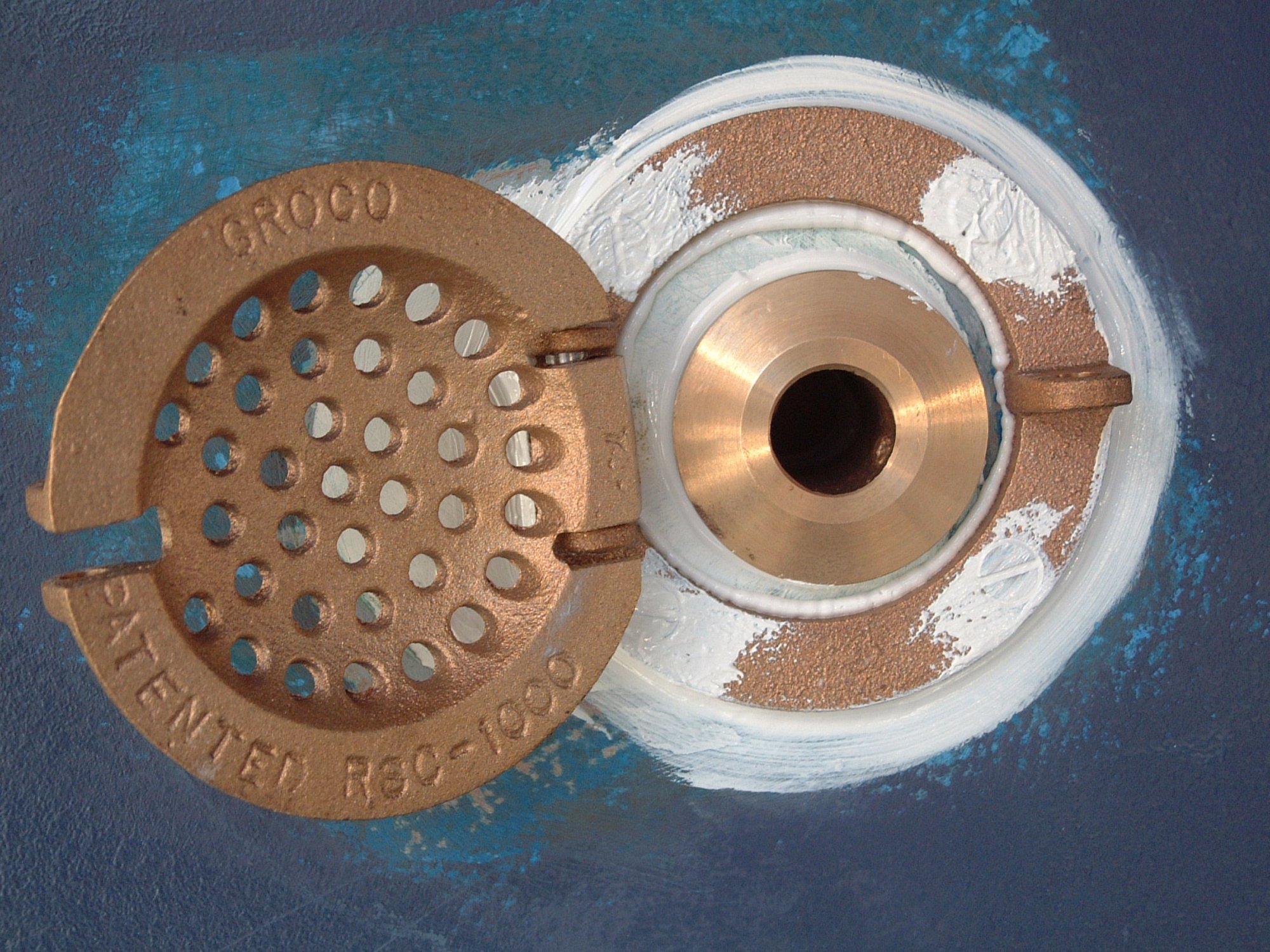

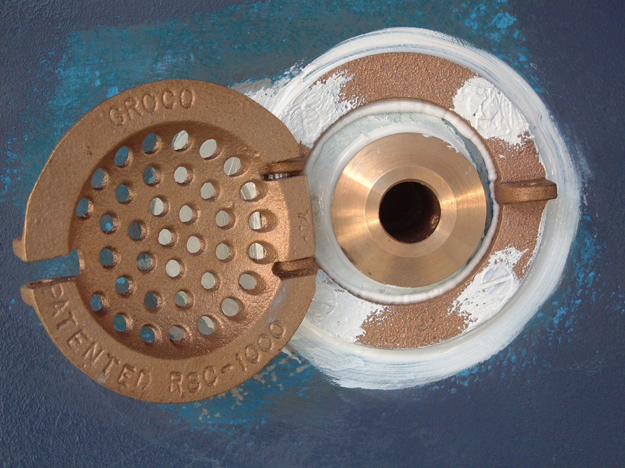

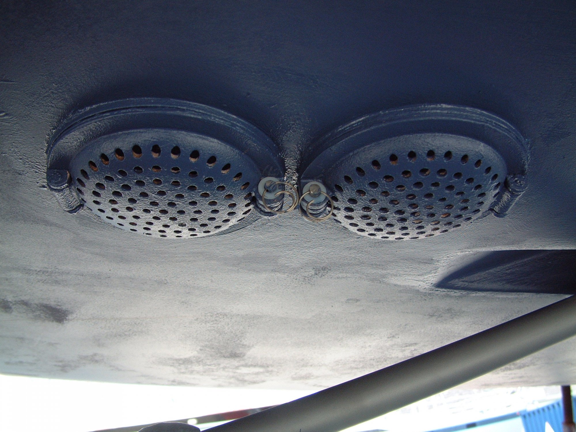

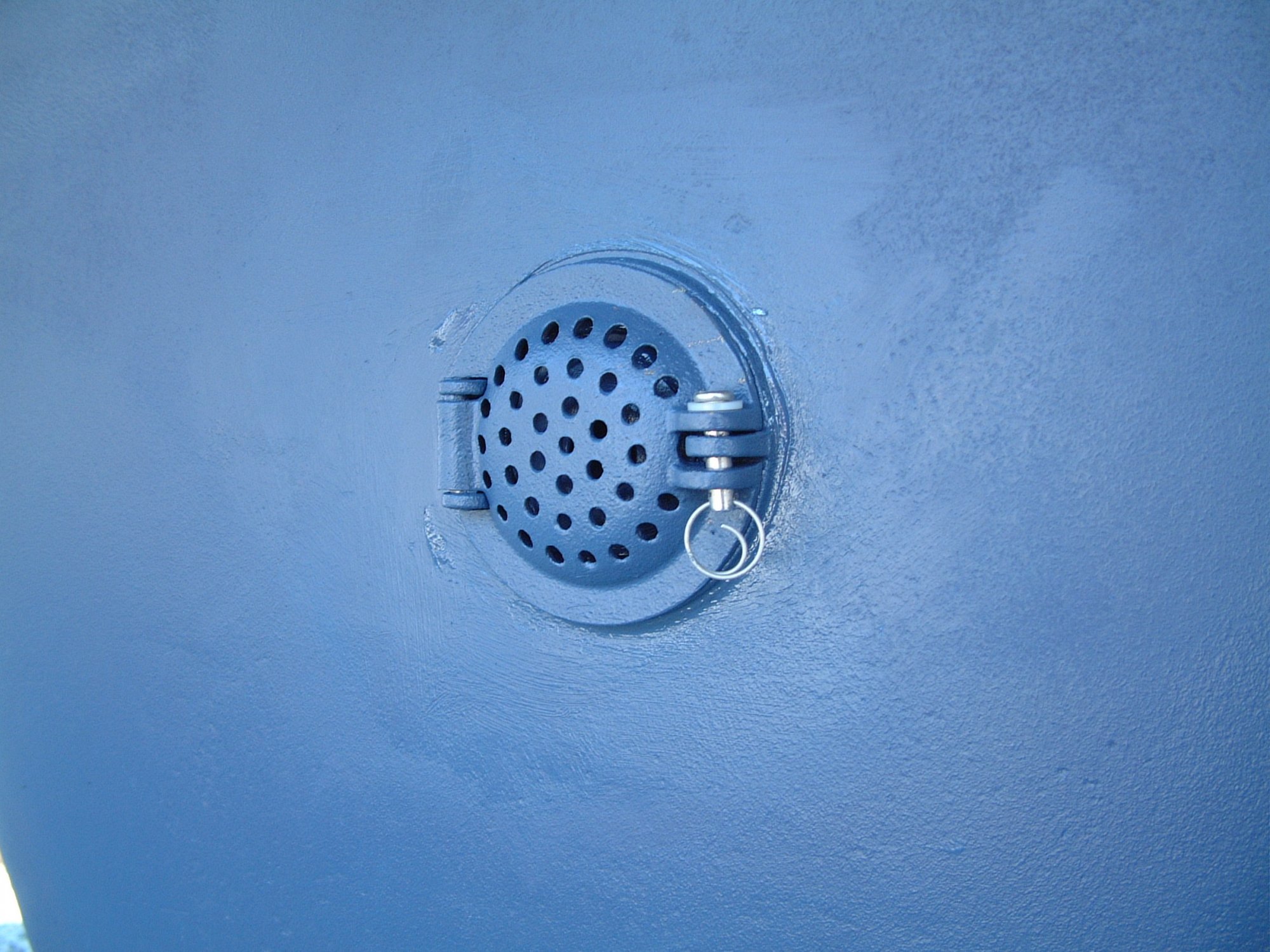

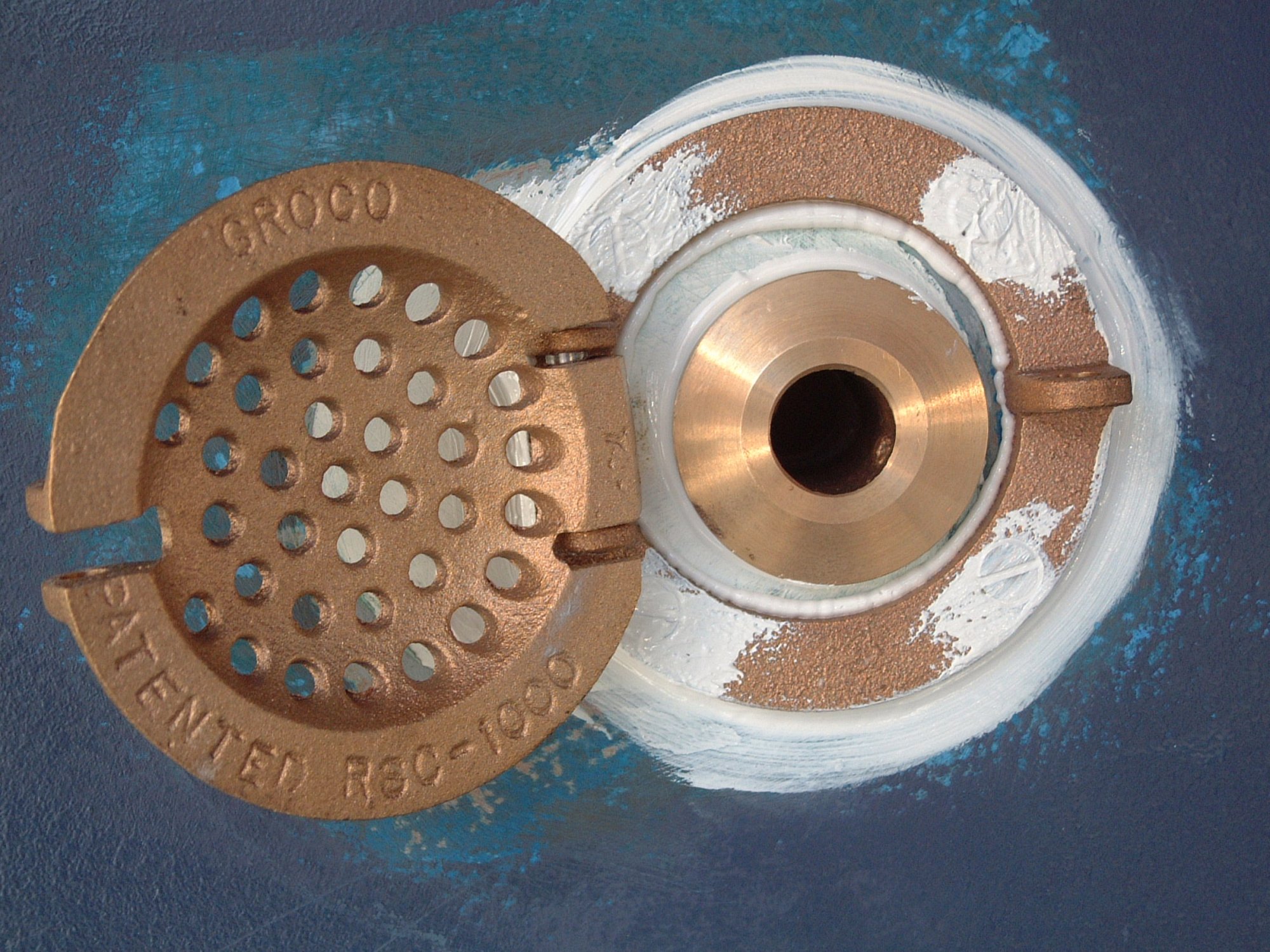

Some people hate external strainers. I have a different opinion.
My OEM setup was a one piece strainer/thru-hull like in post # 1 above. I also had a couple other intake thru-hulls with no external strainer. After fighting with frequent clogs in all of the internal strainers, I replaced the one-piece strainer/thru-hull with a standard mushroom thru-hull. And I installed external strainers made by Groco pictured below. Since making that change, I get almost no debrix in my internal strainers. Like maybe one or two strands of grass in just one of the three intake strainers each year. In the Spring they are easy to clean out too. I'm sold.
Oct 1, 2007
1,865
View attachment 186849View attachment 186850View attachment 186851
Beautiful fittings. I too have strainers on my inlets and have never had any problems.

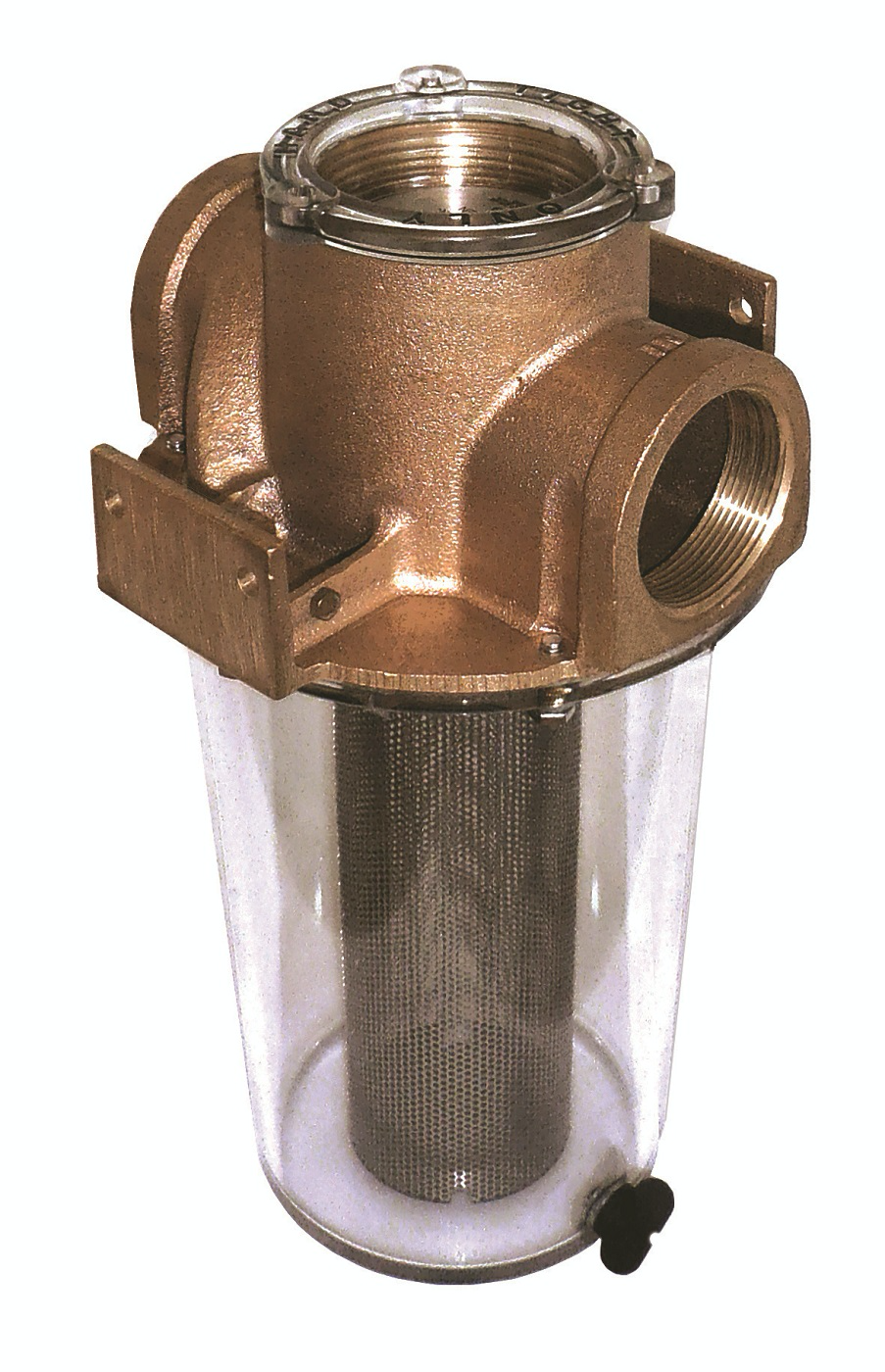

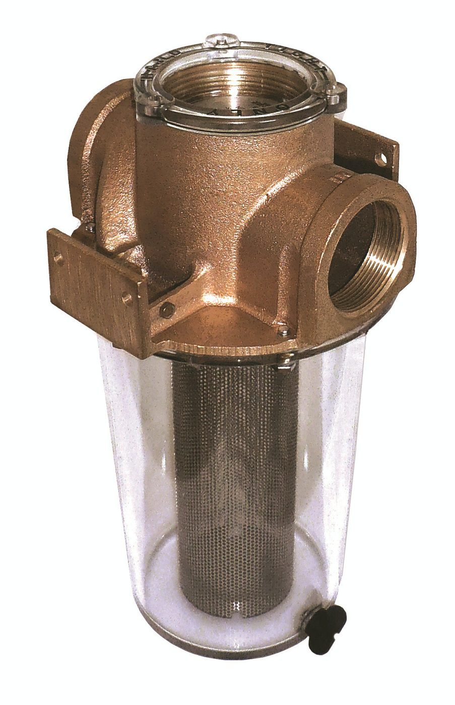

@Ziggler I bought an inline strainer and placed it inside the boat.
One like this.
The ARG 750 series.
I have been using it for 2 years and am very happy while sailing the Puget Sound. My boat is in the water year round. I drain the glass during winter and I keep some heat in the engine space. I have a note to refill the glass before I start the engine. I have had the similar plastic strainers, but the plastic tends to craze after a couple of years.
