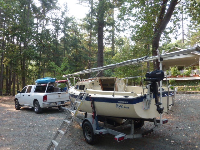

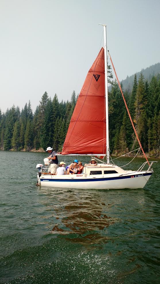

I think your dreaming the impossible dream, as many sailors do.
we've been through quite a few small boats, given the relative few years we've been sailing, but by FAR the best compromise small boat so far has been our Vagabond 17. small, but it feels like a much larger boat when sailing. only 950lb displacement, seated headroom in cabin, sink, porta pot area, very respectable performance for it's size, 350lb swing keel for stability, and a kick up rudder. initial stability is hard to come by in a small boat, which is why I've had a hard time finding one my wife tolerates, but the V17 is great, and she enjoys it, so life is good. The V17 also sails very well on main alone, if desired. plus it sails well with keel up when your in shallow waters (like Fern ridge ;) ). has a decent size v-berth and two 1/4 berths, so sleeping 3-4 in the cabin is possible for close friends ;) .
That being said, we also have, and love, our Mac25 (2100b displacement) that's our go-to boat for overnighters. we keep the V17 for day trips because it sets up super fast etc. (20 min), which is actually the main reason we have two boats to begin with ;) .
decent sailing days are few and far between in the winter months around here, but if you're ever down south (Grants Pass) you're welcome to stop by and look ours over.
