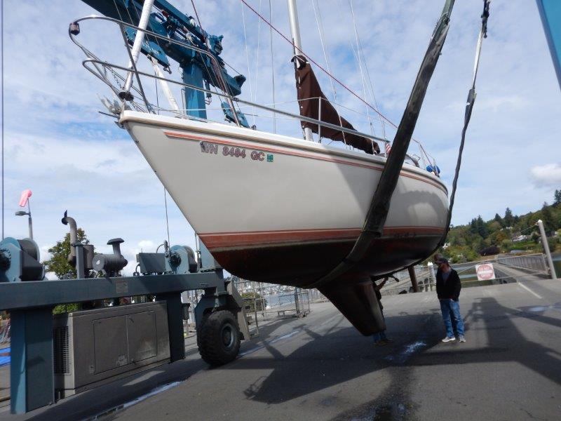

Just a update. I went with the Catalina 30 that was a family owned boat from 1985. The survey and oil samples came back clean and I close on the boat tomorrow morning. Can’t wait to get on the water. Thanks again for all your input. I look forward to learning from all of the wise salts on here. Thanks again.

Congratulations with your decision. Looking forward to seeing you out on the water.
Likes: Phlbald
7,752
A beauty for sure. You and your family will have a blast.
You are in a great area too. A number of SBO members are very familiar with the PNW.
-Will (Dragonfly)
Likes: Phlbald

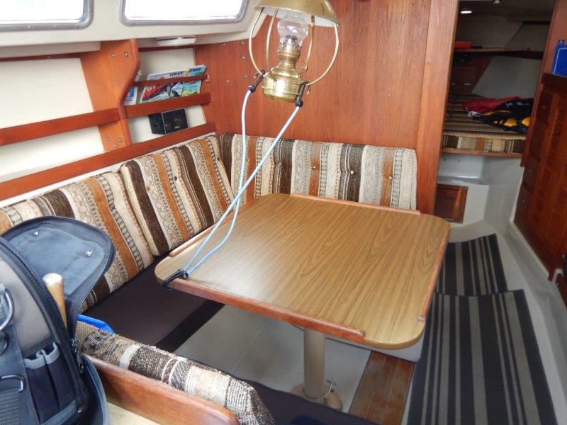

Love the U shaped dinette. That was one of the pluses for the C30 we bought.
Hope all goes well with the purchase.
Likes: Phlbald

Congrats on the new sailboat! So I have a question for all. My 1980 Cat 30 doesn't have a u-shaped dinette. It has the table that comes down from being attached to the wall. Is this something the previous owners did or are there different "floor plans." Just curious.
