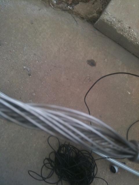

Something else to check is the pin size. on my H-30 the pins are 1/2 in on both ends.
If yours is 1/2 in also then i'd not recomennd using the 3/8 sizee pins in the furling units.
Good Luck, im installing a harken mk4 on mine this week end.
Also do you want to take a chance on having this in a few months? See photo attached.

I saw that on the installation guide. I am probably going to have to change something at the bow to make it all fit. There is no way I would put a 3/8" pin in a 1/2" hole. I will get the parts to make it right.
