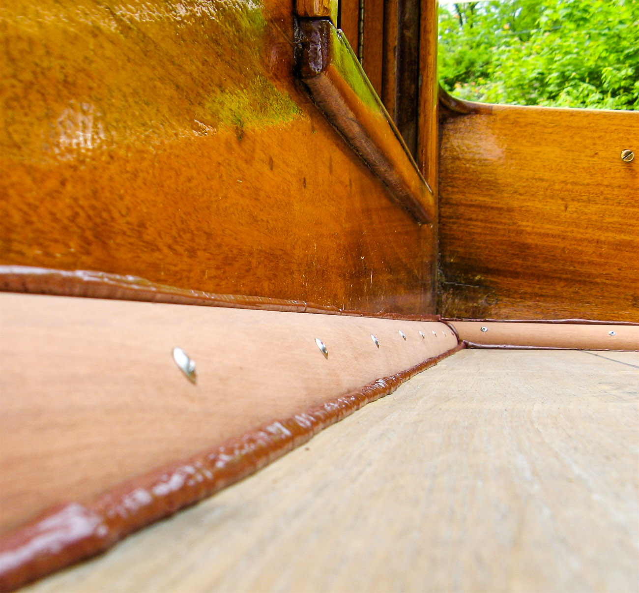

I'm not sure Boatlife would be the best choice, either. You're application is asking for a small filet like joint of sealer between sealed wood and fiberglass. I recommend the Mahogany Boatlife polysulfide because once cured, it takes varnish nicely. But polysulfide doesn't stick that well to surfaces that aren't prepped for it. That's why I find it a good sealant in the some applications, especially where wood is involved. When you have two mating surfaces, polysulfide has superior gap filling and flowing properties. I heard wooden boat builders refer to this as the 'splooge' factor.
The great thing is, once cured, the material doesn't adhere that well to the sealed wood. it's easy to remove as well as sand off the raw wood. Then varnish covers it all and the joint lasts a long long time (beyond when you'd have to 'wood' the pieces it's sealing.
You have a perfect rubber like gasket between the pieces that seals out water very well. It's not a great adhesive though except to raw wood.
You may be better with a polyurethane type sealant (Sika) due to it's higher adhesion? Either way, taping off for a filet, it should blend in with the toerail and disappear. But it has to be a good seal, and stay there. Tough one!
