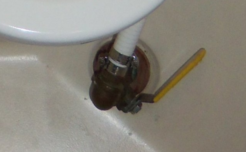

Looks like a thru-hull to me. Can't tell from the photo what size it is. If the hose is 3/4" ID, it's the flush water intake...if bigger, it's toilet discharge.

Is that a through-hull?
Yes, the original thru hull in the finest Hunter fashion. Same thing as in the last boat show I saw.
