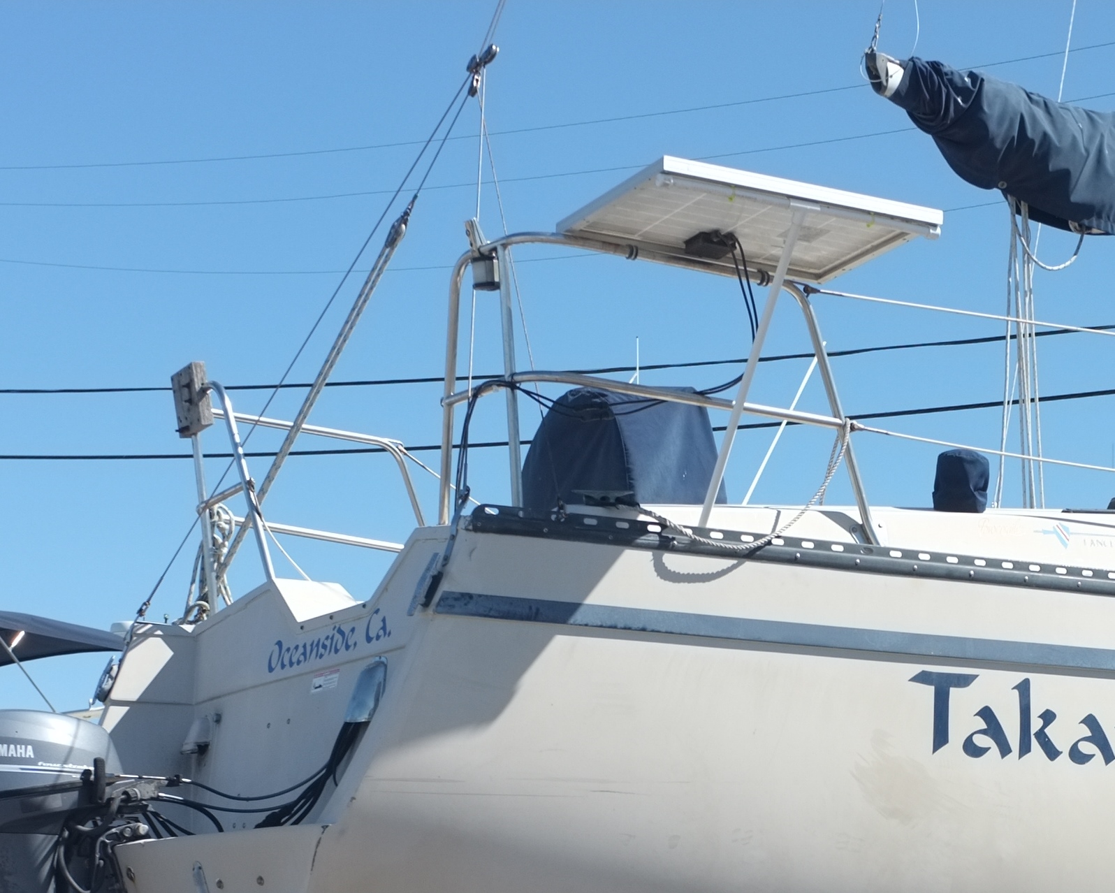

Hey,

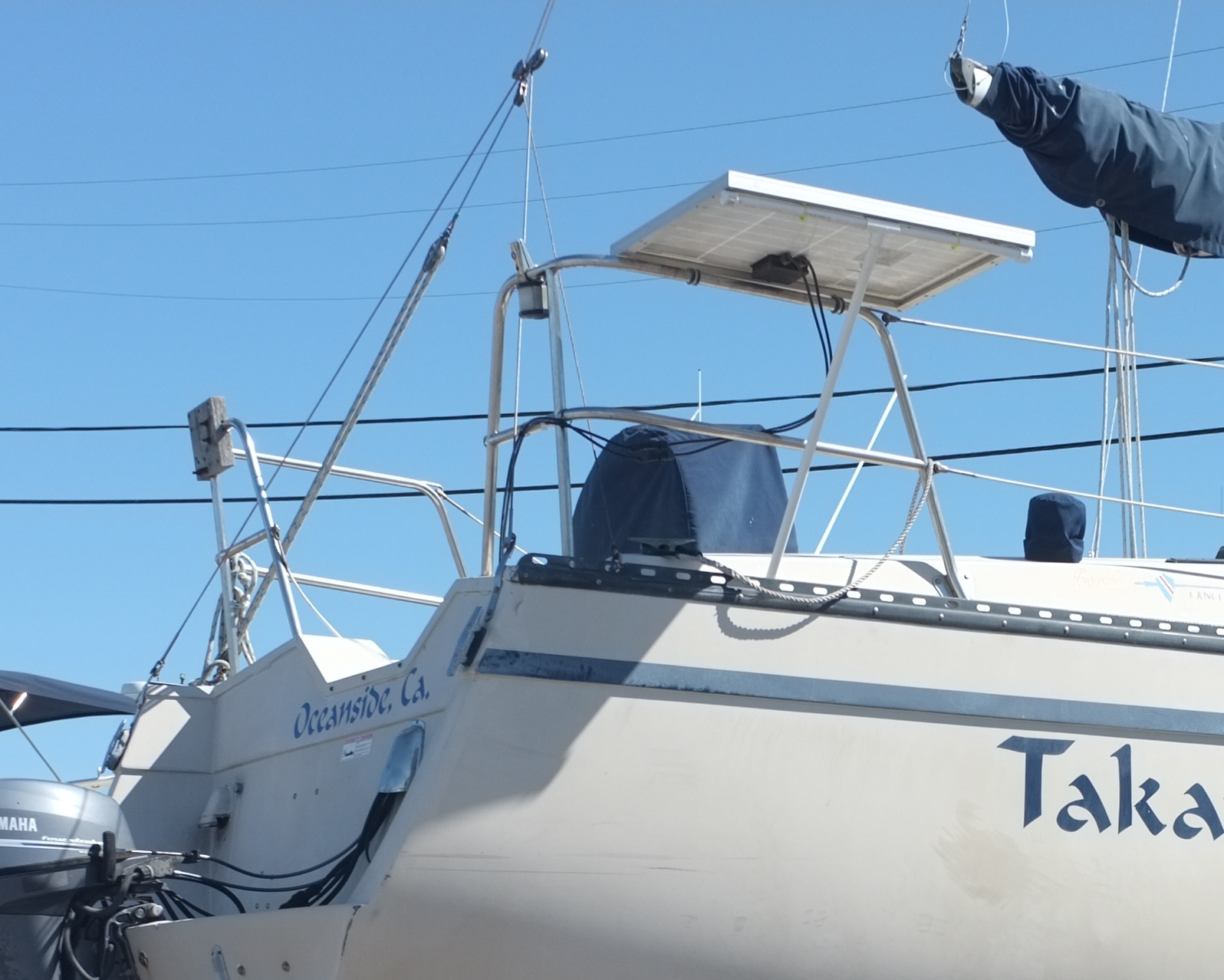

I'm buying a small outboard (~2.5hp) and I need a place to mount it while cruising. I've seen the Edson mounts but my stern pulpit only has a top rail and therefore isn't compatible. I've included a photo below (sorry for the odd photo, it's the only one I have.)

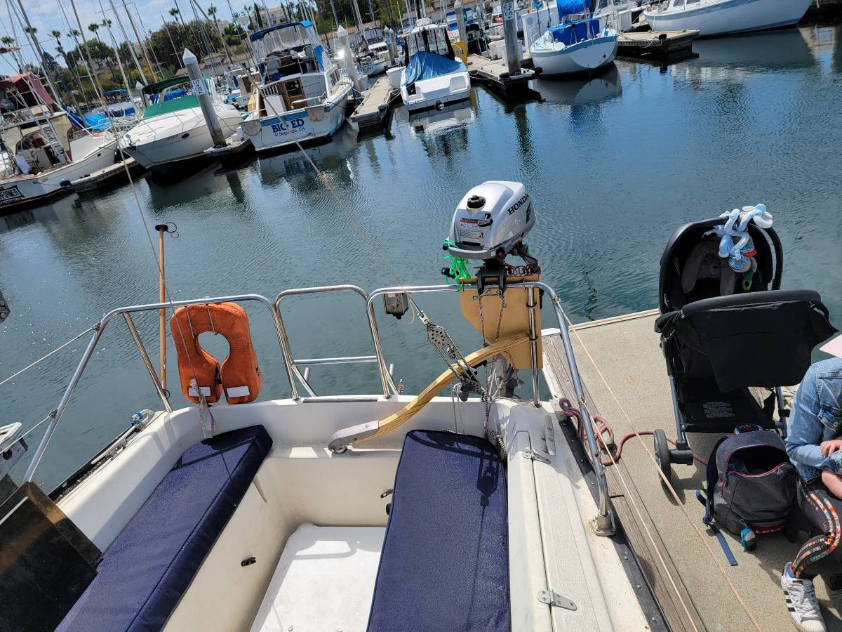

The Edson motor mounts are nice, but excessively expensive and won't work for you. If you don't want to make your own, as @Ralph Johnstone did, Sea-Dog makes one.

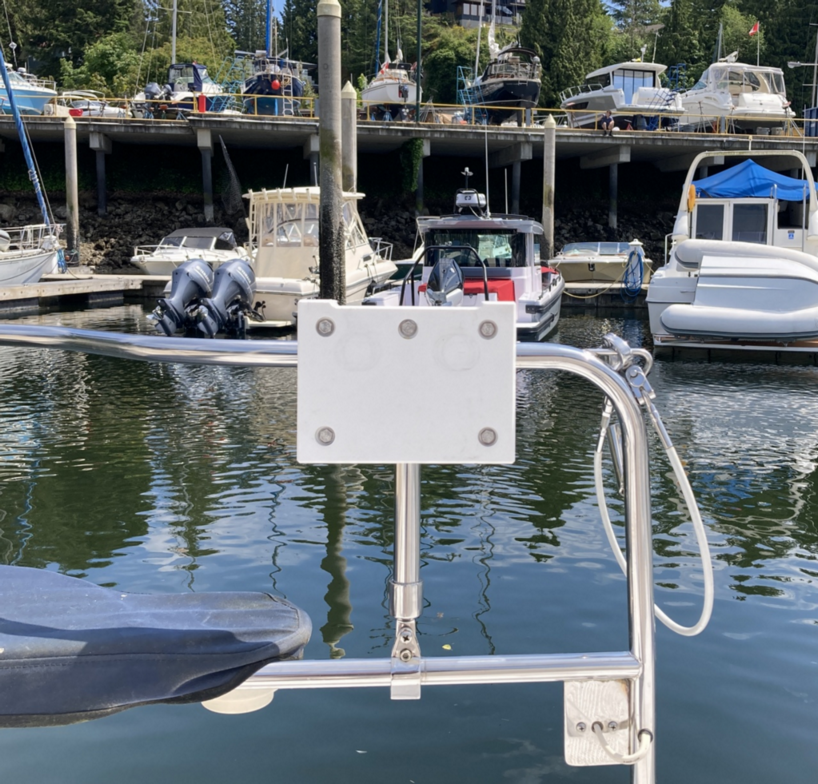

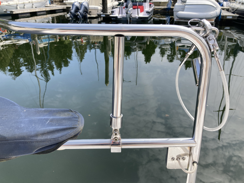

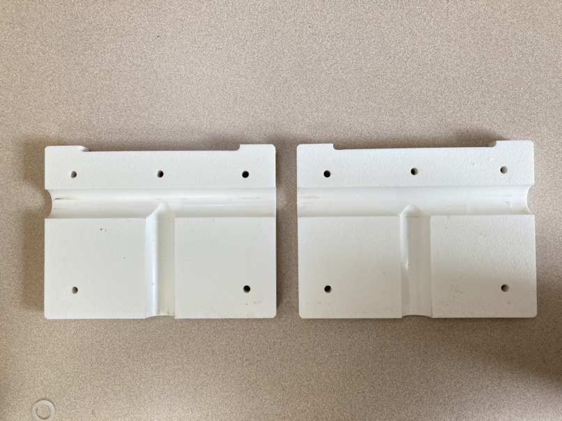

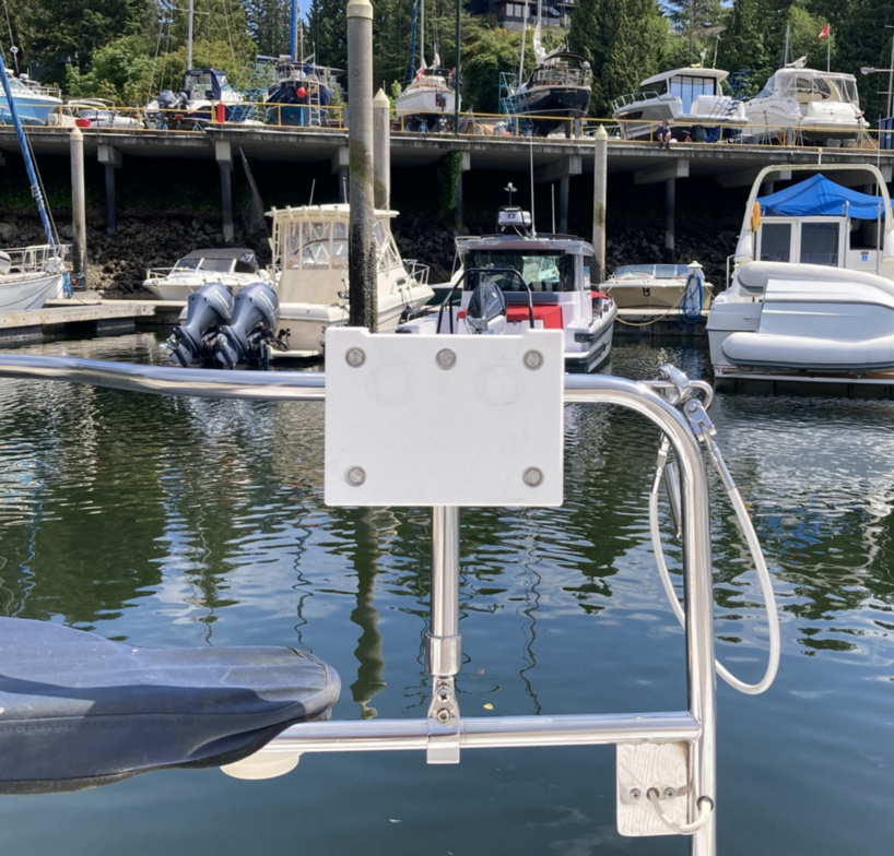

The problem I had was no mount would work on my stern rail. So, I built my own out of a couple pieces of ply. It holds my Suzuki 2.5 just fine. I use it on a Mercury 220 Rollup inflatable. The motor is quiet but still loud.

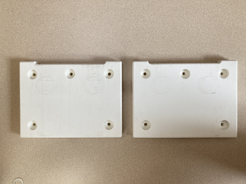

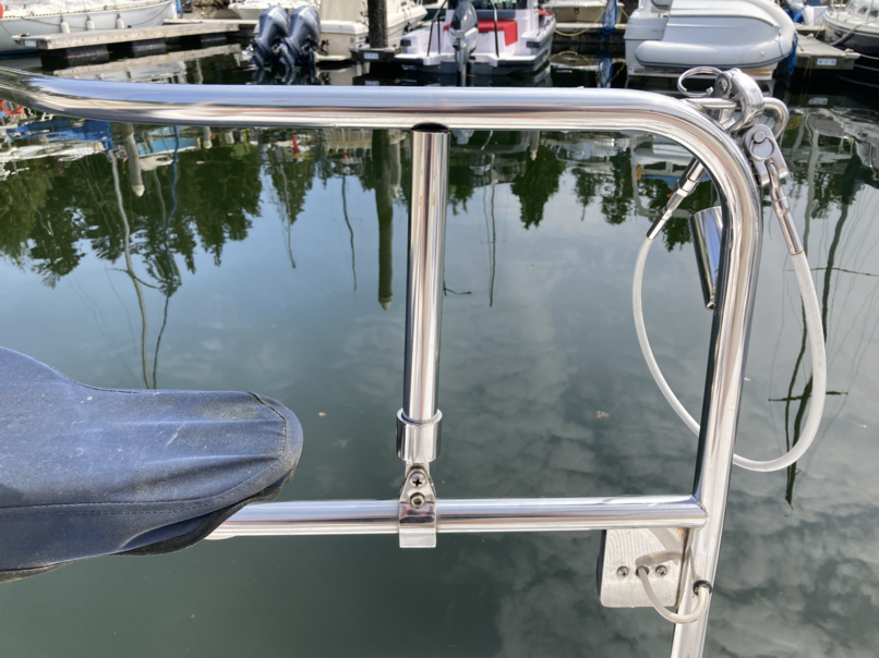

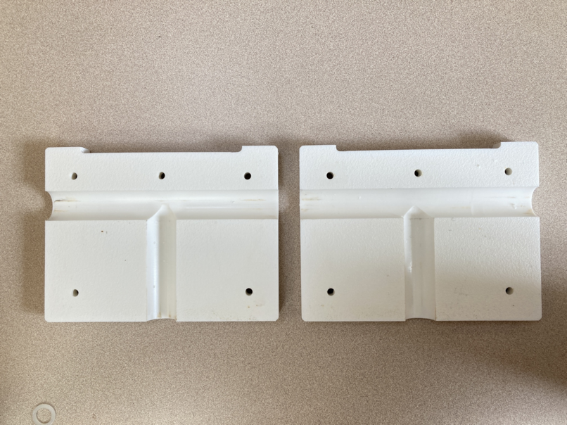

The problem I had was no mount would work on my stern rail. So, I built my own out of a couple pieces of ply. It holds my Suzuki 2.5 just fine. I use it on a Mercury 220 Rollup inflatable. The motor is quiet but still loud.View attachment 208633
Can you send a picture from the other side? That looks like it might work on my setup.

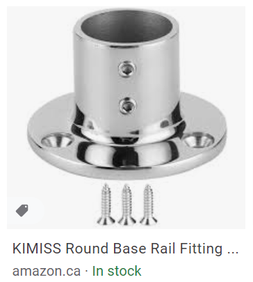

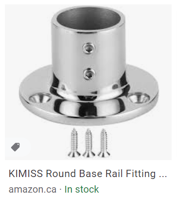

This goes on the bottom of the vertical tube for rock solid mounting on the gunwale at any weight. Couldn't find the base fitting without the fancy spring as shown below. The pin has a small ball retainer. I have four of these fittings to mount my dodger top the cabin top.

I see how this could work but I'd highly prefer not drilling anything into the hull.
Modify the size/shape of the rail mount in the picture you posted. Looks like a winner with no drilling! Does not need to be that exact shape nor that large.
Jan 4, 2006
7,425
Just three screws into the gunwale and sealed. Or two screws if you use the pinned base. Also, you've got too nice a boat for a:
Maybe for bass fishing in a slough, but not on a boat like yours :biggrin: .

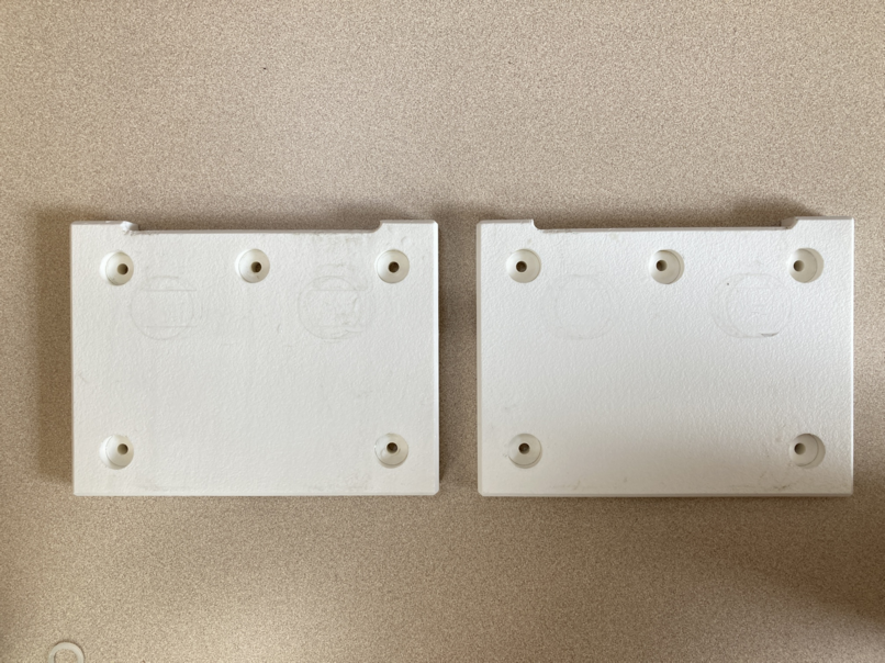

Not going to be at the boat for a couple of weeks. I also don't have an image from the cockpit. But I cut out channels to fit the vertical and horizontal part of the rail. Then used U-bolts to secure the block of wood to the rail.
