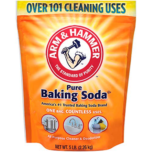

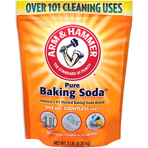

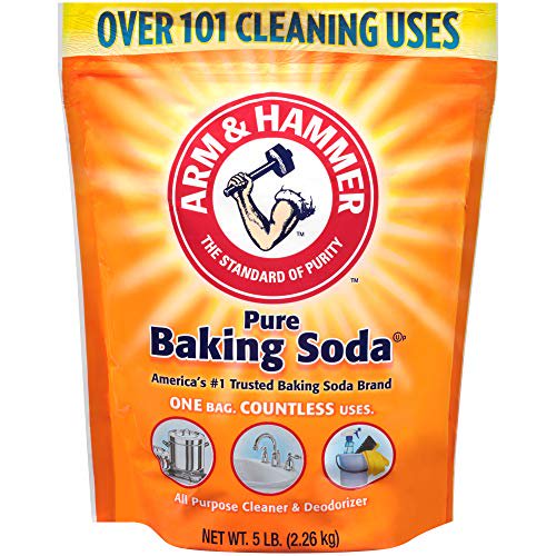

A cheap , per flush, neutralizer is...
Two Tablespoons [ coffee scoop] before the flush and watch the cleaning bubbles neutralize the Uric Acid.
Safer for Aluminum Hold tanks too.;)
We keep some and the scoop in a slider zip lock bag behind the toilet.
