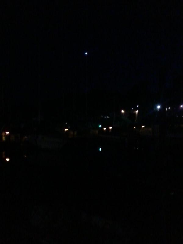

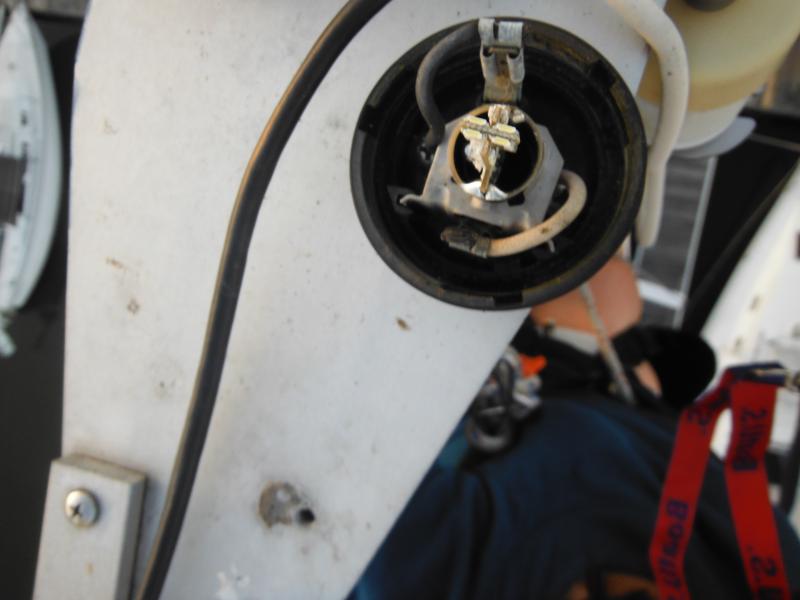

Really pleased with the new lights. With the bow, stern and anchor lights on my Victron registers no amps out of the battery. :dance: Below is a picture with the white light near the top center being my anchor light with the new bow light below it. The Admiral went up (had to buy her ice cream at McDonalds for payback ;)). She said the cover was a bayonet type screw on, like the bulb itself). The other pictures are of the marina as she wanted some for the yacht club calendar.
