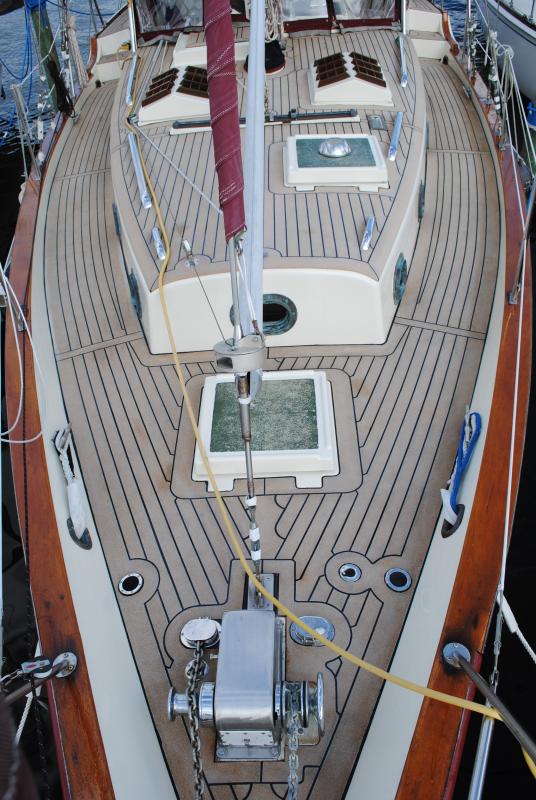

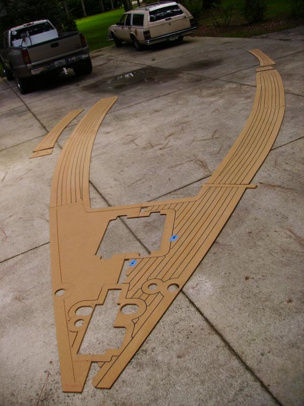

I have included a couple of pictures showing the sheets laid out. In the picture where the pieces are laid on the parking lot you can see the starboard side of the bow has not been cut with the lines. The picture with the deck dry fitted on the boat shows how the sheets come together.

The decking looks most interesting...

The sheets are no more than 4' wide and can be rolled up into a tube(s). When they are received the owner must lay the pieces out in the sun for a few hours to get them to flatten out. Oftentimes we use a very hard cardboard tube that is similar to the ones they use to form concrete pilings. These seem to survive shipping very well.

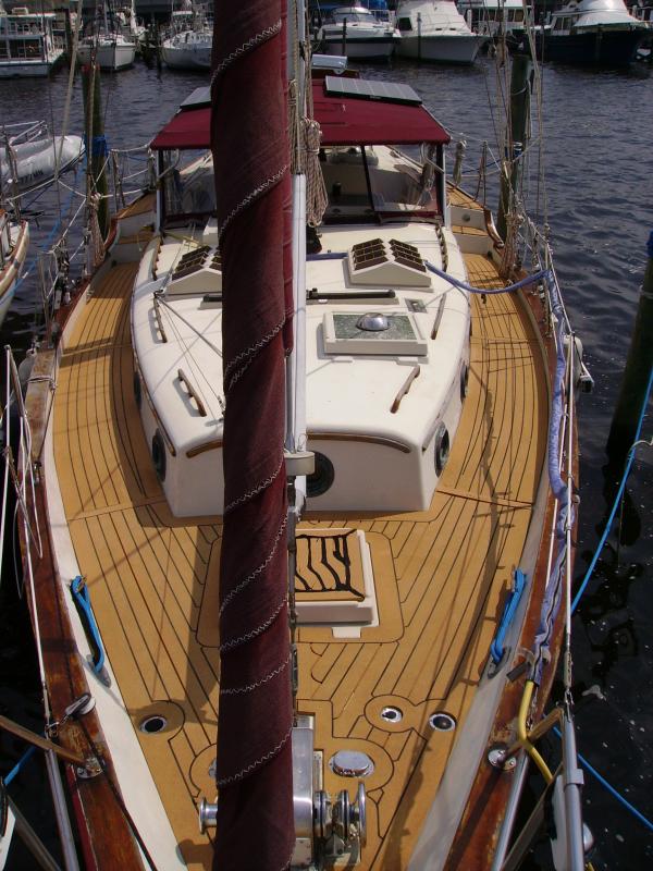

The previous photos were of the deck being dry fitted. I was asked to post a picture of the decking installed. Here is a picture of the boat after about a year with the deck installed. The deck has been sealed with our sealer.

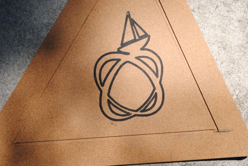

Also, we have done logos for some boats. This is a logo piece for a Marine metals steel hull schooner rigged sailboat.

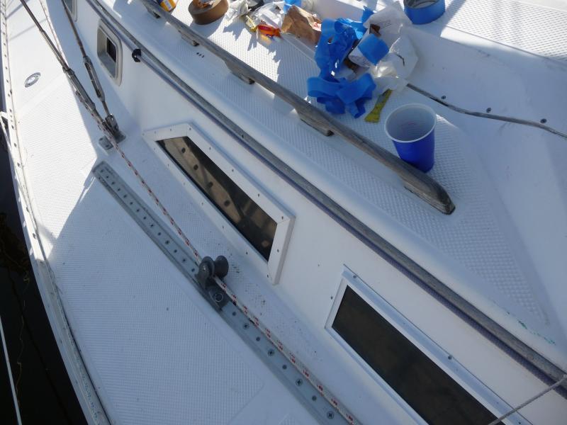

Corker, INFO: the Hunter 34's and 31's have a heavy molded in criss-cross anti-skid that may cause problems with the "sticky" on the backside.. It may be that a 1/16" foam could be necessary to accomodate.. Attached shot shows the anti skid and the smooth borders around stuff like the handrails..

Peter, I had my boat hauled for a bottom job this morning at your marina. Killed some time walking the docks and spotted your boat with cork decks. It looked just great and I think you are really on to something with this product.

Thanks Steve - did you get to feel the deck? it is amazing at how much it feels like real wood once it is installed. It really makes the old girl look good.

Thanks for the heads up. Since the epoxy compound we use to hold the cork to the deck is 'pre thickened' you can trowel it on thicker. This will allow the epoxy to fill in the H34 non skid pattern. It will probably be a little messy until you figure out the right trowel size to use. The epoxy gets squeezed out of the sides of the deck when you roll it and weight it during installation. The epoxy cleans up with [FONT=&quot]isopropyl[/FONT] alcohol until it is dry.
