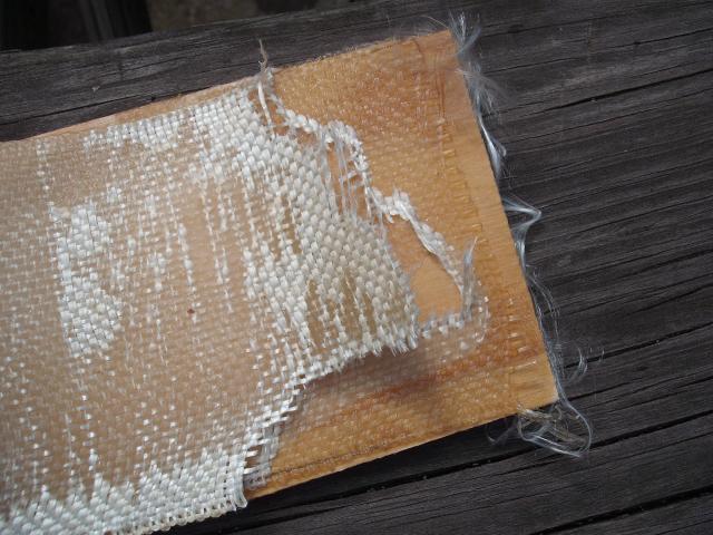

Right after my last post yesterday I went to the shop and cut some plywood and some fiberglass tape, mixed some polyester resin and put them together.Today when I got home from work I peeled the glass tape off the plywood with this result.

Which is why most of the books recommend using EPOXY resin for structural repairs... since the secondary bonding (adhesive) characteristics of epoxies far surpass that of the polyester or vinylester resins.

Dog, the other result observed is that the polyester bond and the strength of the glass is approximately equal. The resin pulled off the plywood in some places and off the glass fabric in other places. This was a peel loading so the most severe that can be imposed. I am sure that with epoxy the glass or the plywood would have failed. If the load had been in tensile or shear the bond would have stayed intact and the glass would have failed for the simple reason that the cross sectional area of the glass and the bond area favor the bond. Duck tape does wonderful things but it does peel off also.

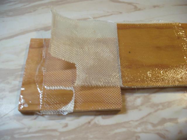

Just tested the epoxy, fiberglass on plywood. The epoxy adhered very well to the plywood but the fiberglass peeled off the epoxy with a little more force than from the polyester. The peeling force was 90 degrees to the plywood. I would use either resin for a repair depending upon what I had on hand.

The epoxy test piece. Held down with one bare foot and pulled with hands.
Careful examination of the plywood the glass pulled away from reveals glass fibers pulled from the fabric.
