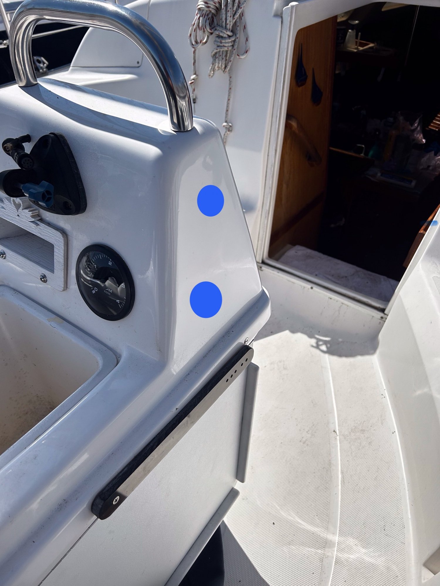

I plan on mounting my Standard Horizon Ram4 Remote Mic cable on my pedestal. In either one of the 2 highlighted areas shown here. Both are dependent on easy enough access inside the pedestal. I need to know which drill to use that will cut through the fiberglass and then the plywood backing without damaging the fiberglass itself.

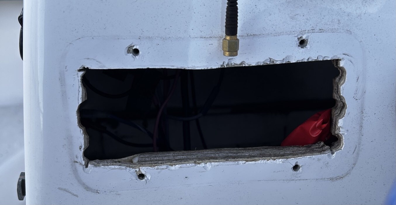

When I had to widen the original VHF mounting hole to fit a small shelf to fill the space, I had a heck of a time just cutting down the edges of the existing hole, probably had dull dremel bits but I don't want to chance damaging the 1 inch round hole I need for the cable end to fit into.
Thank you for the guidance.

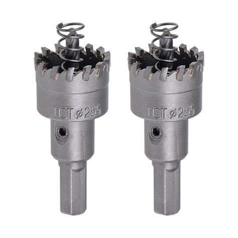

For the absolute best cut, use a new hole saw. I'm partial to the style below for metal and fiberglass, even if it is a Chinese one. Before you start, put some masking tape over the area to be drilled out (can reduce chipping). Drill your pilot hole and reverse your drill to get through the gelcoat, or at least a through a significant portion of it. Once you get at or close to the fiberglass you can use the drill in the normal direction to complete your hole.
This. And these hole saws. They are amazing, and the only thing I've found that will cut through fiberglass more than a few times before becoming trash. Cuts through metals like butter also. Follow the above advice about operating in reverse to cut through the gelcoat first, and you won't need any tape to make it clean. Use tape anyway - it's good practice.
Having said the above, if all you need is a single hole and you are sure you won't need to make holes in the future, then a cheap Harbor Freight hole saw will be good for one hole. A more expensive one like a Milwaukee or Lenox bimetal will get you a few holes before being trash.
DON'T borrow a hole saw for fiberglass from a friend. It puts them in a bad situation. I've learned to just say no and accept whatever effect comes. Otherwise, you are just buying the person a hole saw because it will not be returned in good shape.
