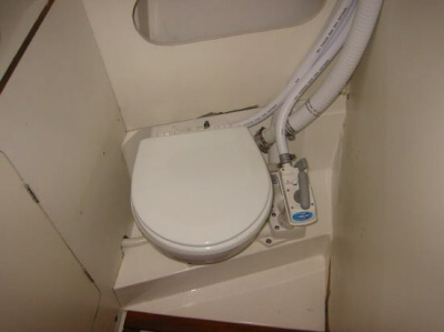

I learned the hard way after one night around 3:00 AM I stepped out of the bunk into ankle deep water. A guest had fiddled with the wet/dry flush valve and left it in a position where water was overflowing out of the bowl.
You were lucky that you were aboard when it happened...if you and that guest had left the boat, it would have sunk in its slip. Relying on the wet/dry valve to keep water outside the boat from seeking its own level INSIDE the boat is playing Russian roulette. What's needed that you obviously don't have--and what you'll see in the installation instructions for EVERY sea water toilet installed at or below waterline--is a vented loop in the intake, installed between the pump and the bowl...which requires replacing the short piece of hose the mfr used to connect them with lines long enough to put it 6-8" above waterline AT ANY ANGLE OF HEEL, which on most sailboats puts it 2-3' above the bowl. See the attached photos. You'll also find a drawing illustrating this in the installation instructions for every sea water toilet.The discharge vented loop is only needed if the toilet flushes directly overboard, with or without a y-valve in the toilet discharge line.
