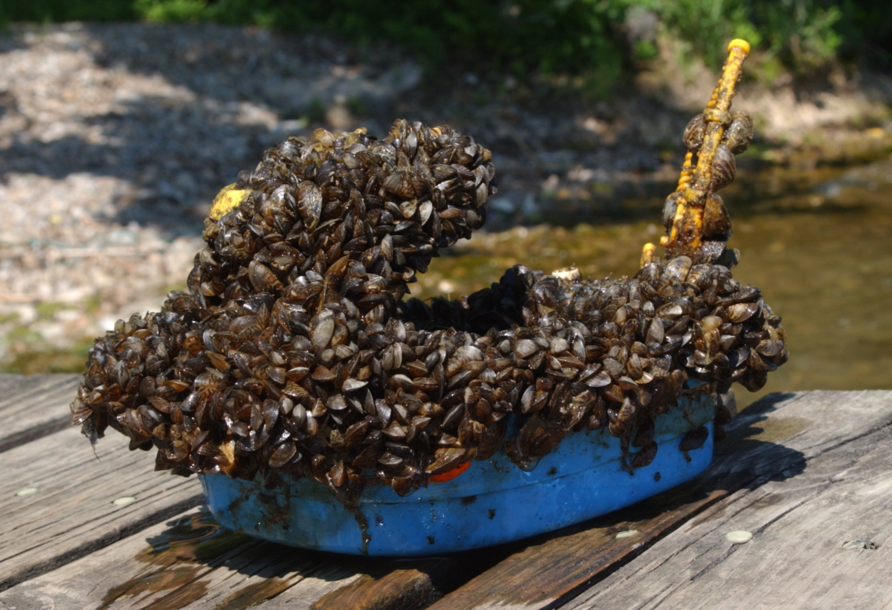

If you are dry sailing you are fine. Those of us on a ball or a slip need to paint because the Zebras will grow all over your boat bottom and keel. I know I missed a small spot last spring as I have one or two Zebra's on the keel where it meets the hull. Them and milfoil are a huge problem here in MN because with so many lakes, boats go from lake to lake. There are now volunteers at boat ramps that spend their day hanging out inspecting boats to be sure there are no aquatic hitchhikers.
Keel with Zebras
14,124
I will admit that I've never experienced zebra mussels as I left the midwest before they were an issue but how are they going to affect a 17' trailer sailer if there are no thru hulls (can't you close them when you leave the boat if there are any?) and the outboard is tilted up?
Zebra mussels build colonies and grow on top of them selves. They attach to hard surfaces.
