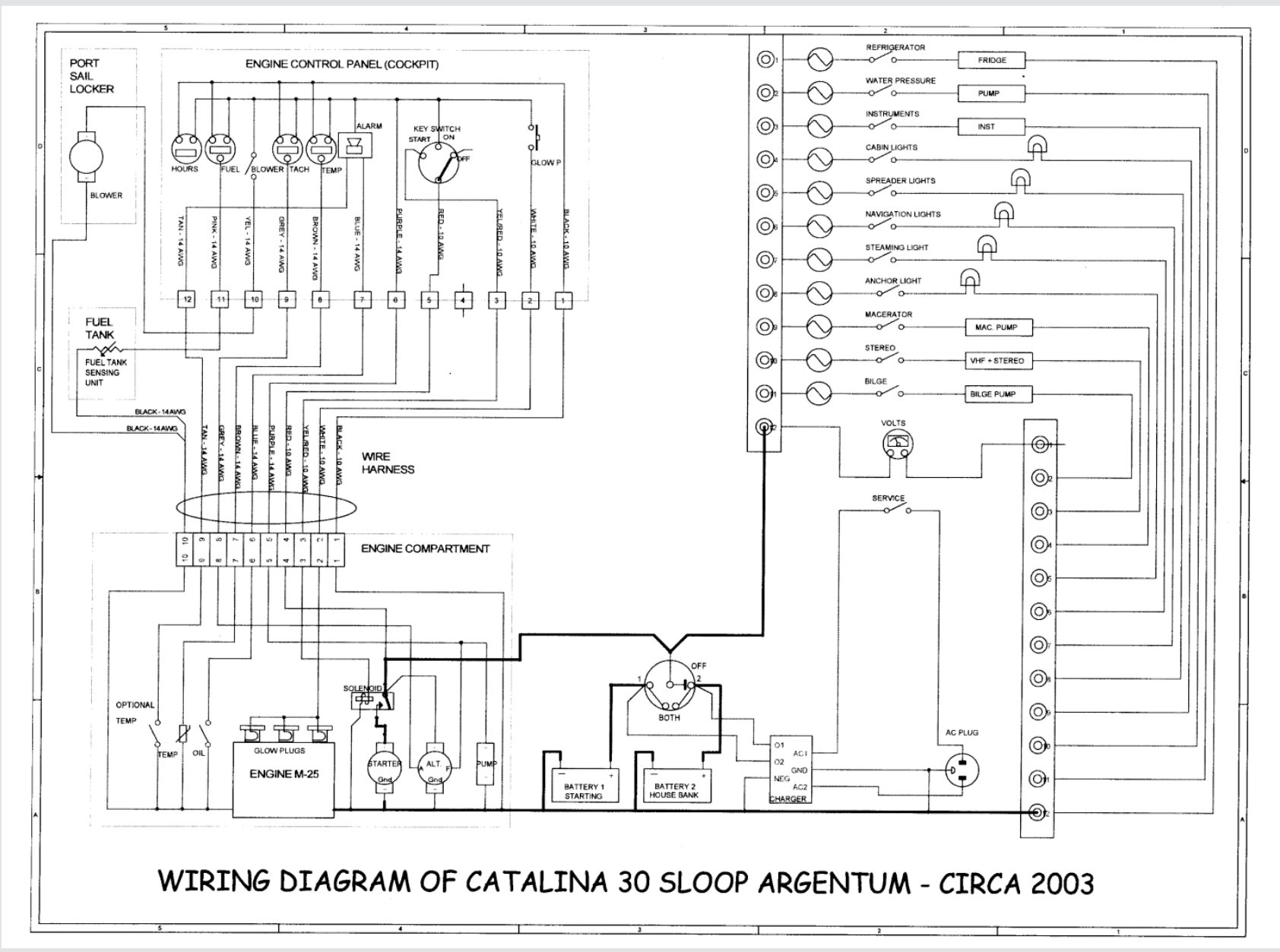

23,546
Hi Mayhem,
Here is how one Catalin Owner has his system wired. The bilge pump looks connected to the common of his three-way switch.
