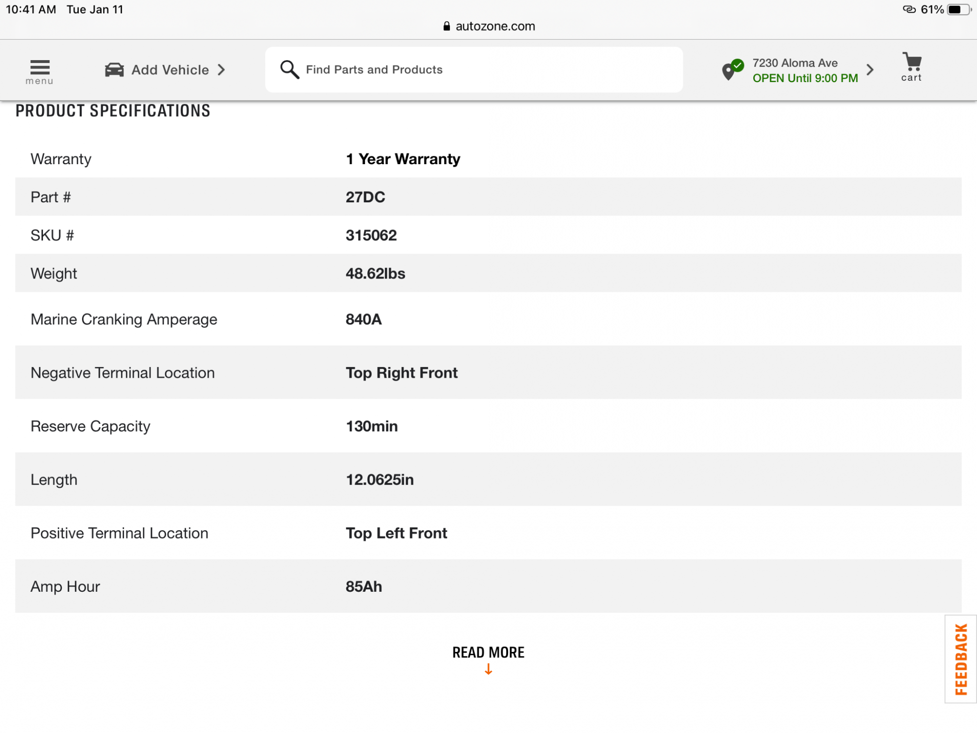

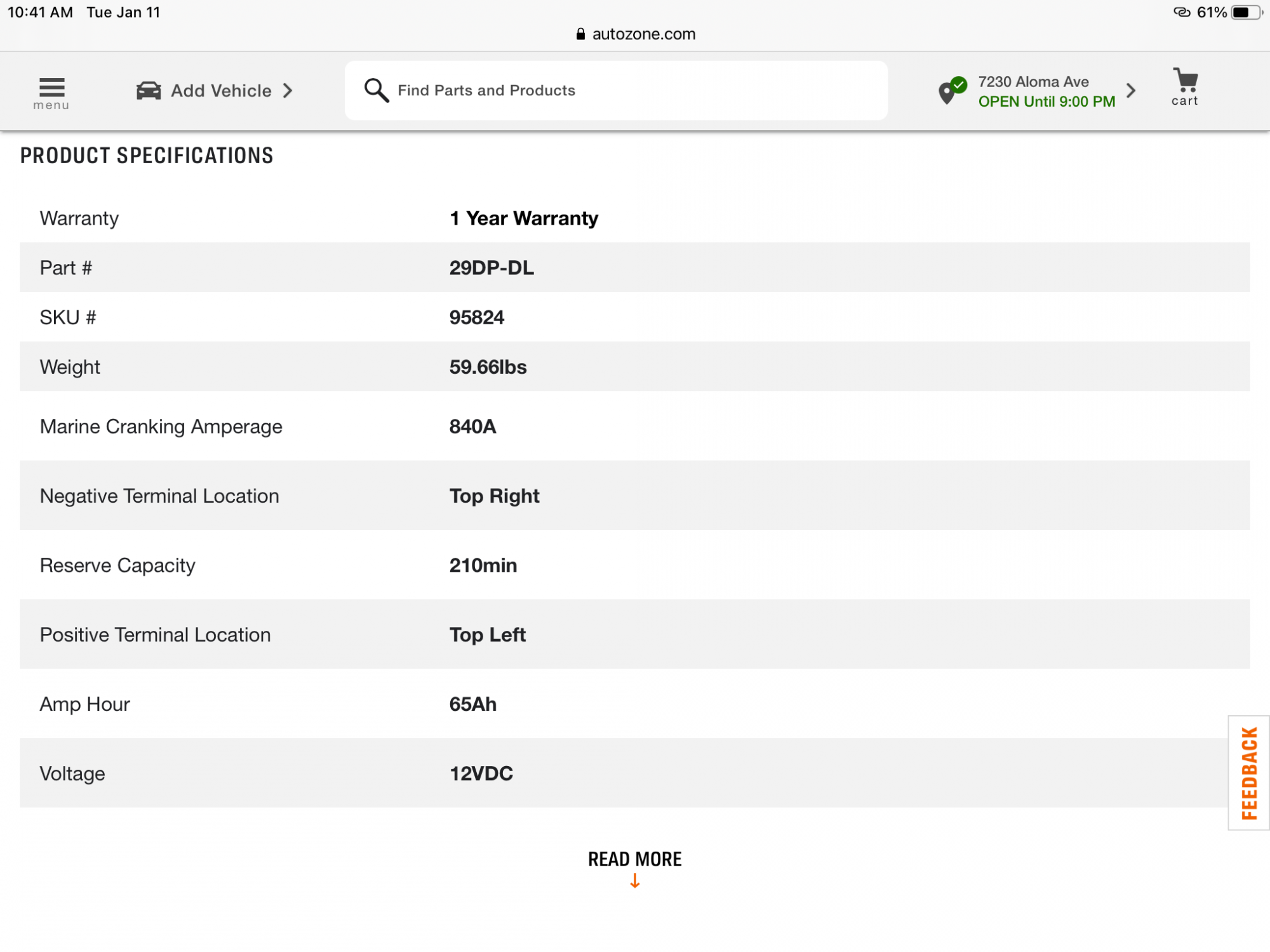

How can you tell which battery is a better choice for your house batteries? One has more Reserve Capacity minutes, the other has more Amp Hours? Which is more important; Reserve Capacity or Amp Hours? See attached, how do you determine the best choice?

Both attachment are the same by looking at the sku numbers.

I am looking to beef up the house batteries, but the one that is less AHs has a longer Reseve Capacity, that just does not make sense to me.

I'll probably say this improperly but Amp hour ratings can be based on different discharge rates e.g. 20 hour rate, 8 hour rate 15 hour rate. To compare one AH capacity to another without knowing the discharge rate can be misleading. Personally I would not buy a house battery based on AH capacity unless the battery showed what rate was used to calculate that capacity. The two fact sheets are obviously confusing and I probably wouldn't buy either one unless the manufacturer provided how the AH rating was determined. That said, if I was going to buy one of these two I would go with the one that weighs 59 pounds rather than 48 pounds. All other things being equal ( I know they rarely are) more lead should mean more capacity.

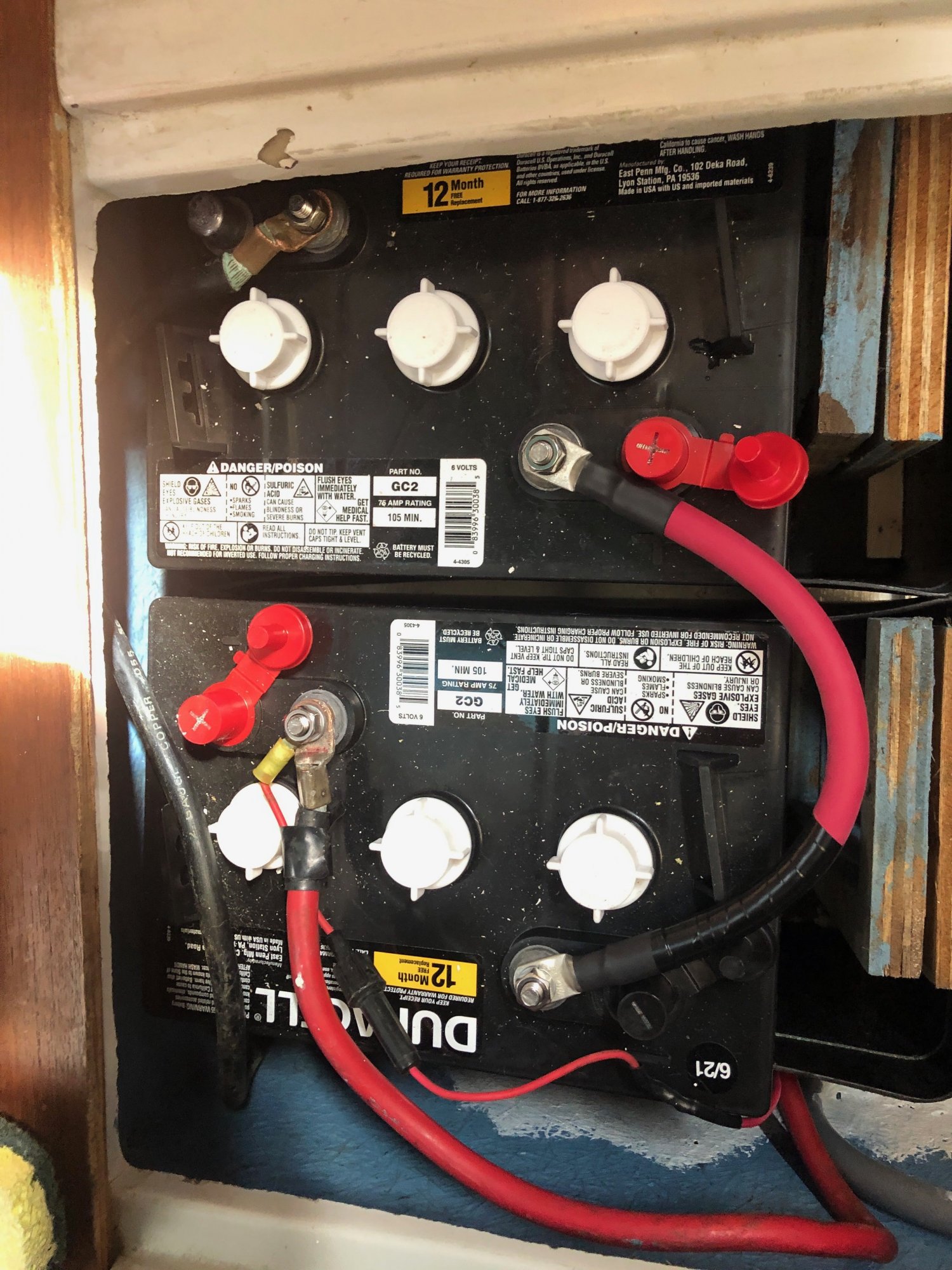

I had 2 group 27 “deep cycle” batteries on my boat. When they showed signs of weakness, I (finally) tried golf cart batteries. I bought 2) 6-volt Duracell GC batteries at Sam’s Club. 215 AH in the bank, very happy with them so far (just 1 season). Anchored out for 2 nights with plenty of juice. Right now, that is my only bank (no start battery yet). So I put some faith in those batteries. I monitored them closely and felt very comfortable with them.

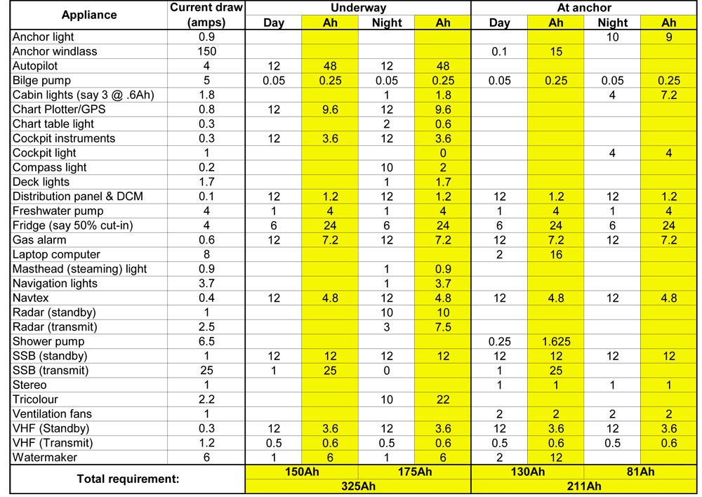

Here's a chart that may help in what amp for your house bank may require. I currently have 4 GC batteries at 220 amp = 440 total but only can use 200 as I don't like to take them below 60%

BTW I forgot to state I also have 335 watts if solar to help maintain charging of the batteries.

Here's a chart that may help in what amp for your house bank may require. I currently have 4 GC batteries at 220 amp = 440 total but only can use 200 as I don't like to take them below 60%View attachment 201684

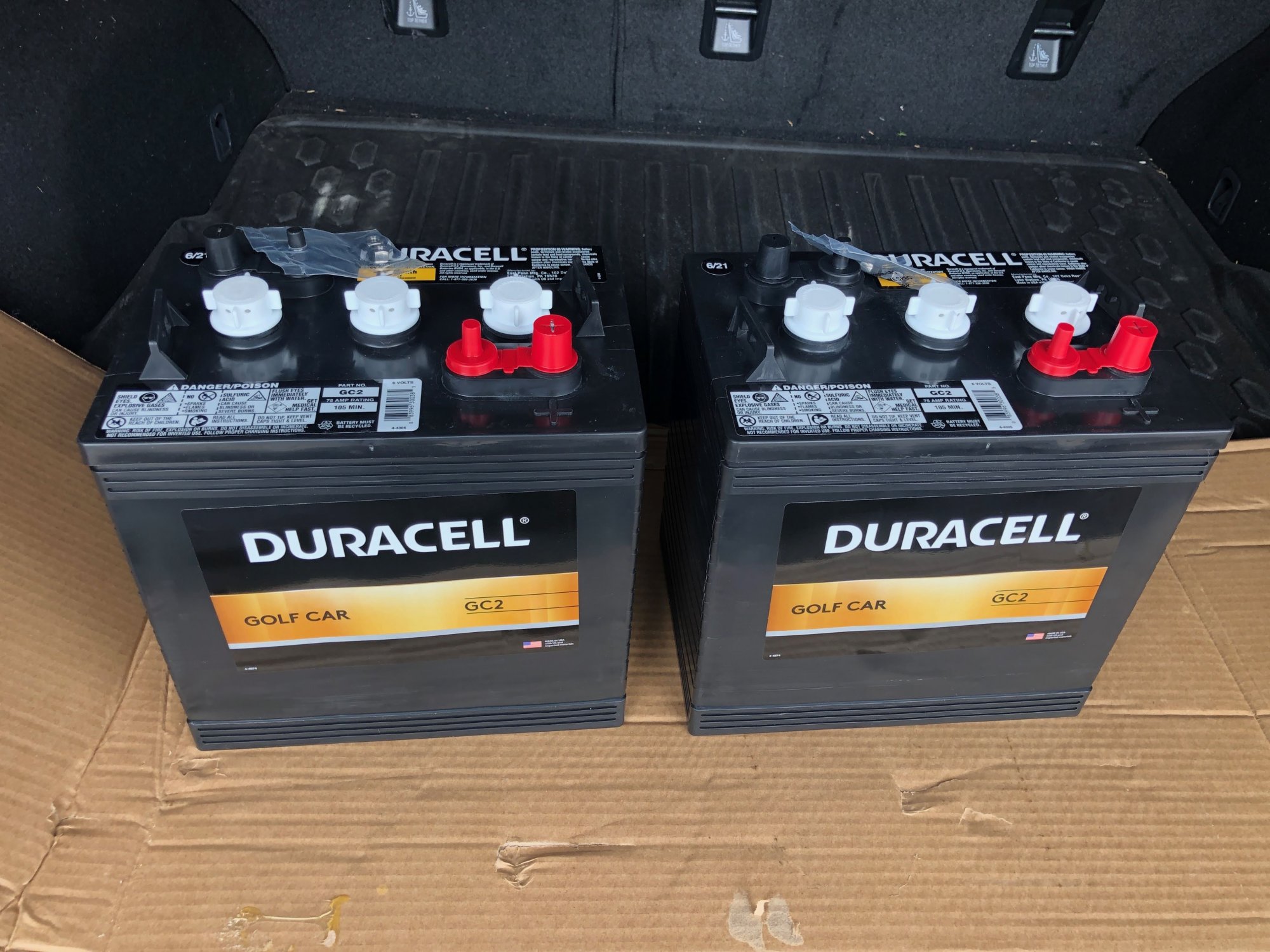

I bought two Duracell Deep Cycle 6V batteries (GC2) and wired them in series for 12 Volts. These are rated for 230Ahrs, much higher than a Gap 27 dual purpose battery.
