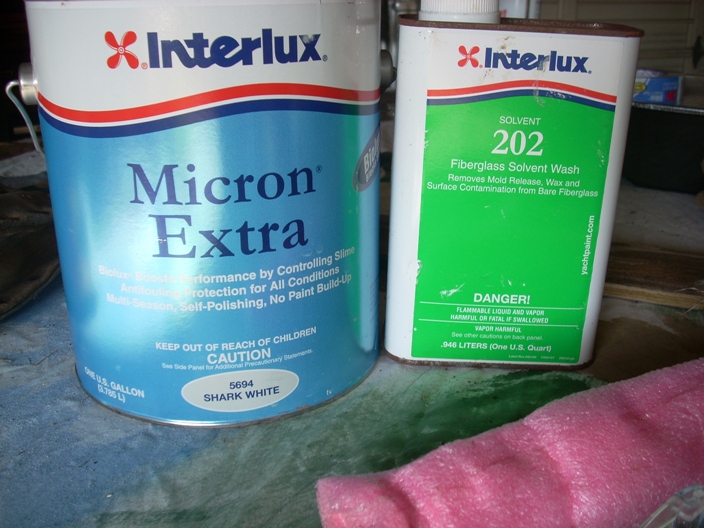

I've had great success with Interlux too. The Micron extra w/Biolux works great on our SW Fl crustys and tolerates being on the trailer for a few months each year, and being an ablative it'll last a couple years with no trouble. My 260 used about 1 1/4 gals with 3coats at the water line and 2 on the bottom. Here's a pic.
Have fun. Mike
