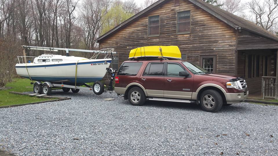

I trailer all the time and I just strap the boom with the sail flaked and tied on it between the stanchions on deck.
Never had any problem with it.

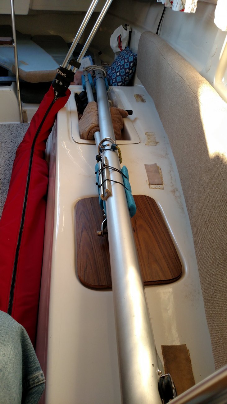

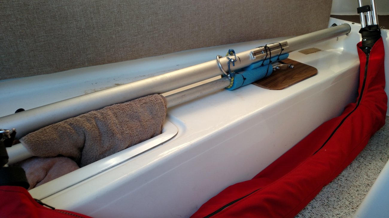

A lot of great ideas here. Thanks for the replies. I took a mix of a few different ideas and came up with what you see in the pics below. The boom is strapped to the gin pole, with it's break winch snug in the port side under-seat storage compartment. The bimini is strapped to that. The goal is for everything to be inside the cabin, secured as best as practical, with no chaffing on anything important / visible. It's a bit overkill for a quick jaunt to the ramp, however, for 3000 miles, I think it's worth the extra effort. I'll let you know how it works out!

That forward end of the boom won't bang on the Vberth will it? Can't tell from the angle.
Do you think those towels will keep everything from bouncing up and down on the road? One last thing I would do is tie a line around the boom above that forward hatch, run it thru the settee and back up thru the aft hatch. Then snug the line on the aft end of the boom.

Update on the trip, a month late, sorry! The boom/gin pole made the trip perfectly! I don't think it moved at all. Justin, the end of the boom was a good 2" from the v birth. Absolutely no rubbing or chaffing at all. Yes, it's a bit overkill, but it gave me exactly what I was looking for! Thank you all for your help...!
