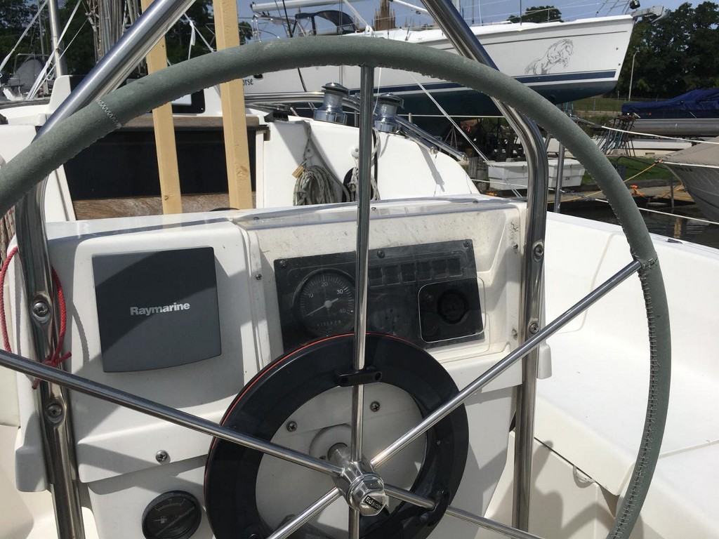

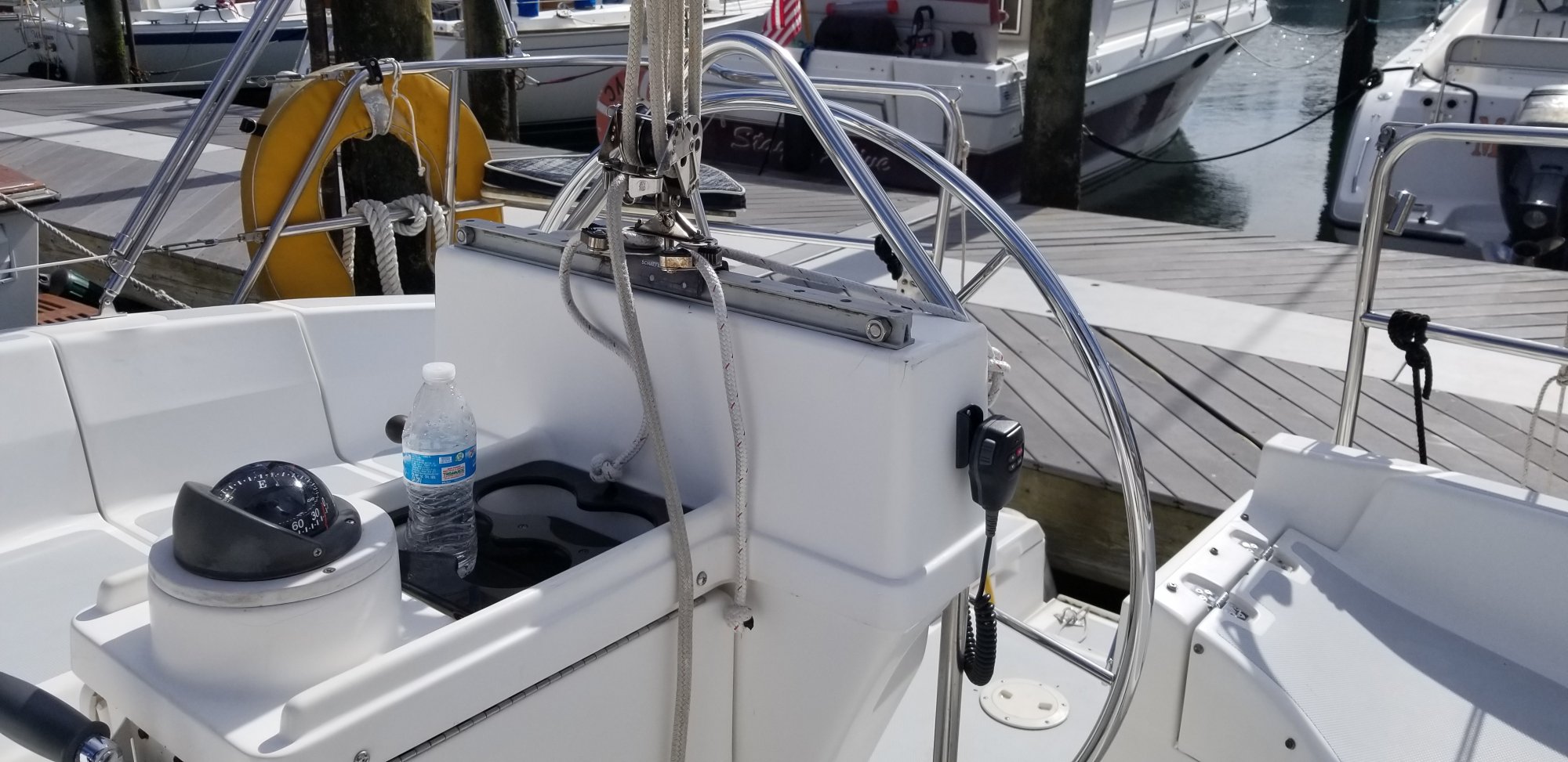

Trying to figure out how and where to mount GPS at helm without it being in way and getting wacked around.

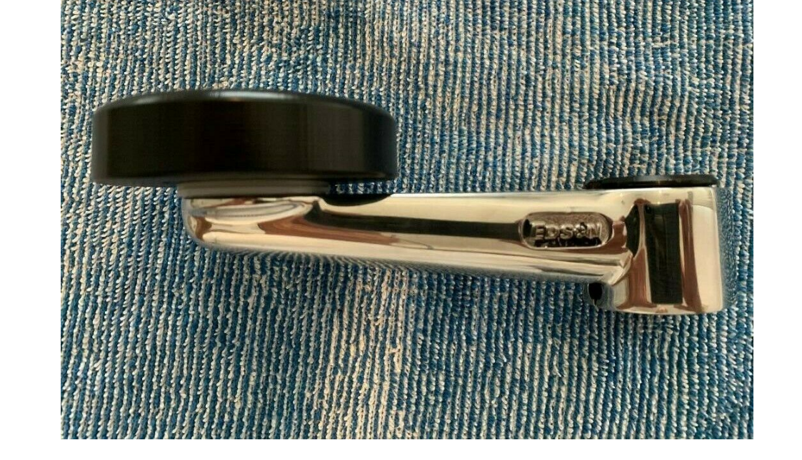

My 33.5 has an Edson arm that the gps mounts to. I went with a 5"plotter although I could have went with a 6" unit. The boat came with an old Garmin 400 series plotter and the new garmin 5" was pretty close to the same footprint and I just felt that anything bigger would be cumbersome . The 5" has been discontinued by but you can still find them in stock at a few places online.

Would you mind sending a picture? Much appreciated.
Thanks

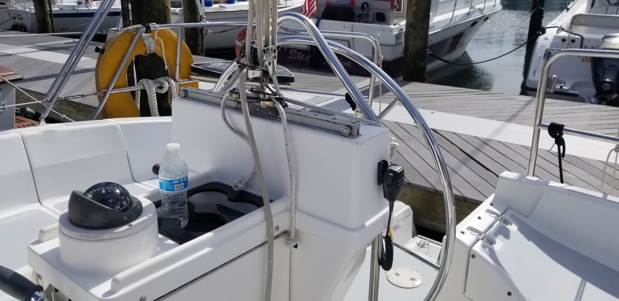

Please show a photo of your cockpit and helm as there might be different helm configurations for mounting a gps/chartplotter.

Suggest mounting a narrow acrylic board cut from a plastics supplier just ahead of the compass to mount the gps/chartplotter. That location would allow wires to feed it from the cavity below the compass with weather tight fittings.

Custom bracket to mount on top of the stainless tubular pyramid in front of your wheel that allows for a rotating gps mount.

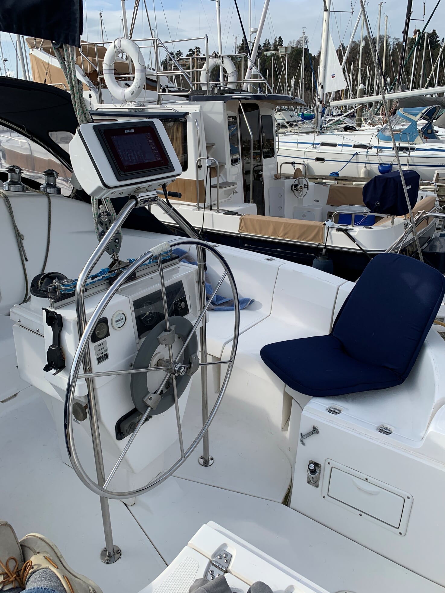

hunter 336 seattle
This is how I did mine. Works great but you will want to stick to 7 inch sizes. 9 might be too big for this type of mount.
It's a PYI mount.
