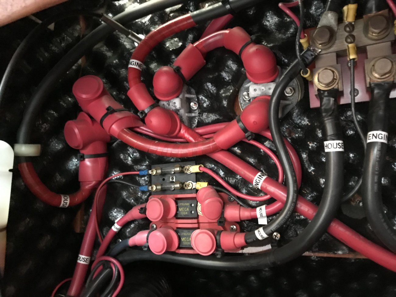

Anyway, I looked at the schematic for the m-LVD, and it appears to go on the positive cable between the battery switch and the panel. But I have two, thick house battery cables, as shown in the attachment (you can sorta see the "house" label on the cables on the left side of the image). How would a person install the m-LVD in this setup?
I'm not the most handy person, and don't have years and years of experience with boat systems such as this, so it may be a simple matter, but I am mystified.
