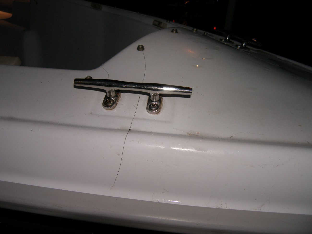

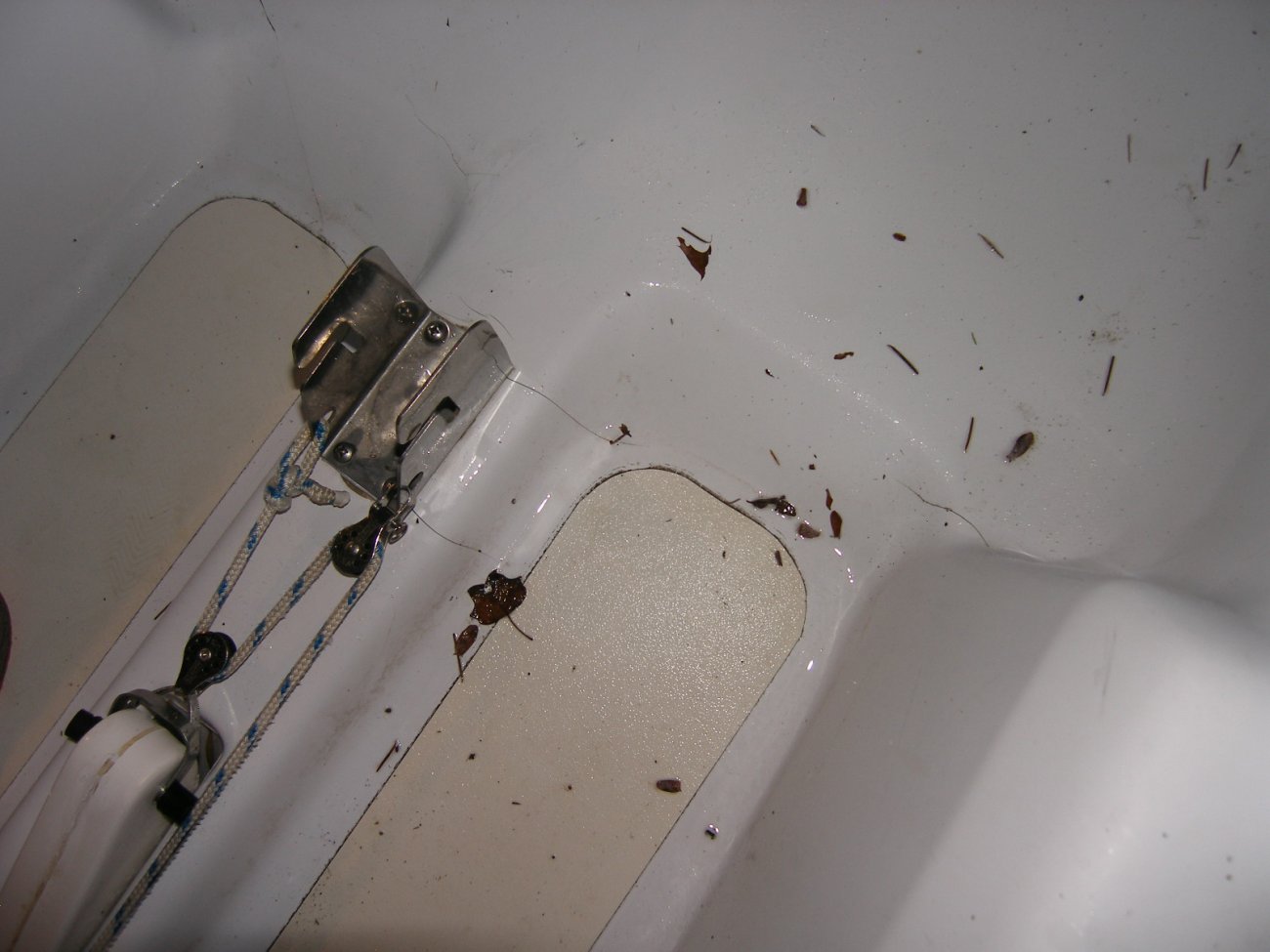

So I am trying to figure out when I need to grind a wide channel and lay some glass for the repairs. I have several very long cracks into the forward area the will be glassed. I have included some pictures of other areas. Do you think they need to be glassed?

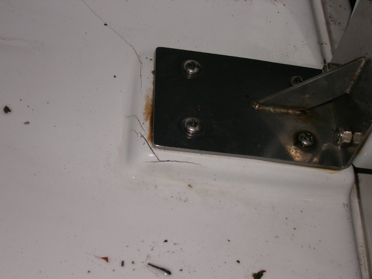

The tabernacle has the aft crack that goes onto both sides. Do I need to glass the whole area?

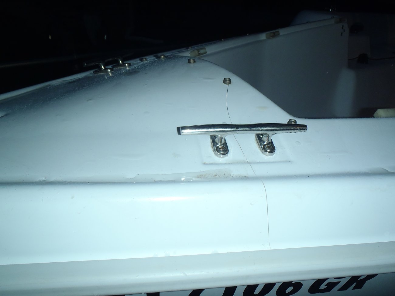

Cracks that go up and around the curved area on the sides?

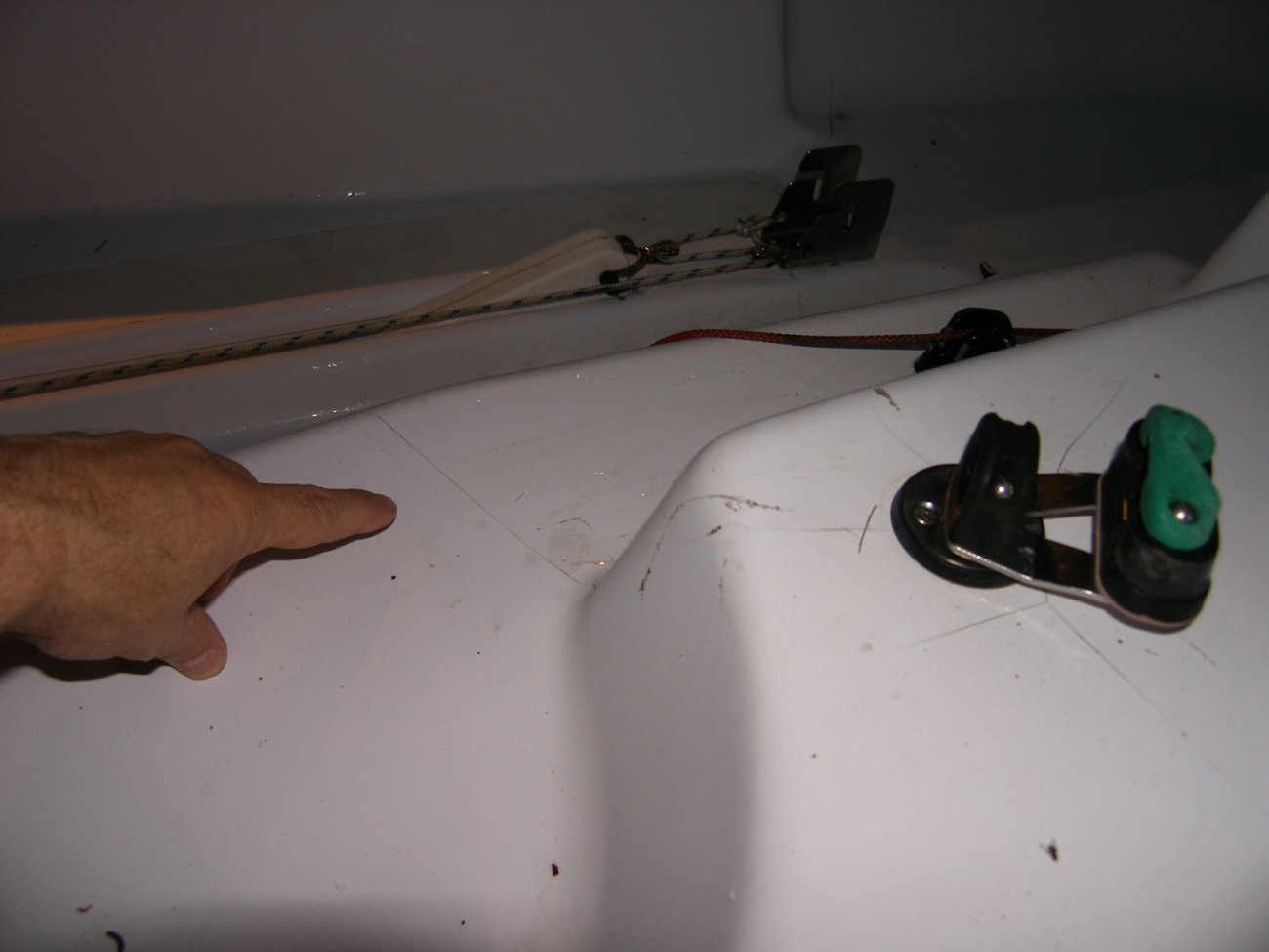

Cracks in the area where the jib cleats mount?

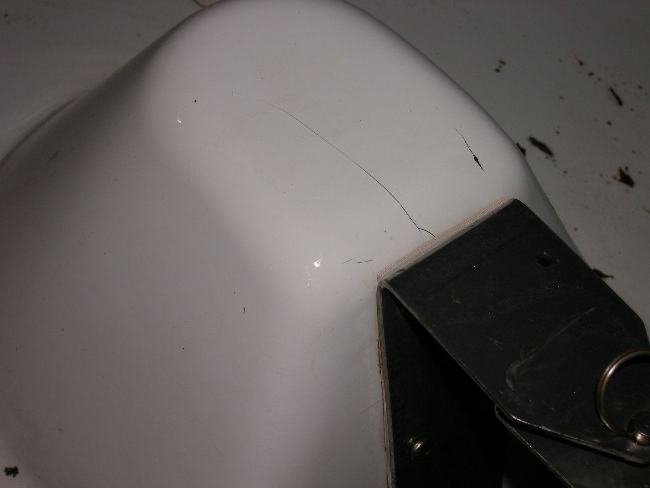

Cracks around the motor mount or rudder mount?
My thoughts are I can always grind and add glass later. A lot of the cracks really look more like they are from the plastic shrinking more so then structural. Even the one around the tabernacle seems to not be structural. The tabernacle is very solid in its position. The boat has never had a motor mounted to it and there are cracks. But I could see the differential movement of the metal vs the plastic in temp changes causing issues.

Those look like gel coat cracks to me... not fiberglass failure. google "gel coat crack repair"

It is a Hunter 170 which is made of a Lexan like plastic on the outside, some foam and then thin fiberglass. It needs to be repaired differently.

Since I’m not an expert on this subject I’ll not offer any advice on that level but I will offer my opinion on what I would do. First I would continue to look for an expert opinion and if that did not work I would grind very carefully through the gelcoat to see if there is any damage to the underlying structure. Small cracks on the surface could be nothing or could also be something totally unexpected. Either way you will never know unless you grind it out to see what is going on. The other thing is if there are cracks I would look at the area to determine if I could see if there are any point loads from the rigging that may have caused these cracks. If there is I would try to devise a plan to not only repair any fiberglass that is damaged, I would look for ways to add reinforcement to those areas to prevent any further cracks in the future. Following this method should eliminate any future repairs of the same areas if you have indeed identified the reason for the cracking in the first place. My feeling is that unless you know that you have done everything possible to strengthen and repair the cracks you will never know that you have a safe boat that you can trust to take you on the journeys you wish to take. God luck with your repairs, but most of all keep looking for expert advise.

You can find my 2-part post about motor mount repair on a 170 here - https://hunter.sailboatowners.com/mods.php?task=model&mid=11&mn=170 That was done nearly a year ago & so far, all looks good.
The hump in the middle of the stern, that the rudder attaches to, has a block of wood inside it, if it is anything like it's bigger brother, the H212. I did a quick little repair on my 212 a little while back. Details can be found here - https://forums.sailboatowners.com/index.php?threads/h212-gudgeon-repair.191936/ The wood spreads out the stress from the gudgeons. The crack that you have in the top of the hump will probably not give you any immediate structural issues, but it will probably allow water to intrude & rot the wood. That would create a major problem. I would V-out and patch that top crack as soon as is practical. I would try to get the insides bone dry before sealing it up.
I would expect that the cleats & tabernackle have backing arrangements that are similar to the rudder mount hump, but I do not know that for a fact.
