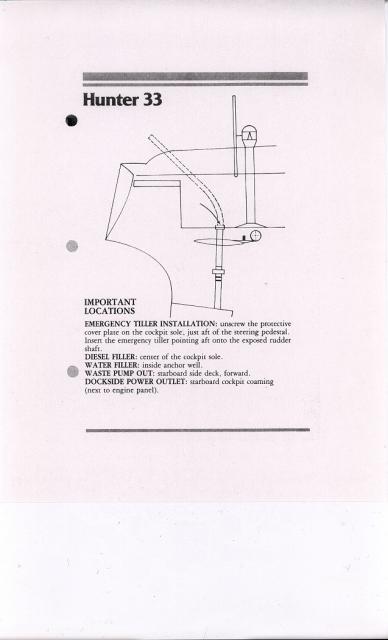

Fairly easy to make one
Made one up using a length of pipe from Home Depot. Believe it was 1.5” stock. Form in an “L” shape with a pipe elbow. The guys at the store will put in the pipe threads you need. Put a cap on the end. As everyone has said the end that fits over the rudder post requires a bolt through the middle to fit into the grove in the rudder post. The emergency tiller fits on backwards with the tiller facing to the stern, see attached picture. It is very important to have an emergency tiller. Don’t find out the hard way like I did.:)
