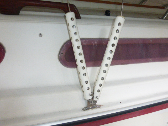

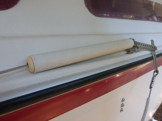

Exactly. I don't have a fore-sail big enough to worry about sail wear there, but the flipy-flopy adjusters are sure a pain when setting the mast without the covers installed to hold everything straight. Today I did the modifications to my 1" sch 100 pvc covers and installed them on the boat. I still need to pick up some proper 1 3/8" pins and cotter rings to secure them to the shroud adjusters (shown with pieces of all-thread inserted just to hold them in position for photo), but otherwise I'm happy with my new "turnbuckle boots" ;) .

that looks great, and I think it may prevent them from becoming a spider hatchery...
one thing I might suggest as to the UV rays... even though the parts are relatively safe and PVC does not visually degrade very fast in the sunlight, but it can get brittle. painting them with a "made for plastics" type paint will keep them safer and prevent the yellowing effect, and they will look better for a long time.
