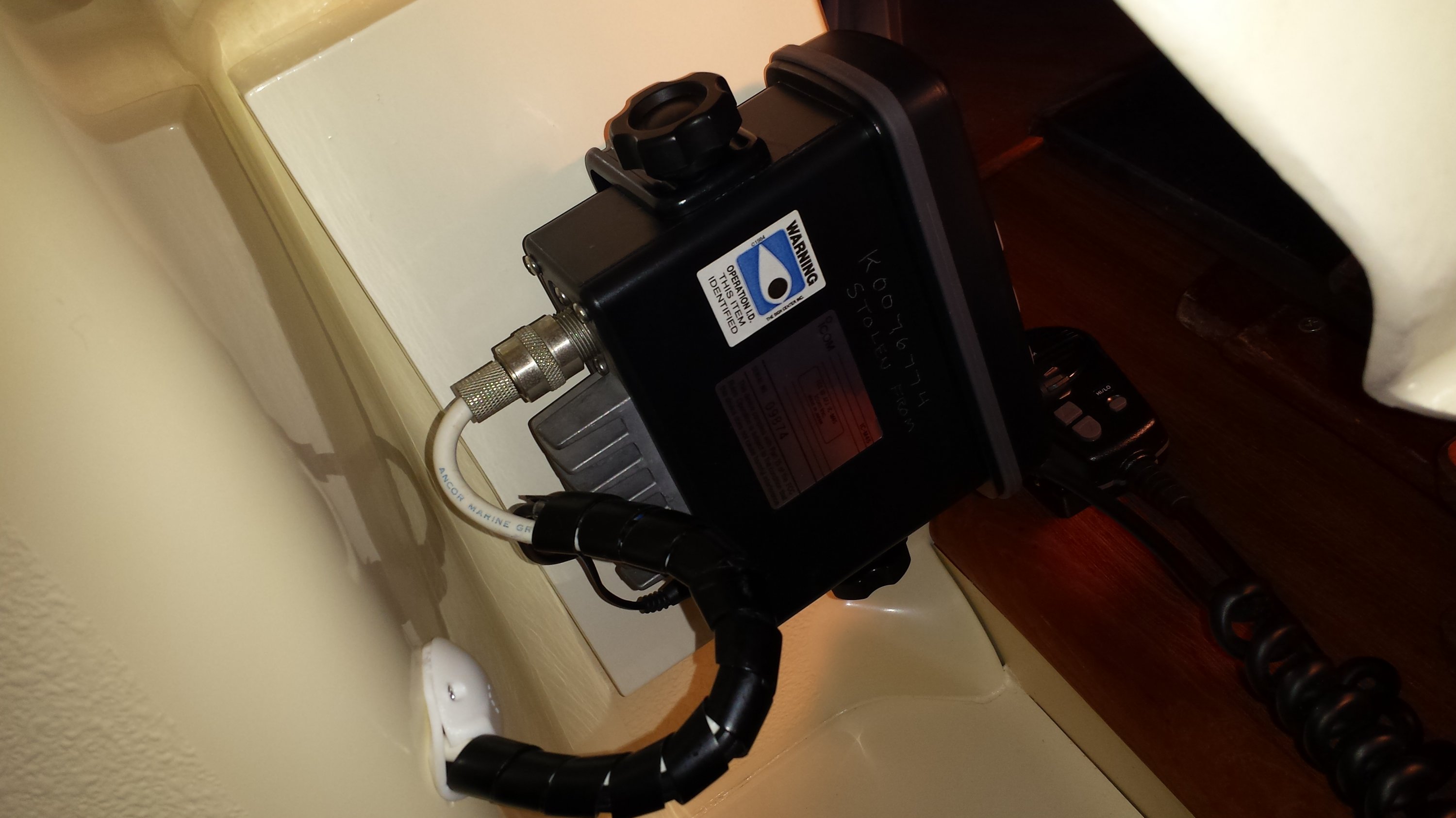

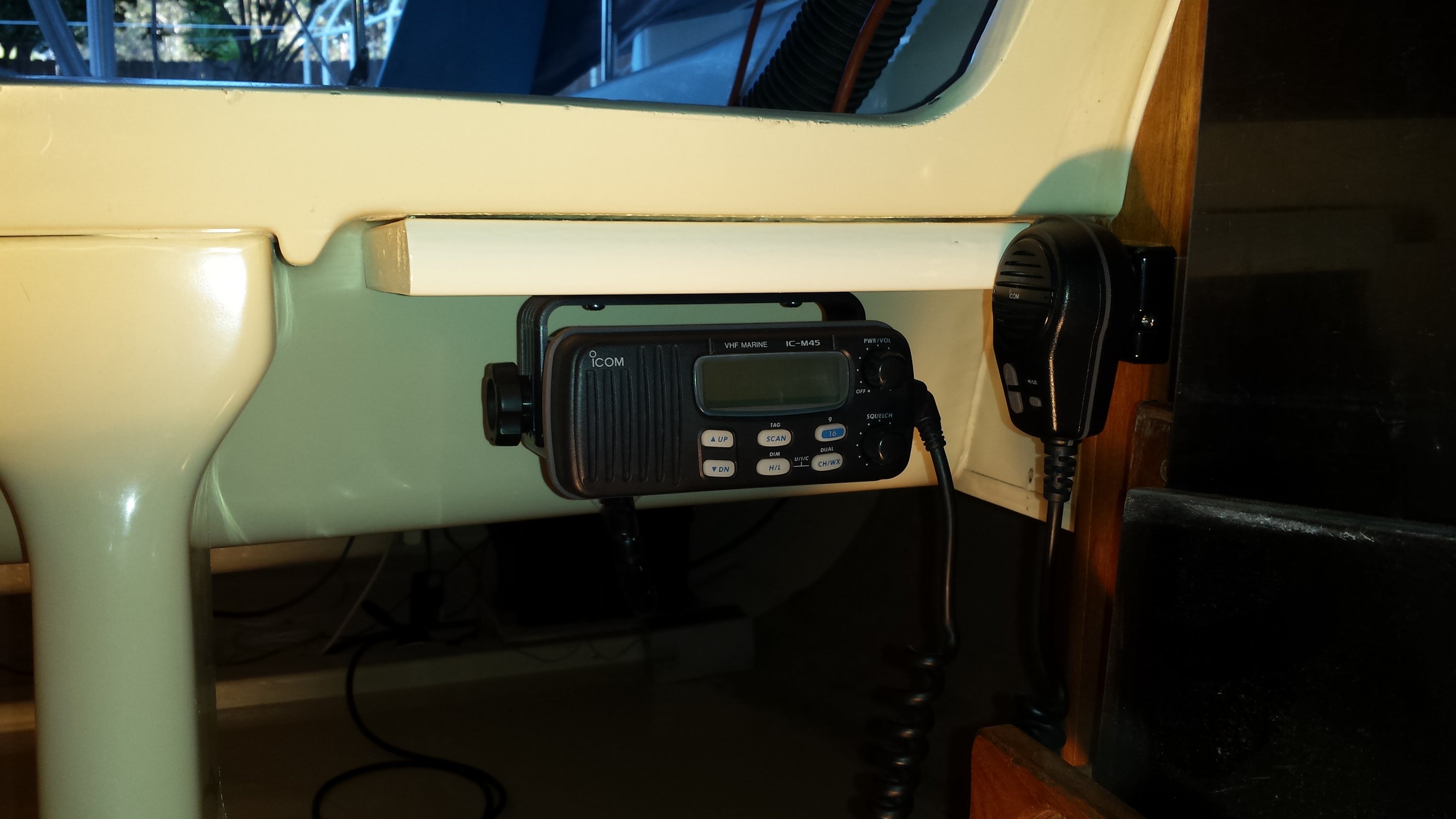

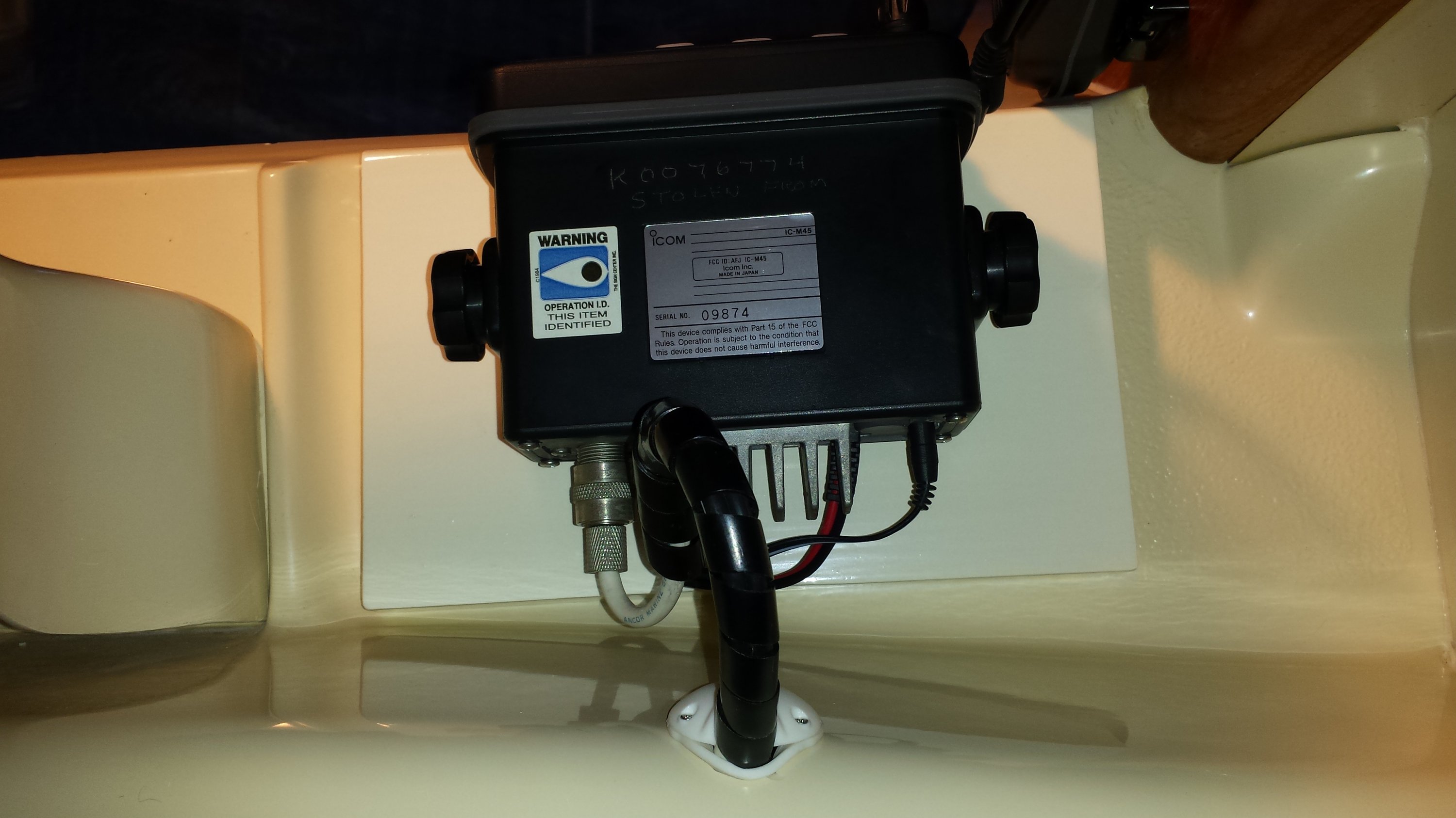

Rgranger,
Have you installed your VHF radio yet? Like you I'm still getting to know my new to me H26 and in the process of several projects. I just finished moving my VHF radio to below the companionway. I really didn't like where it was installed over the galley. The wires weren't hidden at all, they were simply cable tied and ran outside along the floor of the aft berth to the back compartment.
The new location provides easy access to the cockpit and inside the cabin, with an external speaker in the cockpit. There is a small space between the cockpit floor and the aft berth headliner that allows room to run wires and removal of the access panels makes it very easy. I drilled a hole in the forward bottom edge of the headliner where the wires come out and finished it with a wire cap from WM.
I used heavy duty construction adhesive to fasten a 1 inch thick piece of wood to the headliner that is painted with Rustoleum Topside paint. The color is Oyster White, which is almost a perfect color match to the interior. That wood provides a secure place for screws to hold the radio bracket. There really isn't enough thickness in the fiberglass at that location, and I didn't want to thru bolt it.
All in all, I think this makes a nice clean installation.
