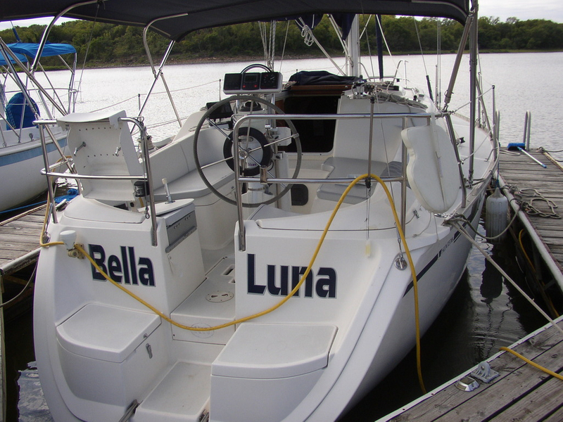

Mine is on the transom. Right next to the B in Bella.That's where a P.O. mounted it. I broke the mount with my Makita buffer a while back and glued it back together. The joint just gave out. I can't find a suitable replacement mount with the same bolt pattern. I don't want to drill more holes. I'm thinking of mounting it on the stern rail but I read that my bimini might affect the accuracy. No different from now right? Should I mount it on my bimini rail outside of the fabric? I think there's enough cable in the laz. Does it matter that much?
pic when I bought her. I don't hang my shore cable on the antenna.

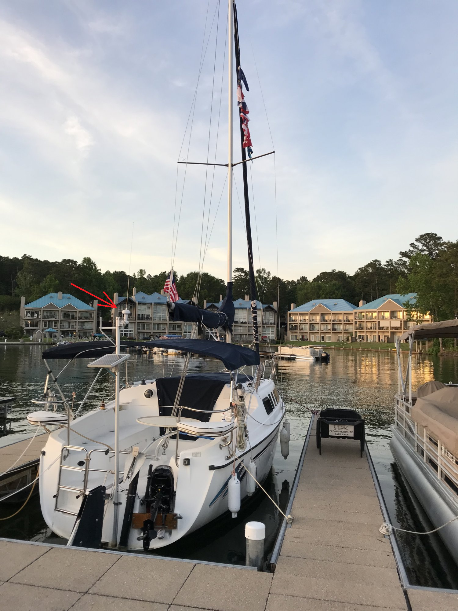

We used a small standoff bracket mounted on the little platform that holds our radar antenna dome, which is on a stern post.
(Also, I moved the stern light up onto that post from the original stern rail location-- much better visibility when in larger seas.)
You can view it in this photo:
