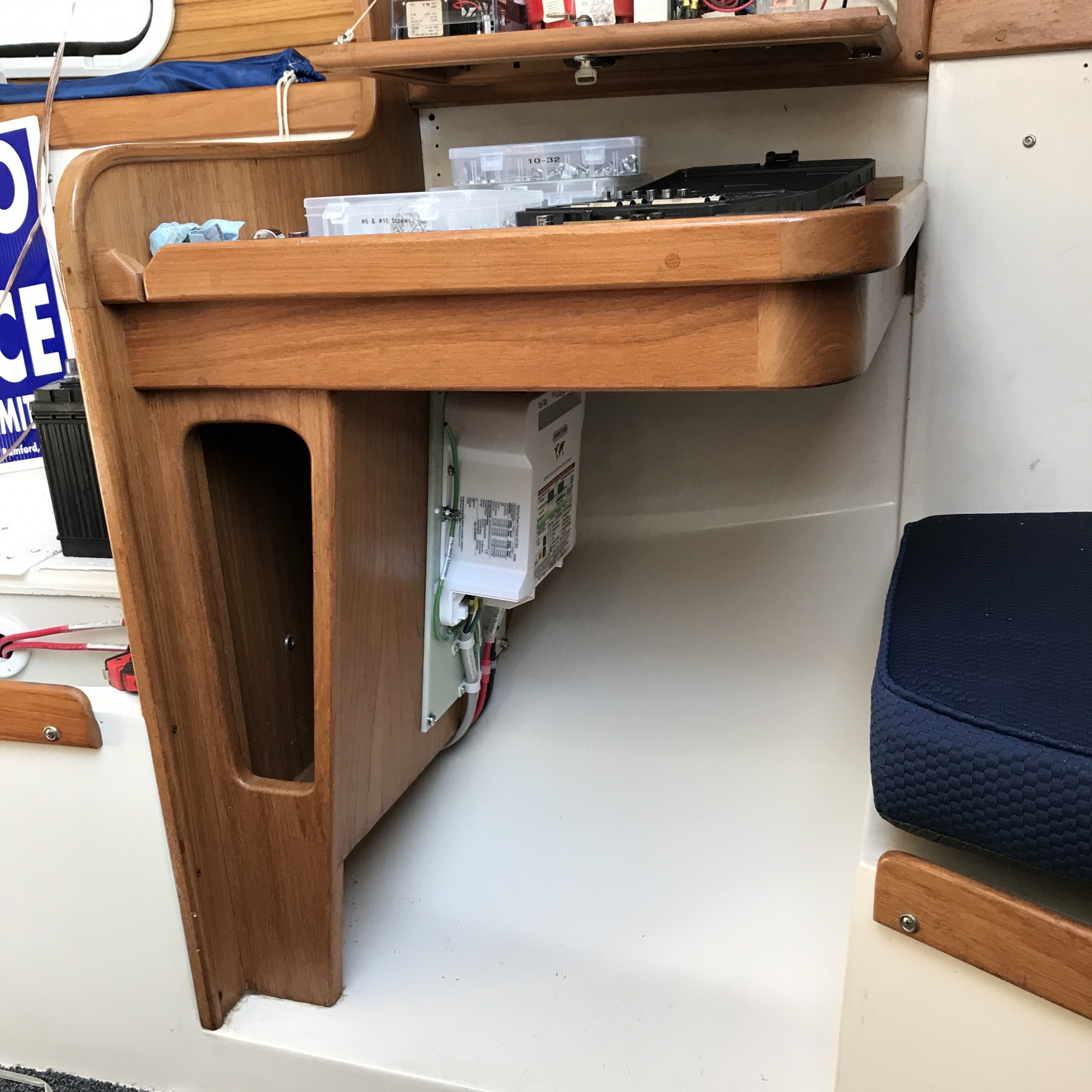

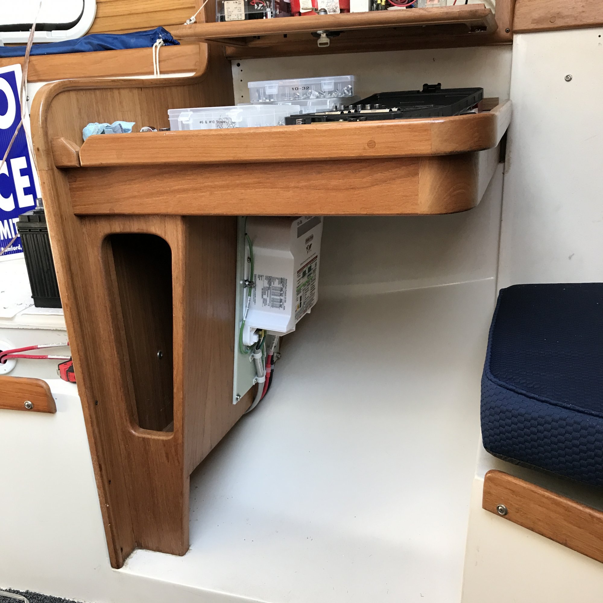

Hi Mike, the original on my 93 C30 was mounted in the compartment under the aft starboard seat. I've also seen the charger mounted in other C30s in the port lazzarette as you mentioned above.
When I installed my new charger I put it under the nav station, as seen in the photo below. Not sure if you have that area available on your year boat.

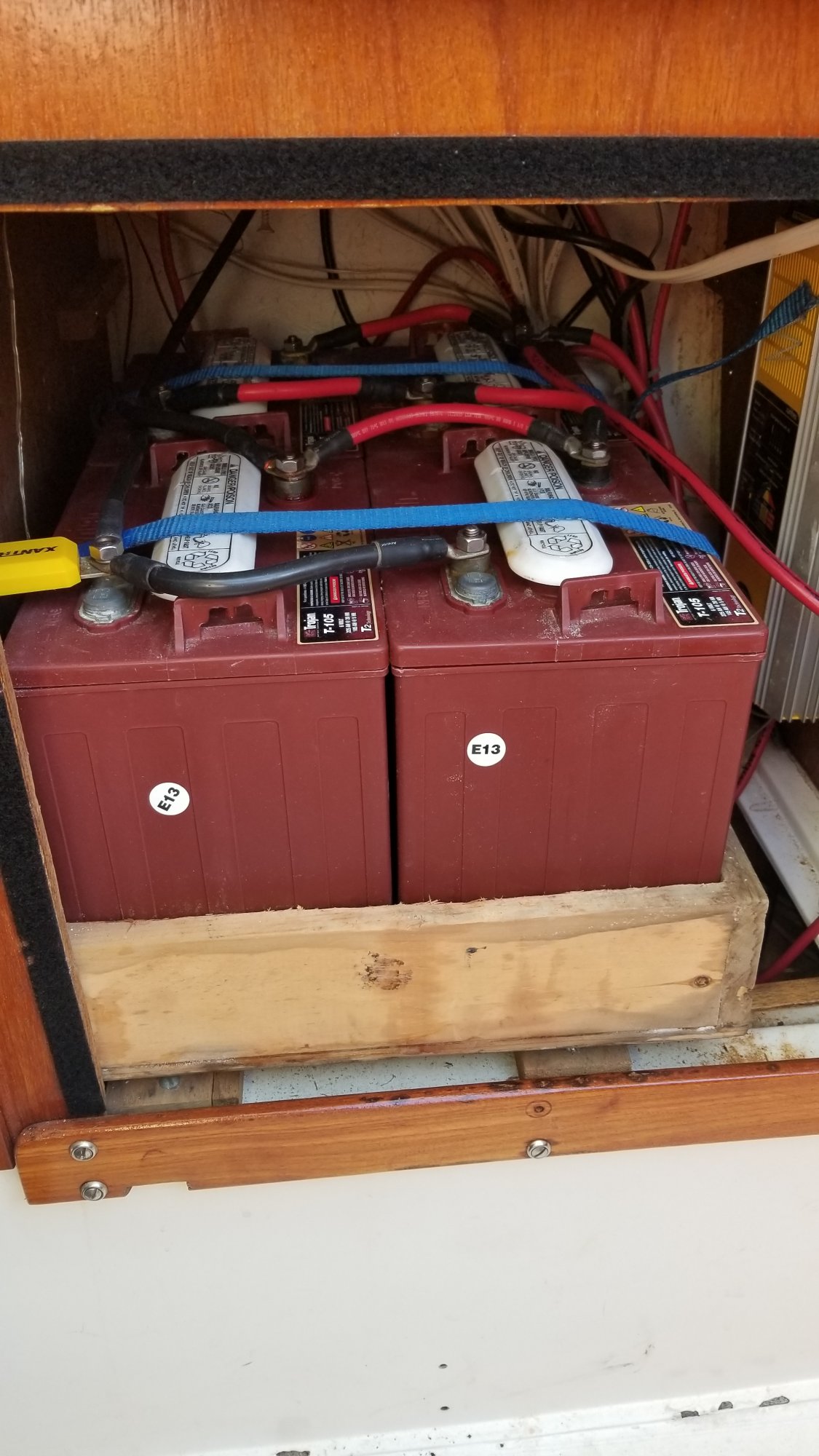

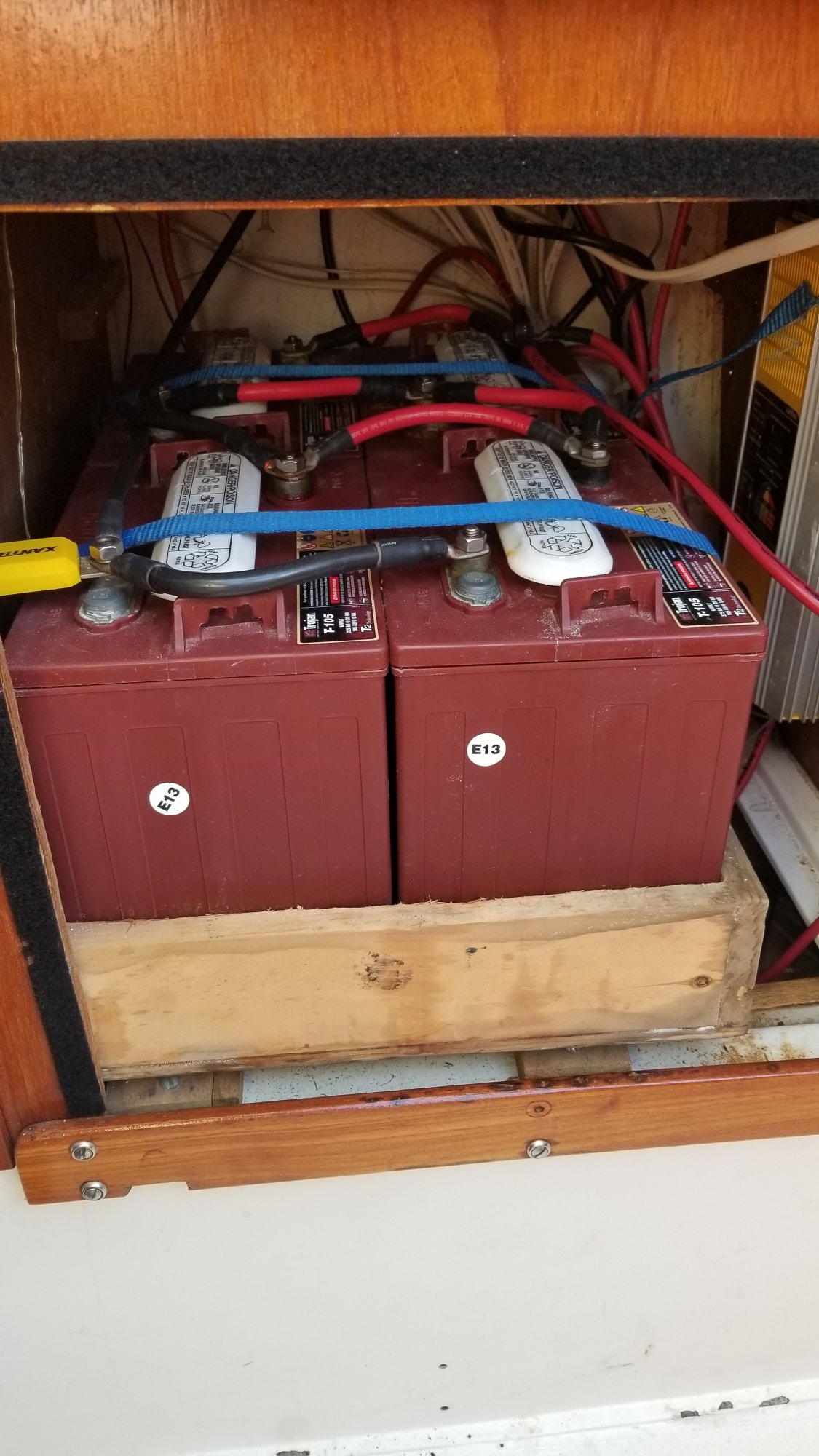

I don't have the C-30 anymore, but I mounted an old Xantrex-30 3 bank charger under the nav table. I had 4 Trojan 105's mounted as seen and a deep cycle battery very close to the engine that I kept as a reserve.
It seemed to work very nicely.

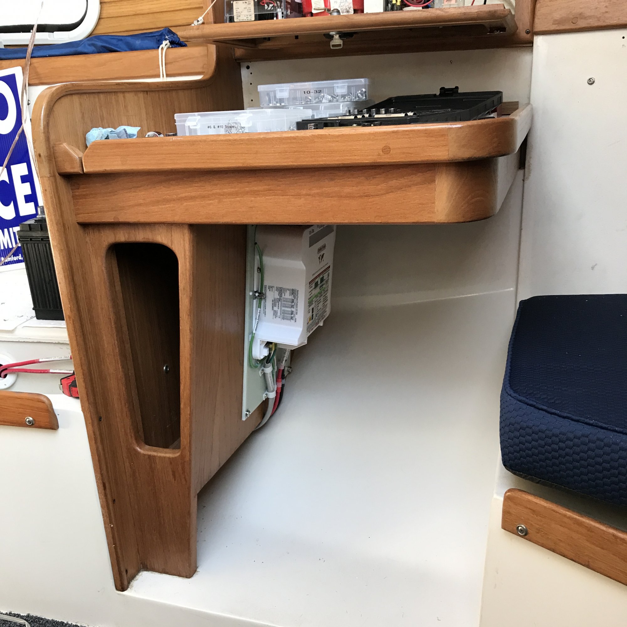

Same location here, The original was under the quarter berth next to the water heater
