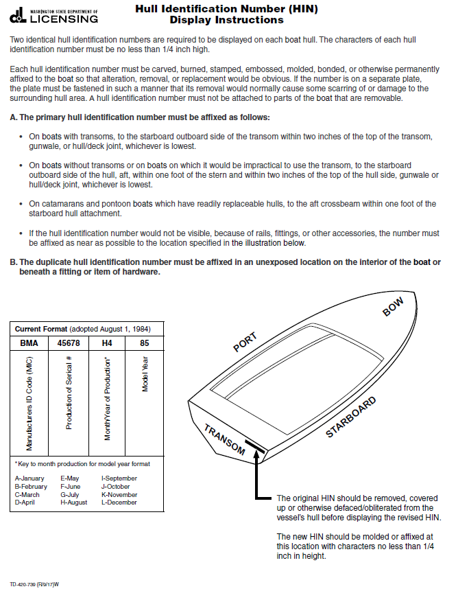

I've been restoring a 323 which was storm damaged in Texas. I had the hull completely restored and repainted,
The normal location would be on after stern, starboard side. Usually near the toe rail.
Is it possible the restorer patched over the HIN (though they shouldn't have, for a variety of reasons).
Below are
  • An excerpt from the general Beneteau "manual"; and,
  • A general location diagram requirement which is (inter) national. (This one from Washington State).

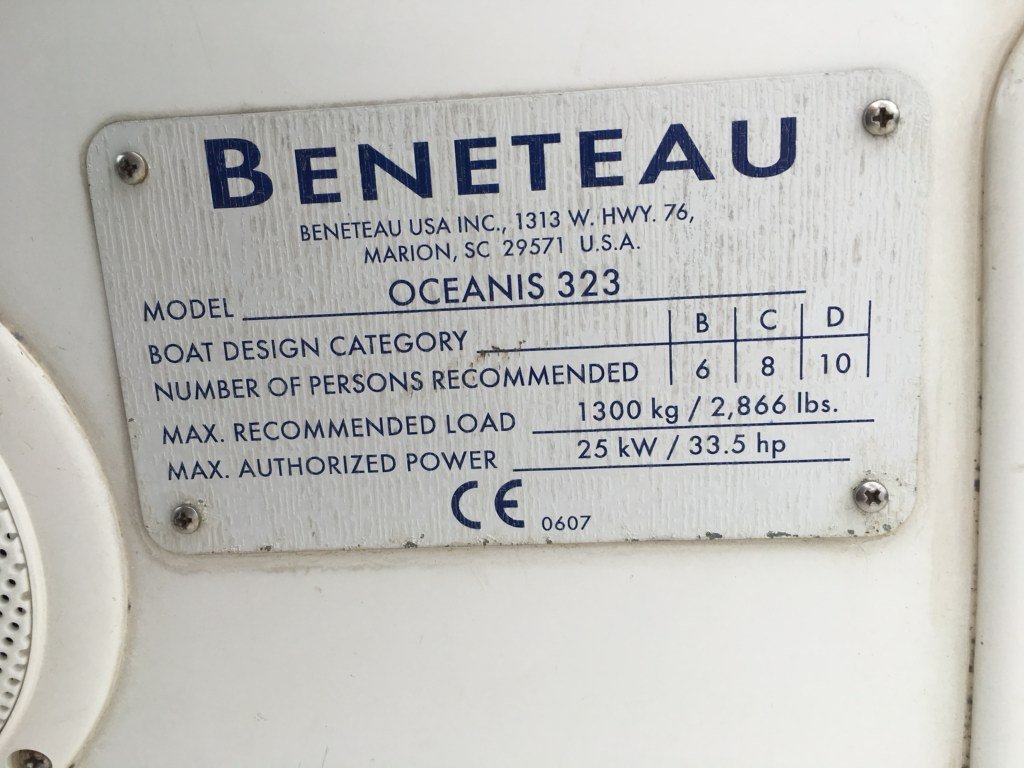

Oh no. He must have painted over it. This isn't good.
The only plate on the boat is this one.

I think I'd rather have it embossed the way it was before.
Good idea. You may find the number somewhere in the boat as SG indicated in the Beneteau manual.
If your boat is to be Coast Guard documented (not sure is possible if it has a salvage title) then you have to fix the document number to the hull in a permanent fashion. You can have that done in a variety of way, most often used is a carved/embossed number on a board, that is glued/glassed onto the hull interior somewhere it can be viewed for inspection (often in a lazarett or engine space).
If you stick with just a state title then the HIN is used for records identification and state registration numbers are often on the boats bow with stickon letter/numbers and the yearly permit.

My second HIN imprint is on a grid stringer just forward of the engine bilge in the saloon area. Keep looking you will find it. Beneteau does NOT place the HIN on the removable rating placard.
24,760
Very true @Gunni . None of the manufacturers do. The HIN is like a VIN for your car. It is supposed to be a permanent boat tattoo, so that the boat can be identified and so the owner can be found.
