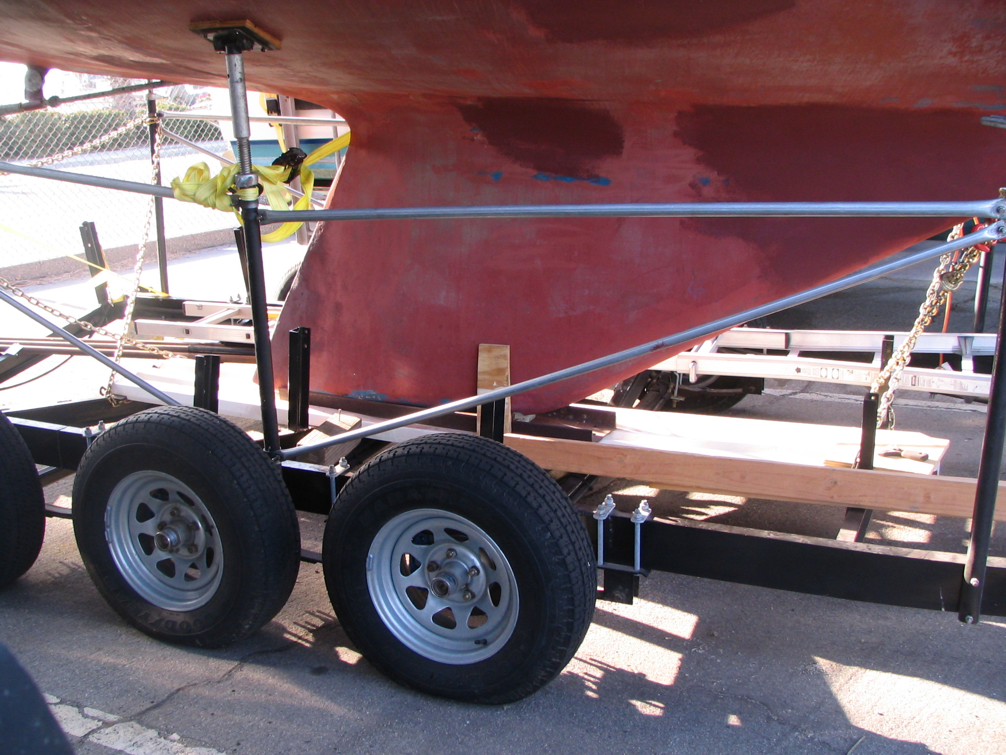

I have a three axle trailer and I am concerned only with CG of the C30 for and aft so I can place the boat CG slightly forward of the center axle to control the tongue weight of the trailer on my trailer hitch. Not critical at first, 1,200 to 1,600 lbs should be OK and then adjust from there. Just moving from dry storage to the launching ramp, just across the street and through the parking lot.
From your post "aft of the fin keel"
The jpg image attached shows how the boat is sitting on the trailer now. The piece of plywood standing up is just where I guessed the CG would be , approx 8 to 10 inches aft of the forward bottom edge of the keel. The 4X4 is sitting on the center axle. It seems like the boat is too far forward on the trailer now.

Your position on the trailer should be fine pal. It's a short move & I assume there are no hills to be traversed.
I wouldn't worry, you will be fine.
What I did like, was your questioning beforehand, just to be sure.

Like Cap'n Ron said, with such a short move you won't experience an ill effects even if the CG were too far back. Wobble typically manifests above 45 mph when the tongue load is too light.
Judging from your picture, even though I can't see the whole rig, you have it as far forward as it can go and that is great... you seem to have the ideal position even if you were going to trailer at highway speed. Also judging from what I can see in the pic, you did a really great job setting up the rig with safety in mid; well done.
