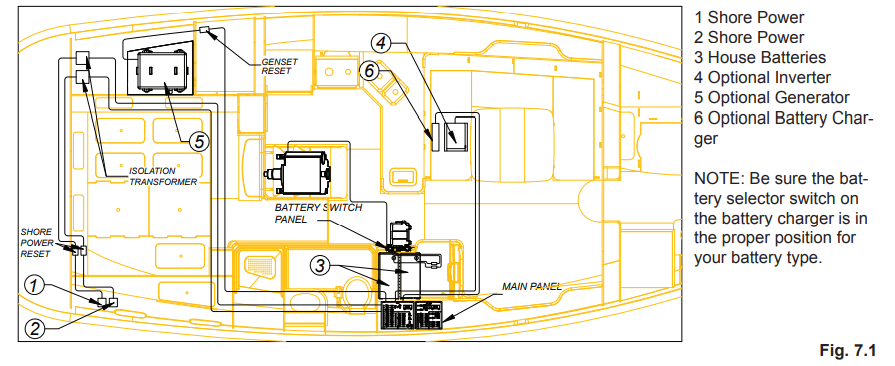

Is this 41DS layout diagram showing the battery charger location consistent with your layout?

The Xantrex I/Cs had the echo charger built right into it. You can get the manual for it on the Xantrex website under discontinued products.
