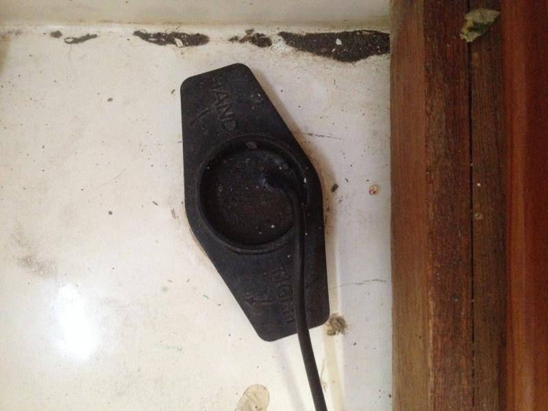

Ok, I think I have located transducer in head on starboard side in sump. It says " hand tighten" and is a black plastic fixture with a wire running into it. So is the glass cover you can see on the underside of the hull a permanent fixture, and this part unscrewable, or do I need to get the boat out of the water to remove this to service? Picture attached
Ian, unlike speed transducers, though-hull depth sounder transducers are generally permanent fixtures and you need to get the boat out of the water to remove them. Picture of yours makes me think that's the case. Good luck

Ian
That is the same as mine on the H31. Recently had to replace wood backing plate and had to pull the boat. I believe Claude is correct in that unlike the speedo there is no temp plug to put in its place. Suggest contacting Data Marine from my earlier post here and they can advise the best way to handle replacement.

Thanks guys. Will follow your advice on this one. Very wary of holes in hulls!!
