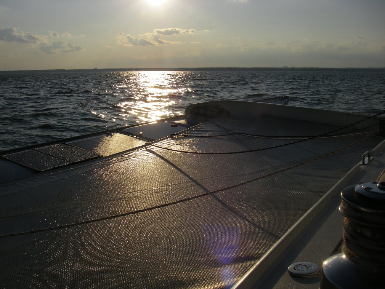

I keep it inverted on the nets, with the kicker mounted on the stern rail. I downsized to a 2.5hp Suzuki a few years ago so the 30 pound engine on a harness is a one-hand lift. My wife and I hoist the dinghy from its using the spinnaker halyard to launch and retrieve. All together the launch or retrieve takes 5-10 minutes,
If I were to go offshore beyond range of a reliable forecast I'd deflate the dinghy and tie it down aft of the mast.

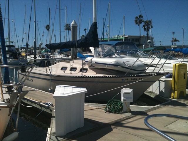

Over the 26 yr since I acquired my first cruising yacht for which I carried a dink and outboard engine, I’ve tried everything except davits. I have towed and have lost one inflatable, air floor dink (Achilles 10.5 ft) altogether in Santa Ana winds of > 25 kt, plus I have had to turn around three times I remember to retrieve ones that had gotten loose. However, most of the time the dink has been deflated and stowed in a locker. The outboard has usually been fixed to the stern rail, but if making an anticipated rough passage, the outboard got stowed in the locker as well. The Bavaria has space for that. Now, however, I have an inflatable aluminum rib of 9.5 ft, and it cannot be stowed below.
The rib does not track well when towed by single warp. Thus, towing requires a warp to each stern cleat. However, I usually carry it inflated and inverted on the foredeck. The transom abuts the mast step where I cross short lines, securing it to the mast step. This keeps it from sliding athwarts when the boat heels. At the bow I strap the the nose to pad eyes with a ratchet-type belt strap. I then secure the painter more forward, sometimes using a Trucker’s hitch. This keeps the dink from sliding aft or raising up much if struck by boarding seas. The rib is usually inflated in this configuration. But, if going into large seas that might repeatedly break or wash over the bow, it is deflated. So, it’s just the aluminum hull that would be presenting much resistance to seas. Plus, there would be no buoyancy there to help a sea lift the dink out of its stappings, etc.

Brian, what are dimensions of that dinghy?
It is a Mercury RU240.

Oct 26, 2008
6,432
Catalina 320 Barnegat, NJ
Thanks! that is a good visual on how it fits a 27' boat. I was wondering about the size I might like to get for Sue and I for this summer. We're done with the inflatable kayak for trips ashore!
