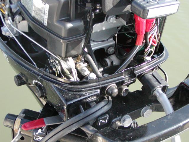

Here is the battery connection on my 4-Cycle engine Mercury 9.9 2006.
I purchased a plug from a trailer supply shop that allows me to disconnected the cable near the engine so that I do not have to unscrew anything when removing the engine. They are commonly used on gulf carts to charge the batteries.
