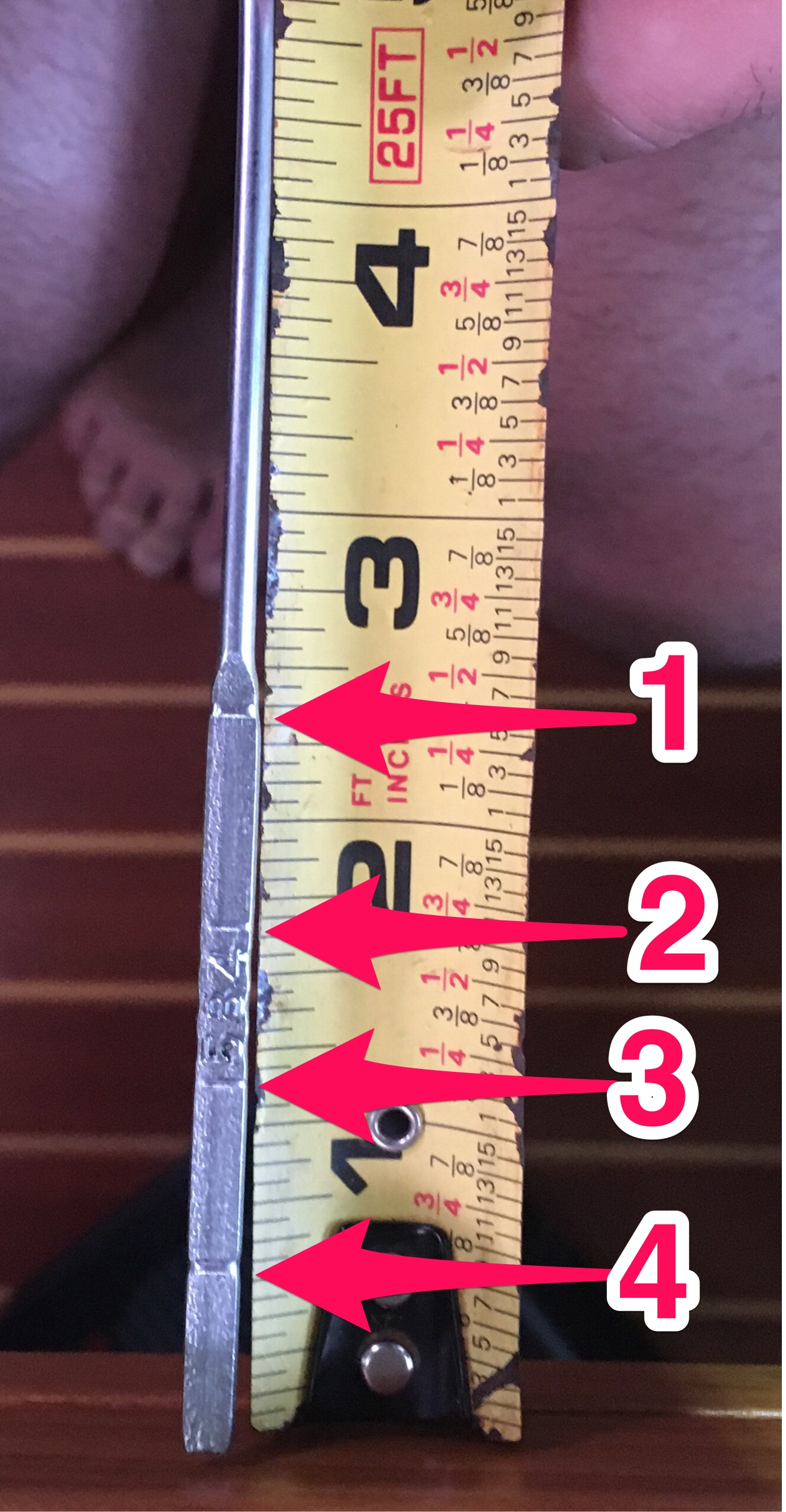

I can't find the answer to this very basic question. Where do I want to keep my oil level at? A photo of my dipstick is enclosed. It looks to me like the mark at the base of the stick (4) and the mark at the top of the flattened part (1) are the high/low marks. But there are also marks (2&3) around the number 584 which is in the middle of the flattened part of the dipstick.
Engine is a Universal M3-20.
What is the significance of 584?

The dipstick is not a precision gauge. Along the middle by the 584 should be fine. Keep it above the minimum line and below the top line.

My take would be that the 15841 is a part number- the "1"s are a bit smaller than the actual marks - your 1 and 4 which I would take to be the max and min marks. ie don't fill over mark 1 and when the oil level reaches 4 you must add.
It's pretty clear that these marks are not the same size or shape as the low and high marks.
Pump it out, then record what it takes to put you at the 2/3 level or there about. As has been mentioned it's not an exact science. Some of the old oil is always going to remain in the engine, and depending on how much in up in the galleries, you will never use the same amount.

Yep, 15841 is part of the part number. 1 and 4 are your min. and max. Like the others said, it's not exact. I have an M50 with factory dipstick. Engine sits at an angle (10 or so degrees???), bell housing end lower than end with dipstick. It's been like that for 30 years. Recently took engine out for cleaning and when it was sitting level, dip stick showed over the max. line. I drained about 1 quart from the engine to bring it down to the "full" mark. I then simulated the angle it sits in the boat and the oil level was right-close to the min. mark on the stick. So, in reality, if you engine is sitting at an angle, reading full, the level might be way-full or way-low, depending if your stick is on the high end or the low end.
