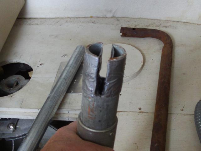

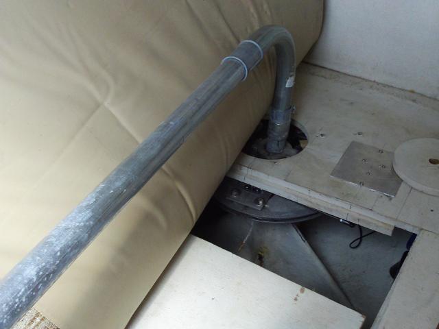

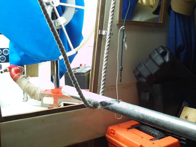

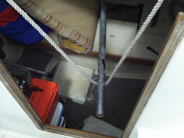

make one....I used electric metallic tubing (EMT is the trade name)and made a slot in the end to fit inside the rudder quadrent.....the one I found on my 32 looked like a auto tail pipe but it was not practical unless you had two people aboard cause my rudder is under the mattress in the aft cabin,I modified the system so I could steer the boat from the helm if needed
you can see the old rusty pipe in one of the pics and the rope keeps the pipe level so I could steer with my foot

I'm an electrician too....and if you look you'll see I used a rigid nipple cause the od fit much better in the quadrant.
