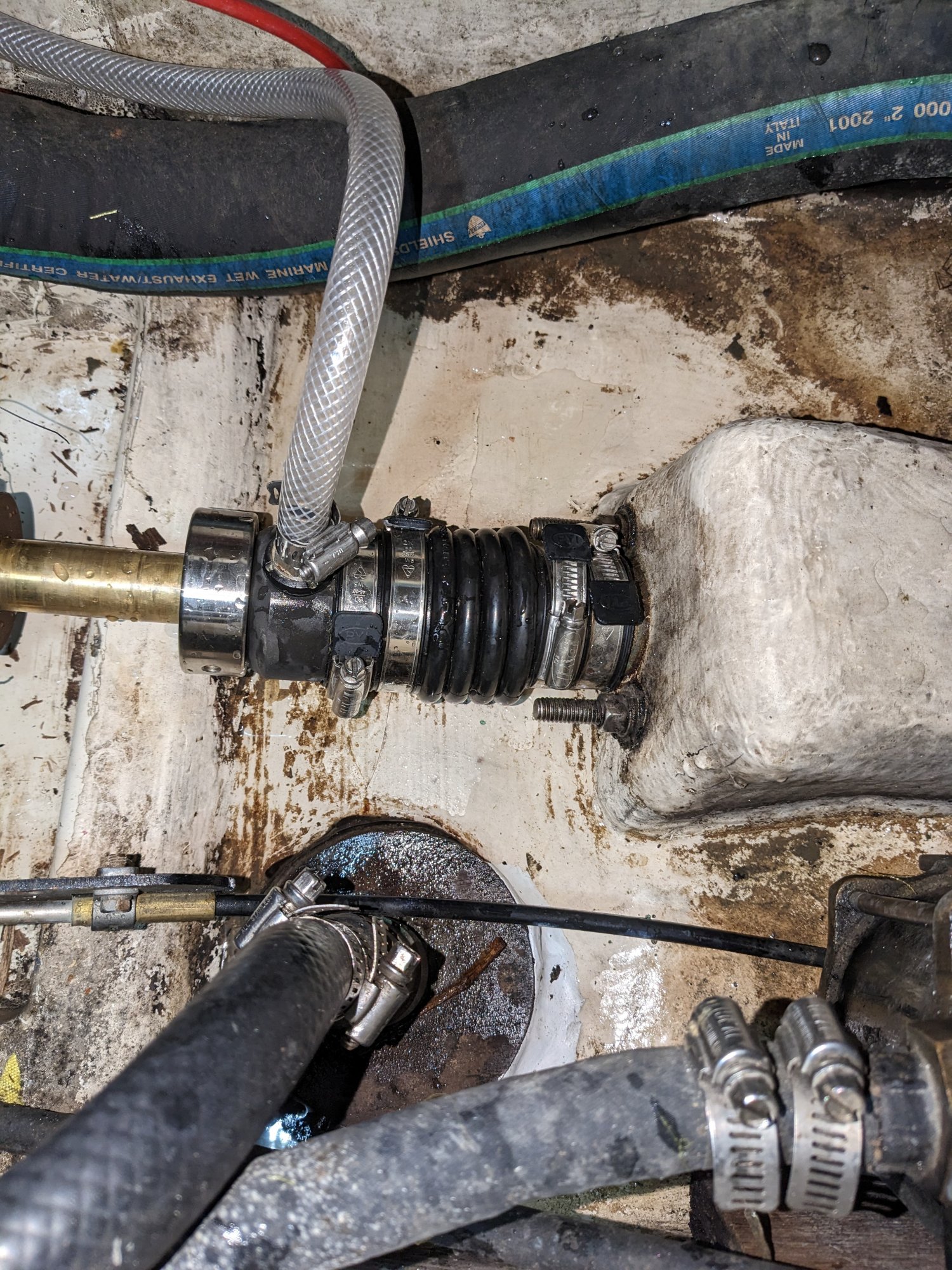

Turns out the water is coming through the shaft seal. I tightened the clamps and the flow reduced but didn't stop. The boat has a dripless shaft seal. Is it normal for them to leak a bit?
What type of shaft seal?
For clarity, as it’s name implies, it drips less, not no drip. Regardless, it shouldn’t drip while at rest. Don’t over-tighten the drip less flax seals.

It looks like a PSS Dripless Shaft Seal. My understanding is that it shouldn't drip at all. And they don't exactly drip - it's more a slow seepage. When I tightened the clamps, the seepage slowed, but I was afraid that if I tightening them too much. Is there any danger if I tighten them as much as possible? Here's what it looks like.
