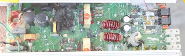

Two weeks ago I talked about how my motor whats to drink sea water instead of gasoline. Well, I never got that fixed in my short time here. Now, I find that my batteries are deader than a door nail. So, I go to Walmart and get a small 12-Volt battery just to ensure the bilge pump works, if nothing else in the boat. Now I find out my charger, a Xantrex TC20+ is even more dead than the batteries. But I need a charger to keep the battery going for the next 6 months.
I was thinking of trying to repair the Xantrex but do not have a schematic. So I ask the general forum, anyone been in one of these units? I understand there is an internal fuse that might be issue. Does anyone know if this is true? I am sure it is. The unit does not even power on and I do have 117vac at the input.

Don't have the schematic but there is an internal fuse. As someone else posted on another forum, "Contrary to the ‘Do not open no user serviceable parts’ inside (or words to that effect), your ‘customer service’ rep informed me of the existence of an 8 Amp AC fuse (inside), and that I could check this fuse. Well, I found the AC fuse (AND 3 DC output fuses - not previously mentioned)"

The Xantrek is toast. See the image. First is the huge burn spot on the left side. And over on the right side just to the left of the two black monitor connectors has some corrosion going on. Not sure what that is all about.
Anyway, this is not Xantrek's problem, this was probably due to my neglect. So not picking on Xantrek, they make good products and I for one have had zero issues until last year and my major brain implosion.
