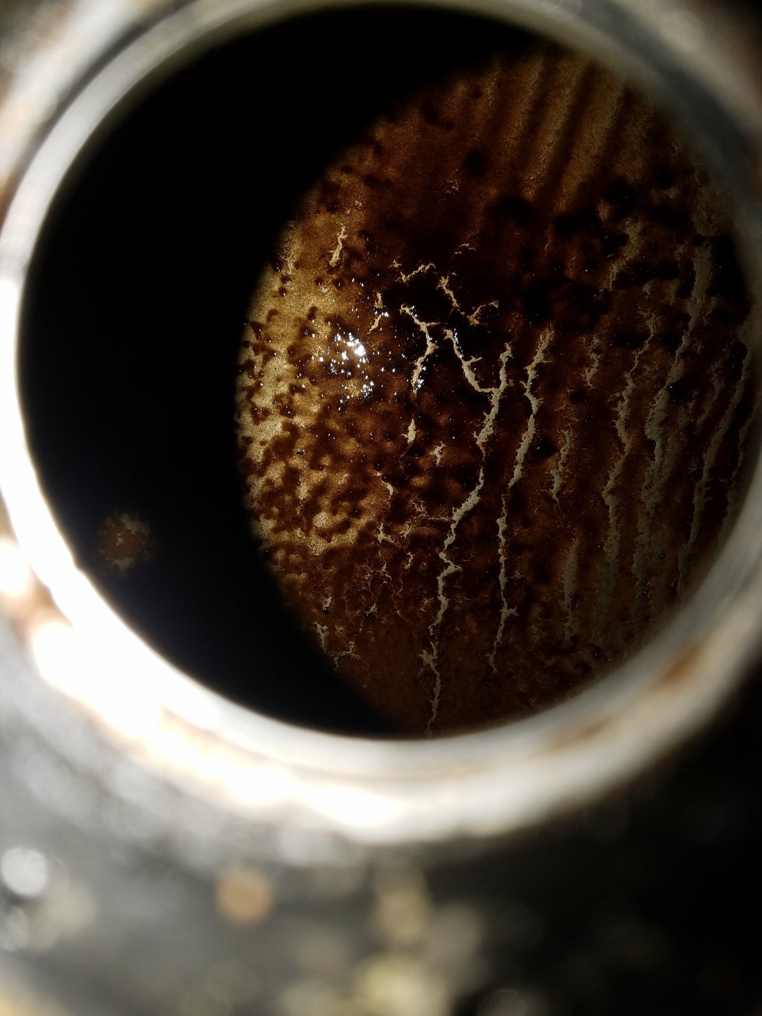

To add a more educated response;) The previous owner of my boat had always left the tank full, and "treated" it with additives each winter. When I looked inside the tank it was ugly. I replaced the tank and used this method. When I pump it "dry" I get it as low as possible. There is maybe a few ounces of fuel left in the lowest part of the tank that I can't get out but it is a nominal amount. In the spring when I check (and feel the top and sides of the tank) there is no moisture and there is the same amount of "liquid" at the bottom of the tank and it has not changed color or developed growth. I've attached a picture of the old tank that used the "keep it full method"

Pretty sure Dow is right. However, since you disagree, please explain the results of your experiments concerning water accumulation in empty tanks. Can you tell us what happened? If there was any bacteria/fungus accumulation in empty tanks as you contend then are you willing to tell us which of these organisms multiplied in the contaminated water (condensation) that occurred in the empty tank?
Looking forward to your results - most particularly those results that conflict with the Dow study. Moreover tell us how your experience yielded different results than those MainSail conducted.

Aww man, I was all prepared to have some snarky remarks and everything;):biggrin:. Honestly though I am not a scientist and I didn't sleep in a holiday inn express last night but my understanding of it is, fuel absorbs/attracts moisture therefor if there is no fuel there is nothing to attract the moisture to it. (yes I know this is over simplified) Part of my reasoning for also doing this is that, the previous owner (and other boats I have seen) have always done the "top it off method" and had the same results of nasty tanks. I figured if this method kept producing the same results than why not try something different. What's the definition of insanity again, something about doing the same thing over and over and expecting different results.
