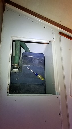

Could not stand the smells or the slosh under the V-berth, knowing what was inches below my face. Ripped out the entire system and have joined the growing herd going to composting toilets. No smell, much simpler head, and I gained a huge storage space where the holding tank was.
This area is big enough that it is now the new home for the rolled up Achilles dingy! (Forward to left)
Before washing out with PineSol and lots of rinse water: (Forward to right)
Bye bye leaky tank. For scale, note the screwdriver in the first photo:

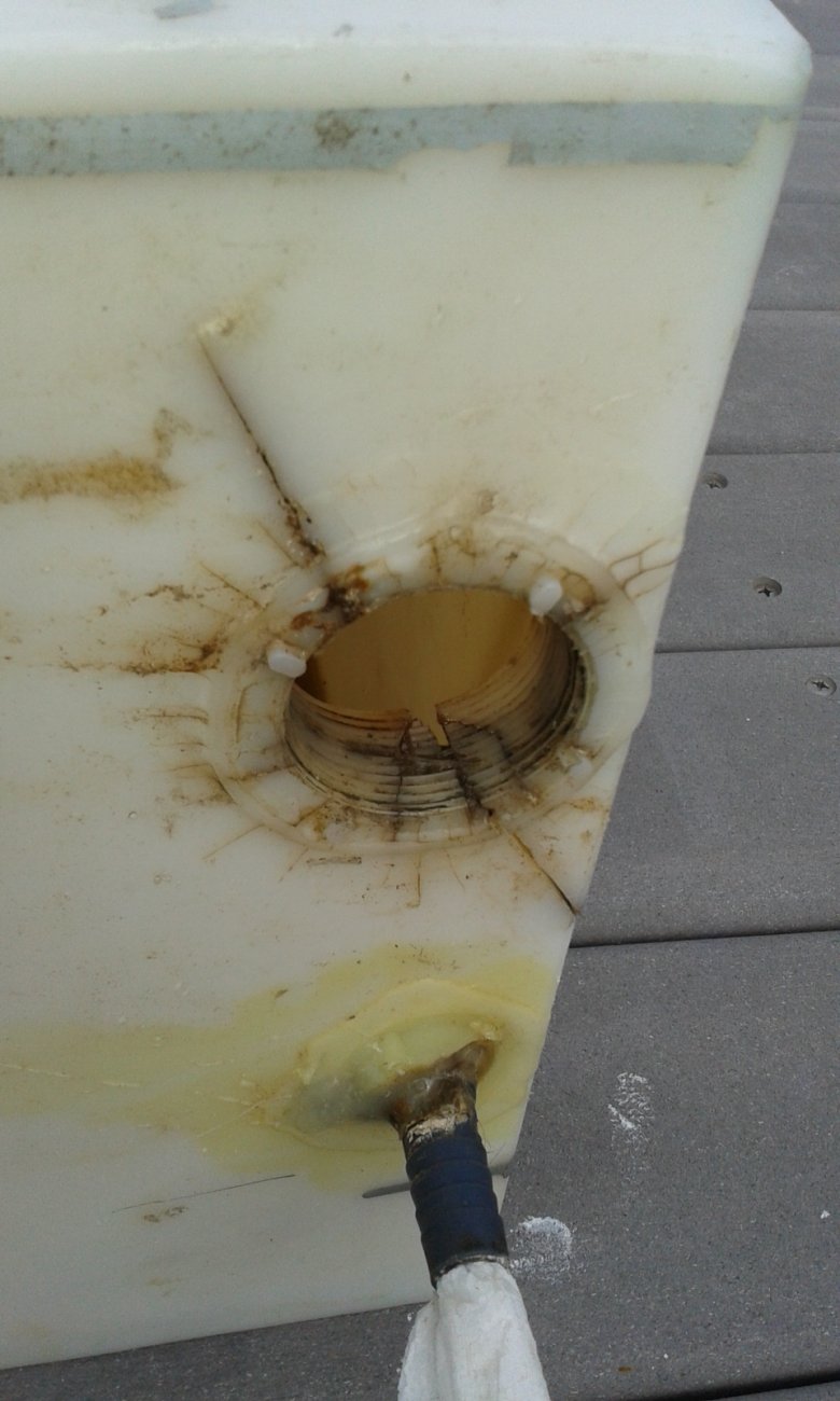

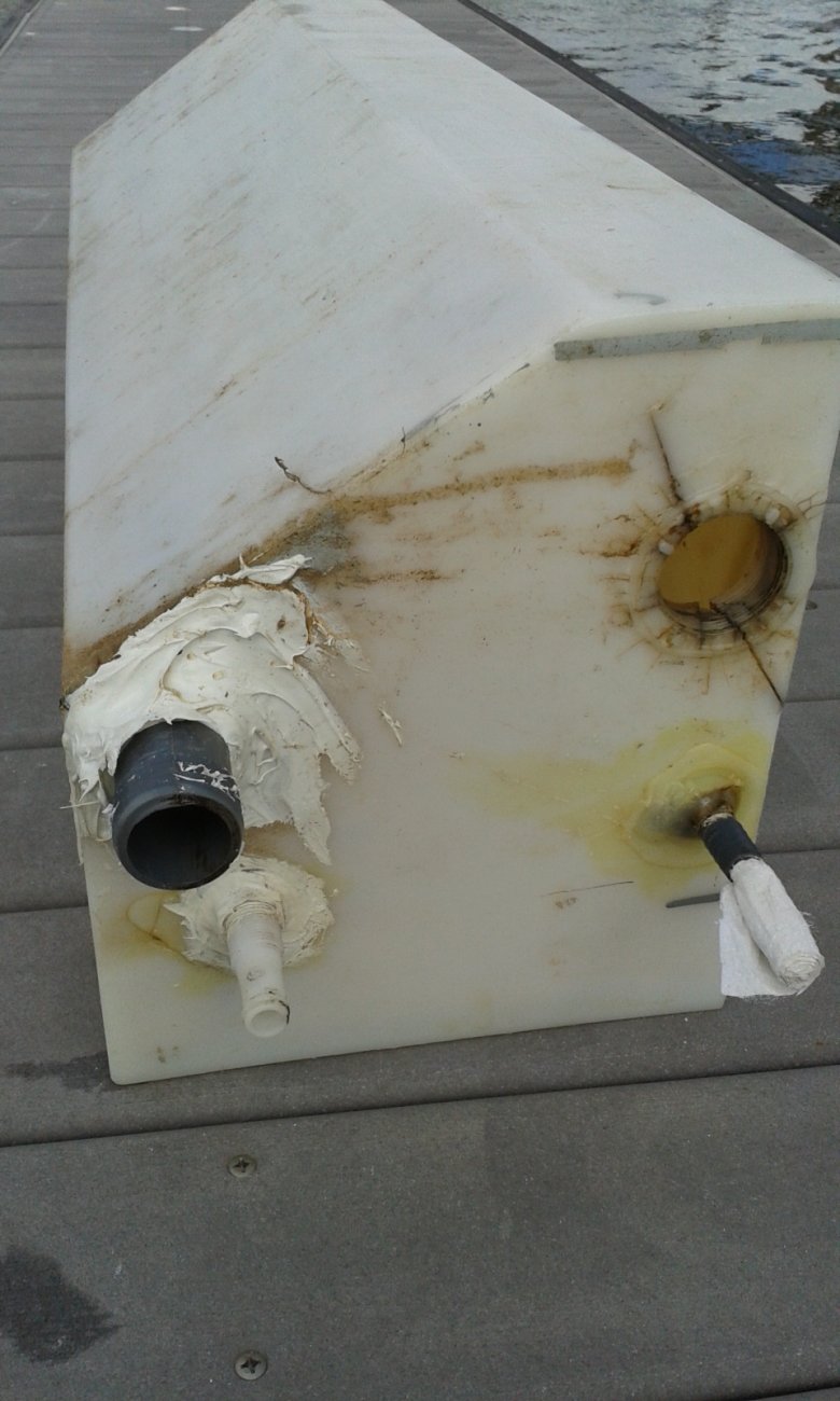

We kept having odor problems on the boat. So I tracked it down to the holding tank.
20140522_102723.jpg The outlet is the black connection and the inlet connection is open. I managed to stop the leak at the bottom fitting but could not really see the top fitting while it was installed in the boat.
20140522_102733.jpg Then one day while I was putting MORE caulking on the leaking bottom connection, the boat moved on a wake and liquid came out of the crack on the top connection and hit me in the face. :puke:I ordered a new tank as soon as I could find a replacement.

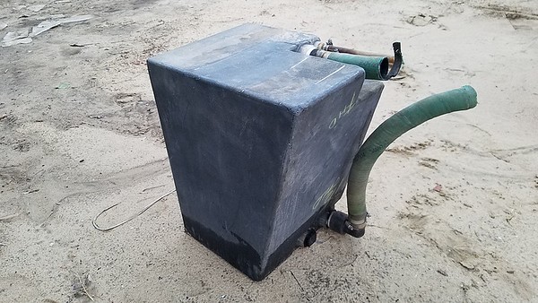

Replaced mine back in 2005 on a 1987 Boat, the goose necks had rotted almost all the way off the aluminum tank. I think the original tank held about 18 Gallons, I used the old tank as a mold and added on to it making it a fiberglass tank at around 25 gallons. Additional I put a sump in it for a low spot so when pumped out everything leaves. I additional I lined it with a Liquid sealer inside it and haven't had any problems with it or odors, 5 years ago I added the Raritan Electric head and that has worked great. I read one of Peggy's articles on it and said I have to have it. The tank in the Bow I believe is fiberglassed into the boat I have never done anything with that one other than change the head.
