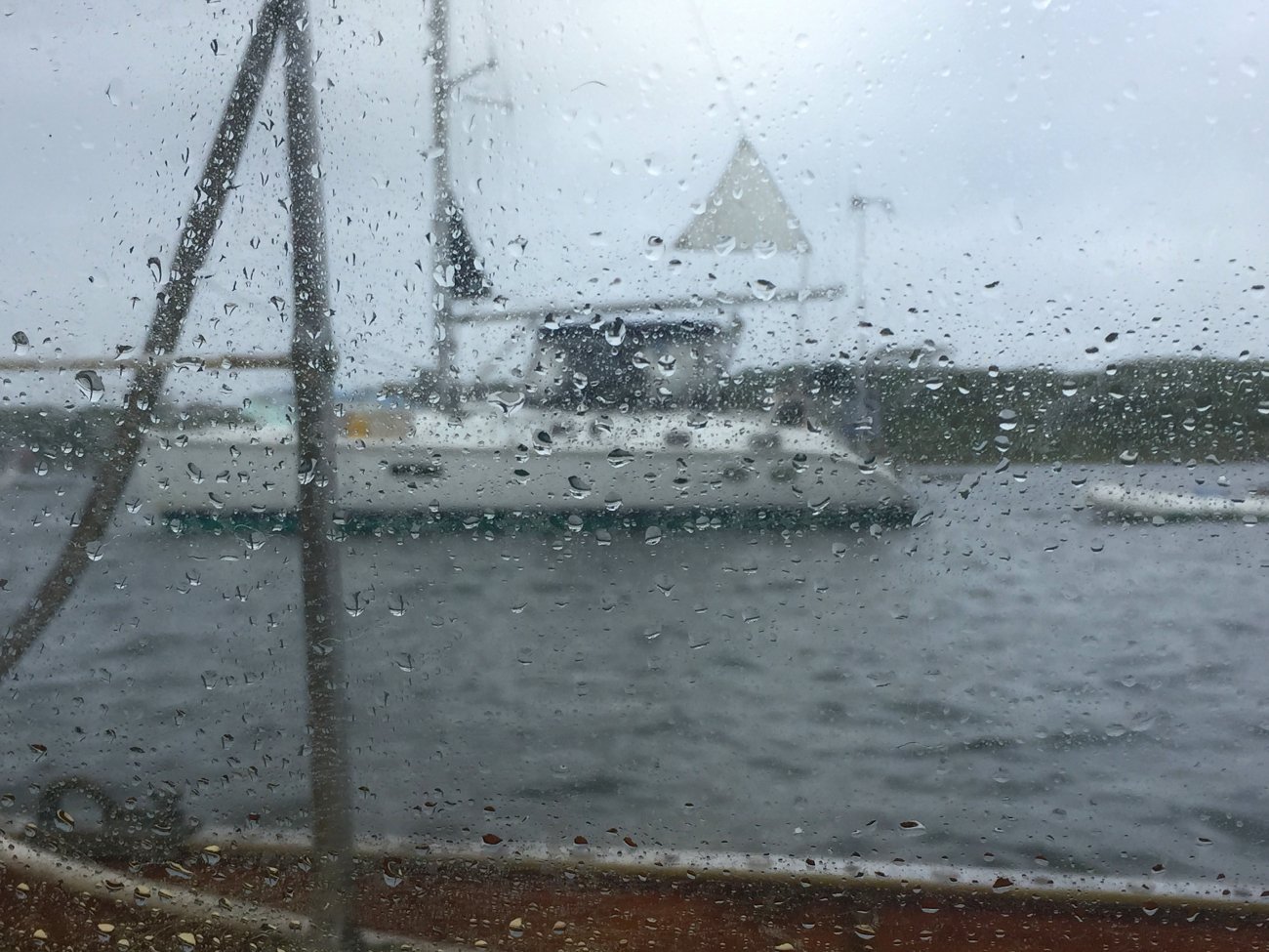

Sailing around an anchor: Anchored in Cuttyhunk this season, the South wind kicked up to around 20-25 knots(and rain!).
No current in anchorage, flat water with no fetch, this boat next to use sailed widely on it's all chain rode, even with a riding sail.
It was curious because of all the windage, aft on this boat. I can only surmise that the high freeboard, house and dodger enclosure, presented the 'sail area' as it swung, to get the 'lift' it needed to get a motion going.
Keel rudder helping it's sailing motion? Tag of mast furled mainsail?
On 40' of chain and the same amount of nylon rode, we nearly had to re anchor as it sailed.
Most boats were sitting still in the anchorage. The anchor sailing of this boat may have been exacerbated by a paddle board or two, on the forward deck.
