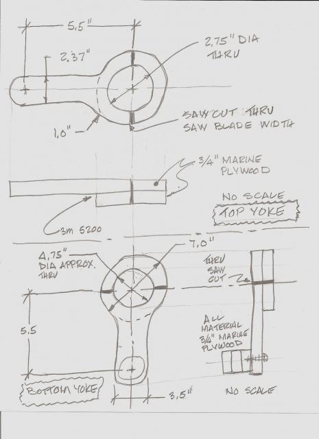

Paul, Did you make any paper templates of your rudder position bracket? If so, could you scan them and post. Mine is pretty ugly, and I would like to scam off your work.

How about if I post some sketches with dimensions?

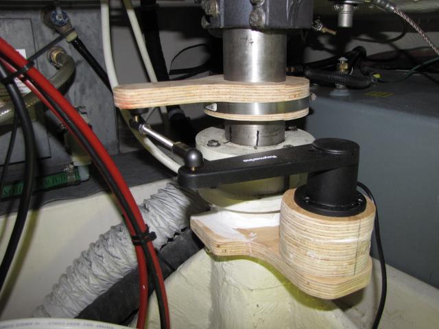

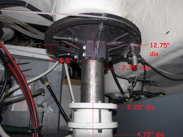

Paul, I have been looking at a lot of options for the RPS and yours is the most elegant I have seen and most suited to my set up. I am assuming that you needed a 21+" metal strap to secure the pieces.

Perhaps, his rig for mounting the RPS worked great!

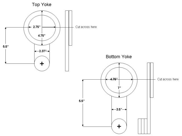

Paul, Thanks for the plans, they worked out fantastic. I still have to do the calibration, but it is all working. BTW, I cleaned up your drawing for posterity. Couldn't have been easier to make and install.
