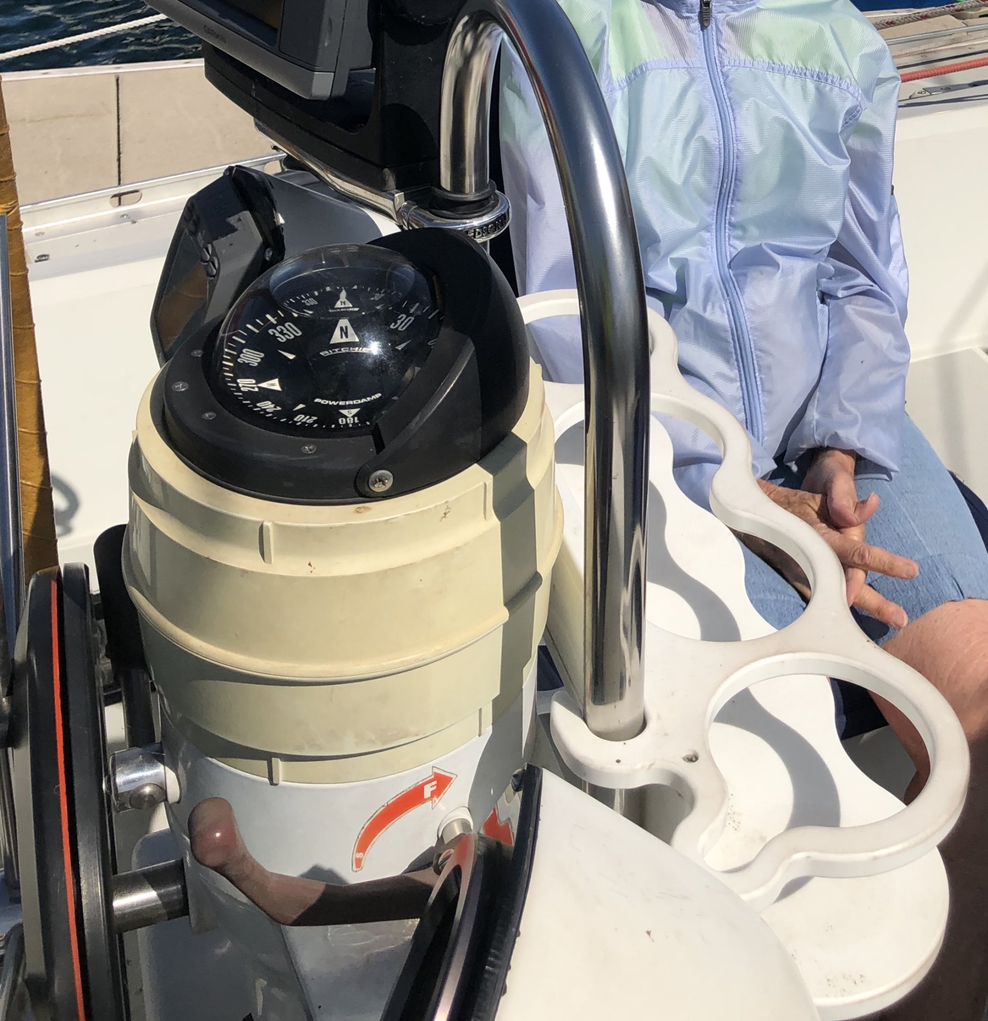

I want to add a wheel drive auto pilot to my ‘82 H30, but I have the Edison pedestal with the shift lever on the aft side. While the end of the lever is to the left of the pedestal rather than directly behind it, I am concerned that when the auto pilot wheel drive is mounted to the steering wheel, it may be an annoying obstruction. Has anyone with this pedestal and shift lever configuration added a wheel drive auto pilot?

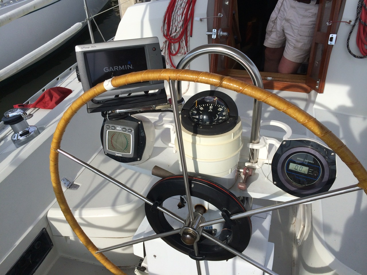

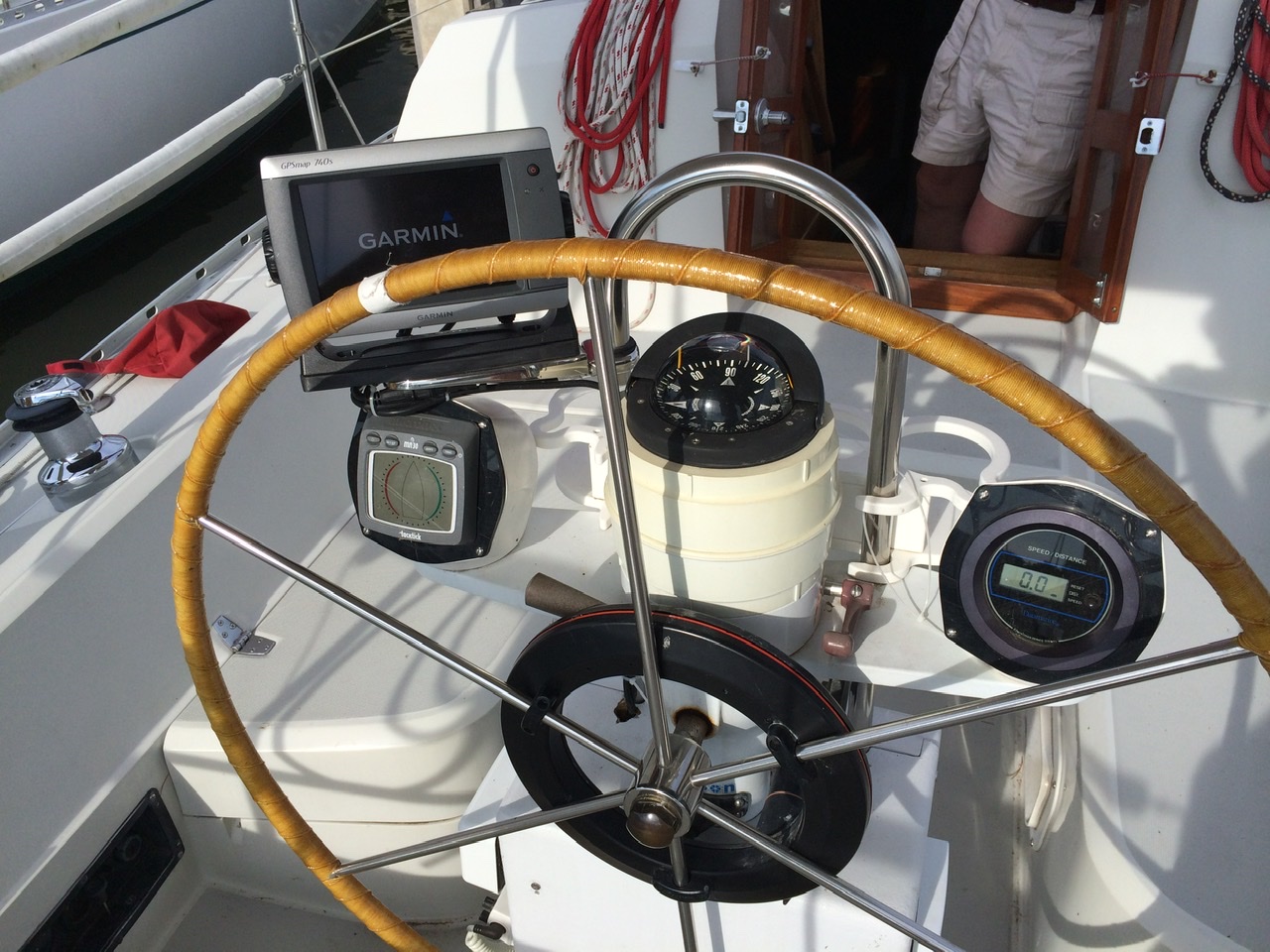

The transmission lever on my O’Day 322 is just like yours.
I have a wheel pilot and it works fine.

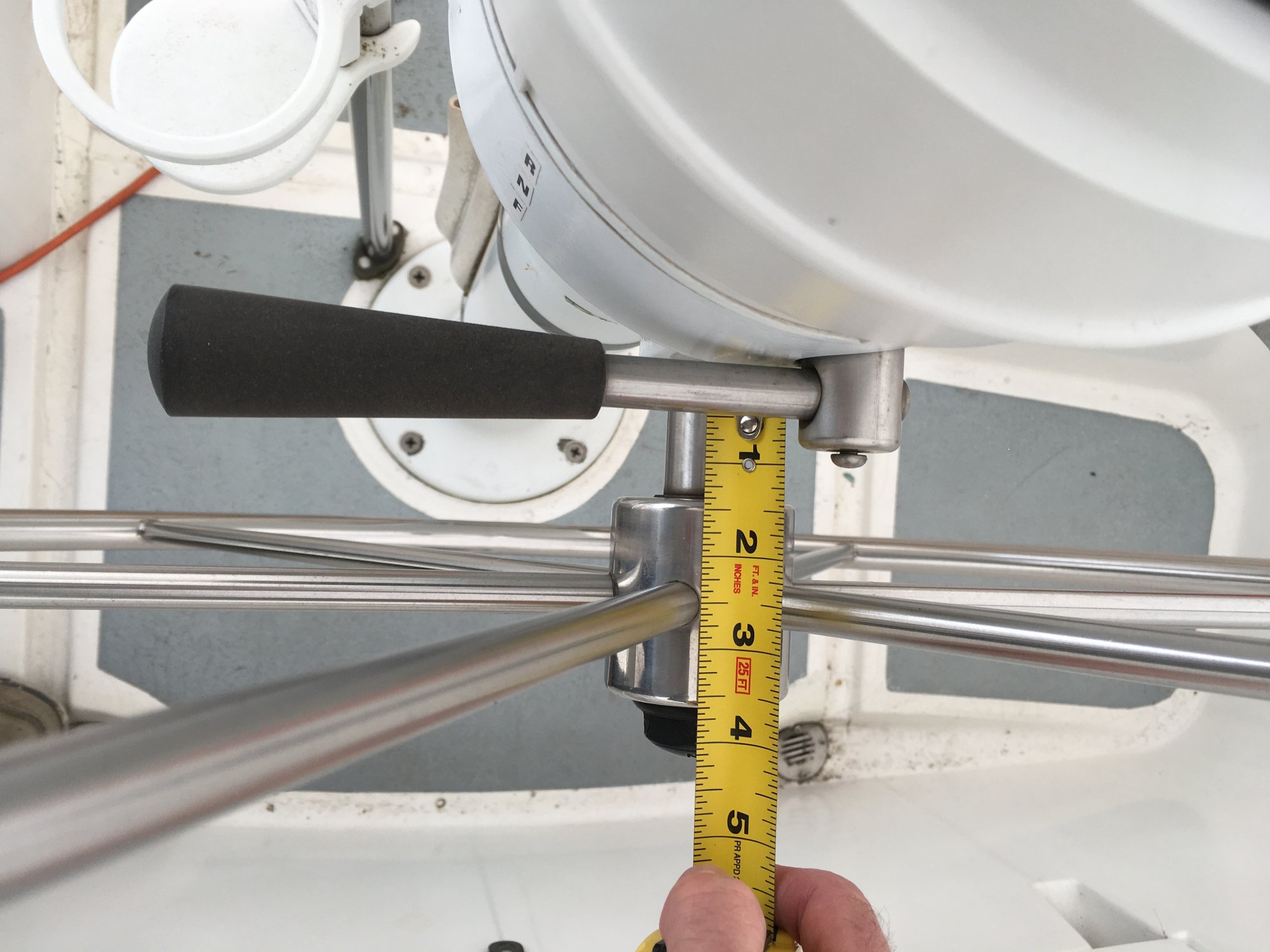

this shot gives you an idea how close the shifter and wheel pilot are...but I don’t have any issue shifting.

Greg,
It’s a tight fit but it works. I was concerned I might need the more expensive below deck drive type. What brand auto pilot do you have and where do you have the control unit mounted? I’m thinking of putting it next to the engine panel or on the port side opposite that rather than on the pedestal.
