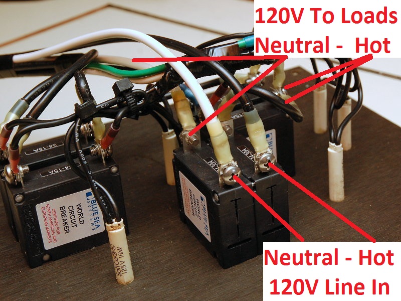

This is what the panel looked like a few hours later. Notice the difference in how it is wired. The top two wires, white and black are the AC input from shore. Out the bottom of the breaker the white leads back to the AC neutral bus and the black feeds the individual branch circuit breakers.
IF your boat is not wired to interrupt both BLACK/HOT and WHITE/NEUTRAL, in a fault, please get this fixed..

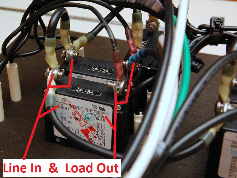

The red wires on the "branch breakers" are on the LINE/IN side not the LOAD/OUT side. The branch breakers are fed the the BLACK/HOT (red in the first pic) wire from the MAIN breaker to their LINE side. The loads and LED indicator light get wired to the LOAD side of the breaker.

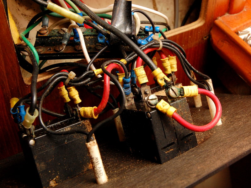

This is on one of my projects, (not mine). Looks like something on a 1940's farm house.
I haven't opened it up yet, I'm not sure when my last tetanus shot was..
(Oh yeah, the fuel tank is just out of frame, right beside this train wreck).

you know if you "gang" those CBs in a row and add a neutral buss it makes for;
a) the use of a hot buss bar to power all the secondaries
b) gives you more room for other secondary CBs
c) makes it a whole lot cleaner looking wiring as you can run all the secondary circuits in bundles and not the spaghetti wiring shown.
Probably the reason ALL house CB panels are arranged that way and most factory boat panels too.
