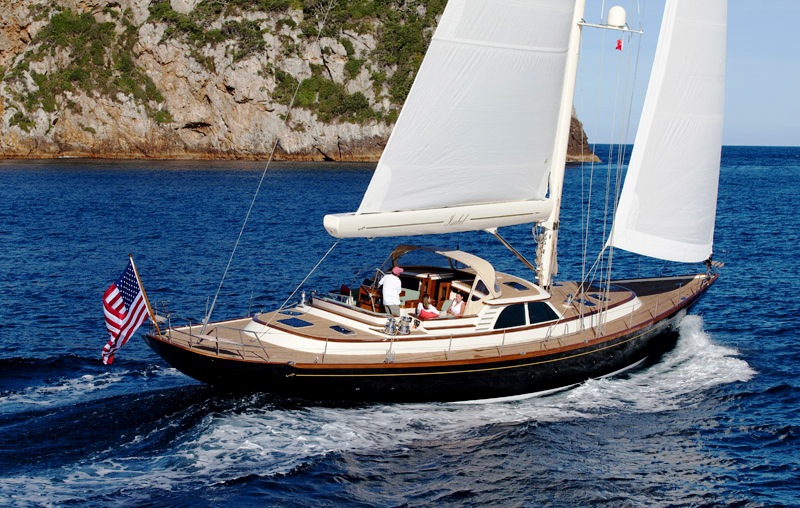

You really have to see the WHOLE jib from tack to head to see if that fairlead is too far forward (my suspicion, as the leech looks a bit 'cupped up'/closed). It certainly isnt on a 10-12° offset line from the jibs tack ... looks like that 'slot' could be 'too narrow'.

Interesting boat. Looks like the world's biggest day sailor. The single mainsheet seems to lead to a hole in the deck. Maybe a line/cable led to an electric winch belowdecks? Same for the jib?

Nothing cheap about that boom. Roller furling. I sailed with the owner of a company out of Bristol, RI that made that and the boarding ladder for his boat. All carbon fiber. The ladder alone cost more that 10 time what my boat cost. Nice to have a well to do admiral!!

Maybe it's just me but..............................
looks like the cars are so far forward his sheets are inside the shrouds.
Can't get the headsail out far enough to compliment the main?

I have studied that and believe it is an optical illusion caused be a jib foot that swings upwards quickly from the furling drum to the leech. It is cut quite high aft if I am seeing it right

Isabel is her name
