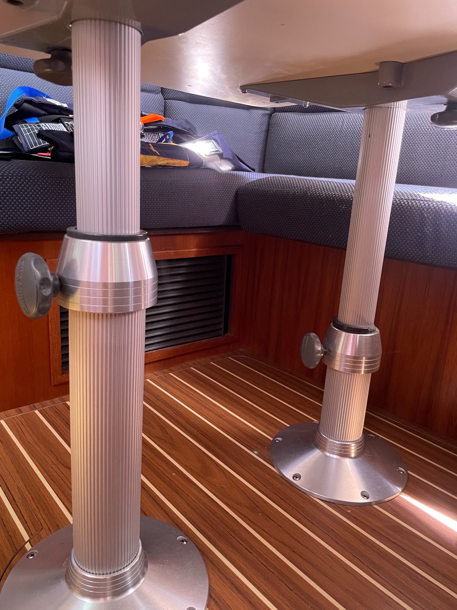

Recently on my new-to-me H38 I tried to lower the saloon table into position to use as a double berth.
Table would not go down. I discovered my legs are of different length. Is this normal? Has something been repaired incorrectly?

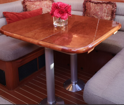

What year do you have? Did not see that on the 2008 Hunter 38 below or my Hunter 386 or Hunter 46. Might require a modification.

Interesting, my 2008 38 came with a second set of shorter legs for lowering the table not the telescoping legs yours shows.

Its a 2007. The table top itself does not fold like the one pictured above, its a single solid piece. According to the manual I should simply be able to lower it into place, but the longer leg prevents that.

Are your legs unequal length? My table only goes down partially, is a few inches shy of being able to use as a berth.

Yes obviously. I had hoped that other H38 owners would say they do or do not have unequal length legs. I'm now convinced that I have one incorrect leg installed.

Or possibly a previous owner started getting out some box wrenches and such trying to figure out how lower the thing down and went a little too far? That is exactly what I did on my Hunter 41DS first time we had to bunk-up people in the main cabin. Luckily noticed the bit how it slides is pneumatically sealed before we went on to the next step, refastened everything and as another gentleman said, had a lady sit on the table and slide right on down.
So yeah, keep in mind both tubes need to be closely aligned for the sliding thing to work and if somebody mucked around with it earlier they may be out of alignment. Both mine are level, and most importantly - parallel.
